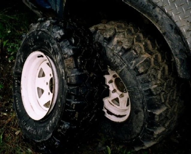

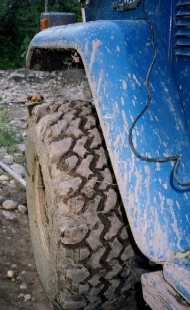

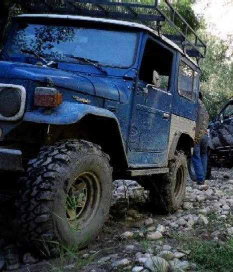

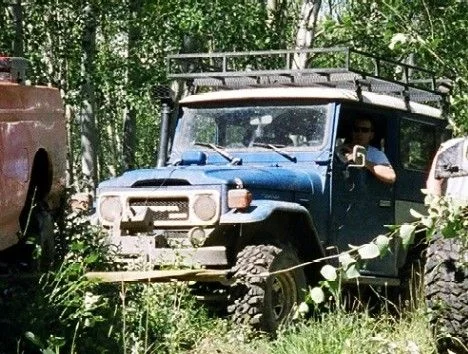

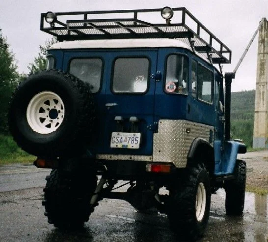

    Hi All,
    A couple people wanted me to post up some pics of my LTB's, so here they are. My impresions so far are:
    They are quite a bit heavier than 35in MTs, thus totally kill the highway hill climbing, and increase fuel consumption.
    Loud on highway, and generally shake a little too.
    Great in Mud! not too much better else where. (except strong side wall)
    They need a 6 or 7 inch rim, because I have never blown a bead, and I on the first trip I already blew one.
    They are a bit smaller that the 35in MTs, and a bit smaller than the 33x12.5 Super Swamper TSLs.
    Overall, I am happy with them so far, as I knew what I was getting into, they are definitly not a commuter tire, but they do look bad ass if you are going for the poser look. :grinpimp:

    how far did you have it aired down on a 8" rim? I think they look good but the larger rim does make it look like a fatter tire. Thanks for the Pics Deny! :)

    I was aired down to 12 psi. I sort of had to go with the 8 in, because that is what I had, and I am pretty top heavy and high, to go any narrower. I should have bucked up to get the 33x12.5 TSLs, but I am too poor right now, and these tires work perfectly for cost, and what I want to use them for.

    Mean looking truck, I like, I like!!!
