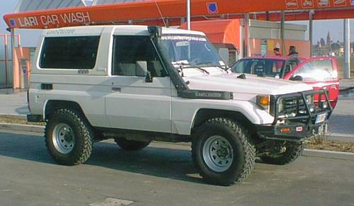

Here are a few pics of 33x10.5 on BJ70 (Jan's is the copper colored one on the right with the 33's)
Cheers,
Michael

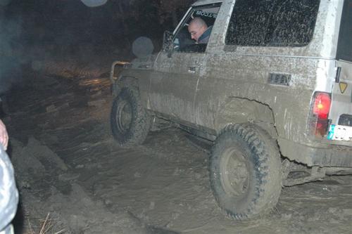

I forgot to tell you about the rims: in the frts picture I have the actual rims (the grey ones) they are 16x7 and I think that for 10 or 10.50 tyre they're the best.
In the second pictures I have the original toyota rims, 5,5" but they are not so good for this measure.
Francesco
