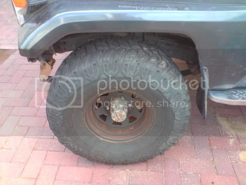

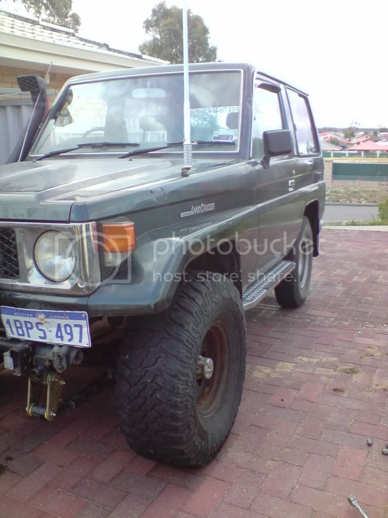

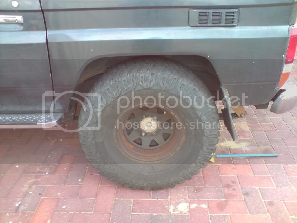

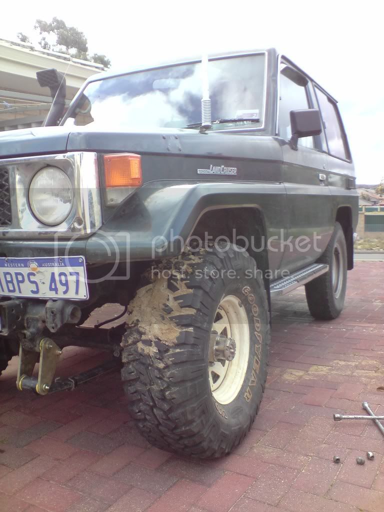

Hello people.
I got to test some 33's and 35's today and needless to say i want to get some 35's. The 33's would be great but i just know i will get bored of them soon and want 35's especiially since they almost fit. The front seems acceptable space wise but i think my rear springs have sagged ALOT and there is barely any space for flex, even if i cut my guards. The problem is i dont want to get new springs front and rear because i dont want too much lift as it will probably lift it 3 or 4inchs over the height it is now, and all the lifts i have seen to date make your shackle angle vertical which will make me lose flex. What is everyones opinions on add-a leafs just in the back to level it out with the front. Resetting springs? Body lift? Or do you think 33's is the more sensible option.
If you cant tell from the photos the rear is about 1inch to 2inchs sagged compared to the front

if you have sag at the rear you have 2 options, add-a-leaf, rearch the leaf pack or add longer shackles..
as for tires go longer shackles front and rear, relocate the front cetering hole ahead 1" and drop the rubber bump stops. your actual upward articulation is hampered very little and your center of gravity is perfect...
hey mate, if you look closely at the pictures again i have already installed extended shackles front and rear. It lifted the front about 1 1/2 2inchs and barely lifted the back half an inch because they are pretty sagged. And i have already moved my diff forward an inch. I think i will look into adding a leaf into the back seems like the best option. And also give chopping my guards a go.

actually those look like typical anti reversal shackels which are very close to stock length.
extended shackles:
to gain 1/2" of lift you need 1" longer shackles
to gain 1 1/2" lift you need 3" longer shackles.
