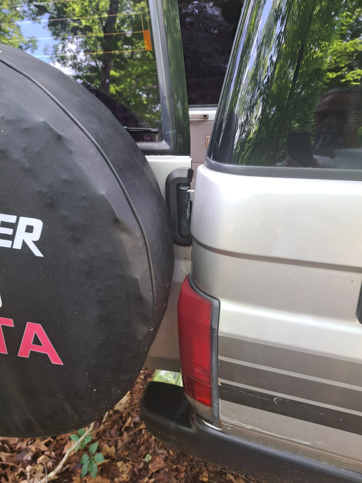

33" tire/stock 16" wheel hits tail light lens

Mark, my LJ77 is running 255/85/16's, so they are 33's and the spare does not touch the tail lights.
Is the troppy that much different?
My door is a little dented so that would bring the tire around a bit but I suspect the area around the tail light, the trailing edge of the rear quarter, is different.
