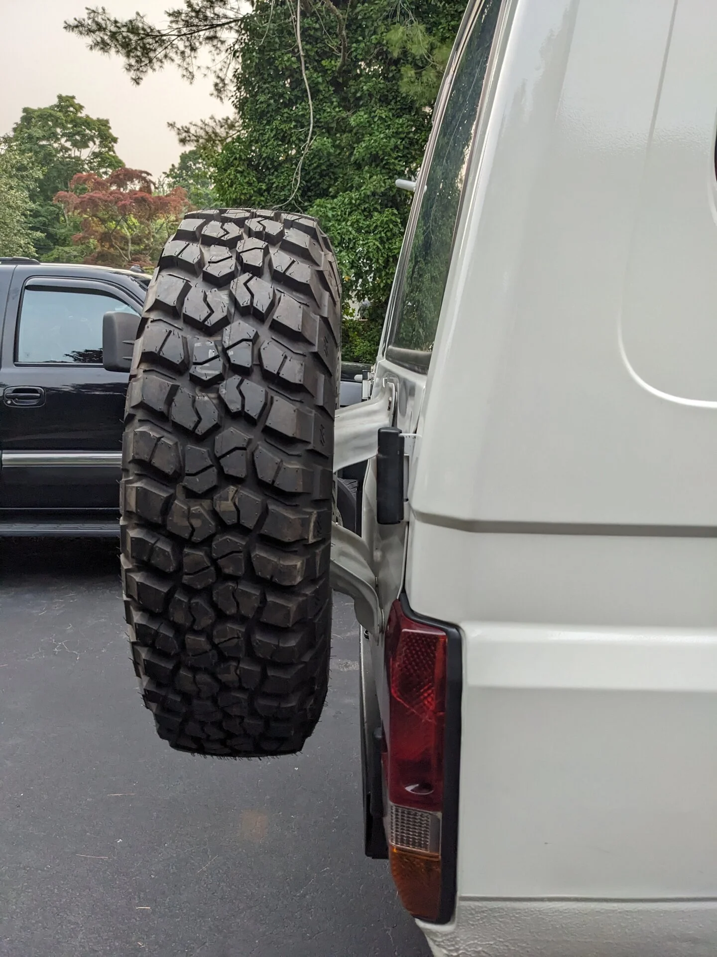

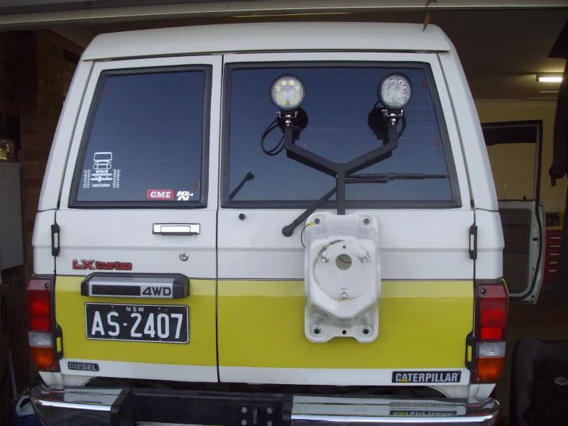

So I have 33" tires on a stock 16" wheels on my Troopy and the spare hits the tail light lens before the door is all the way open. I am thinking of building something to move the stock carrier a little away from the door and a little bit farther to the left (but not so far left as to interfere wit the left door). I saw this picture in very old thread mentioning Feret Offroad in Perth making a "spacer" but I can't find any more info on that/them. Any input on options would be welcome.

The further you push it out away from the body the more stress you are putting on the mount, the door skin, and the hinges. Not to mention the weight of the 33 vs the factory wheel/tire combo. At some point that might start to cause damage. A swing out bumper would alleviate that but they are also not cheap. I am curious what others have to say about adding a spacer.
I would make the spacer as small as possible and move the tire to the left as far as possible but I'm not sure that would alleviate the interference with the tail light lens in any case.

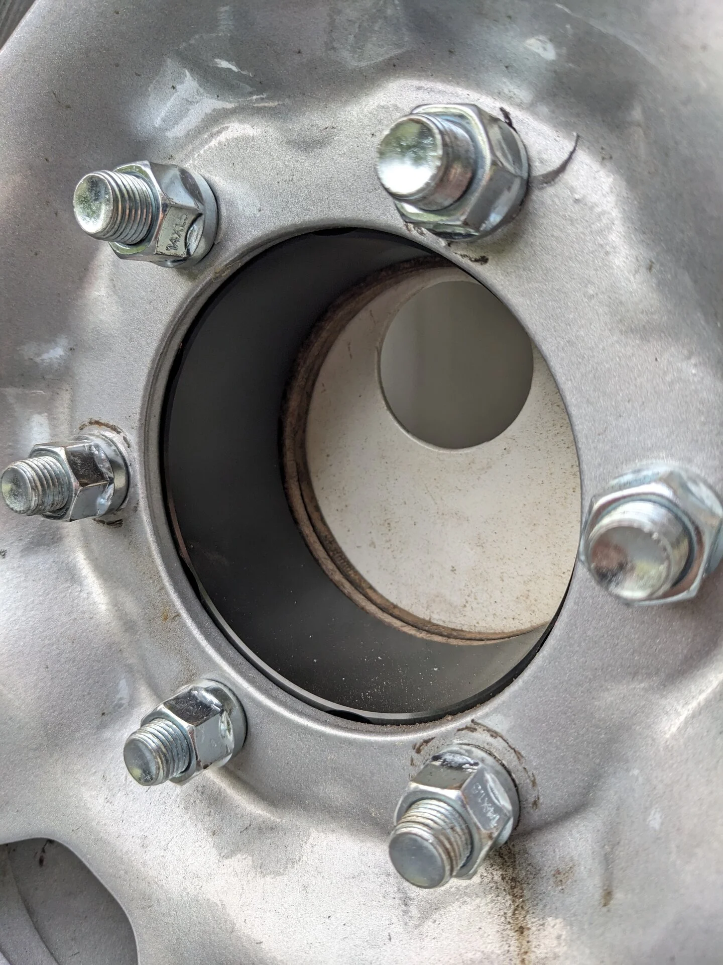

this is exactly what I am currently doing. Works great, and you can find those spacers absolutely everywhere.

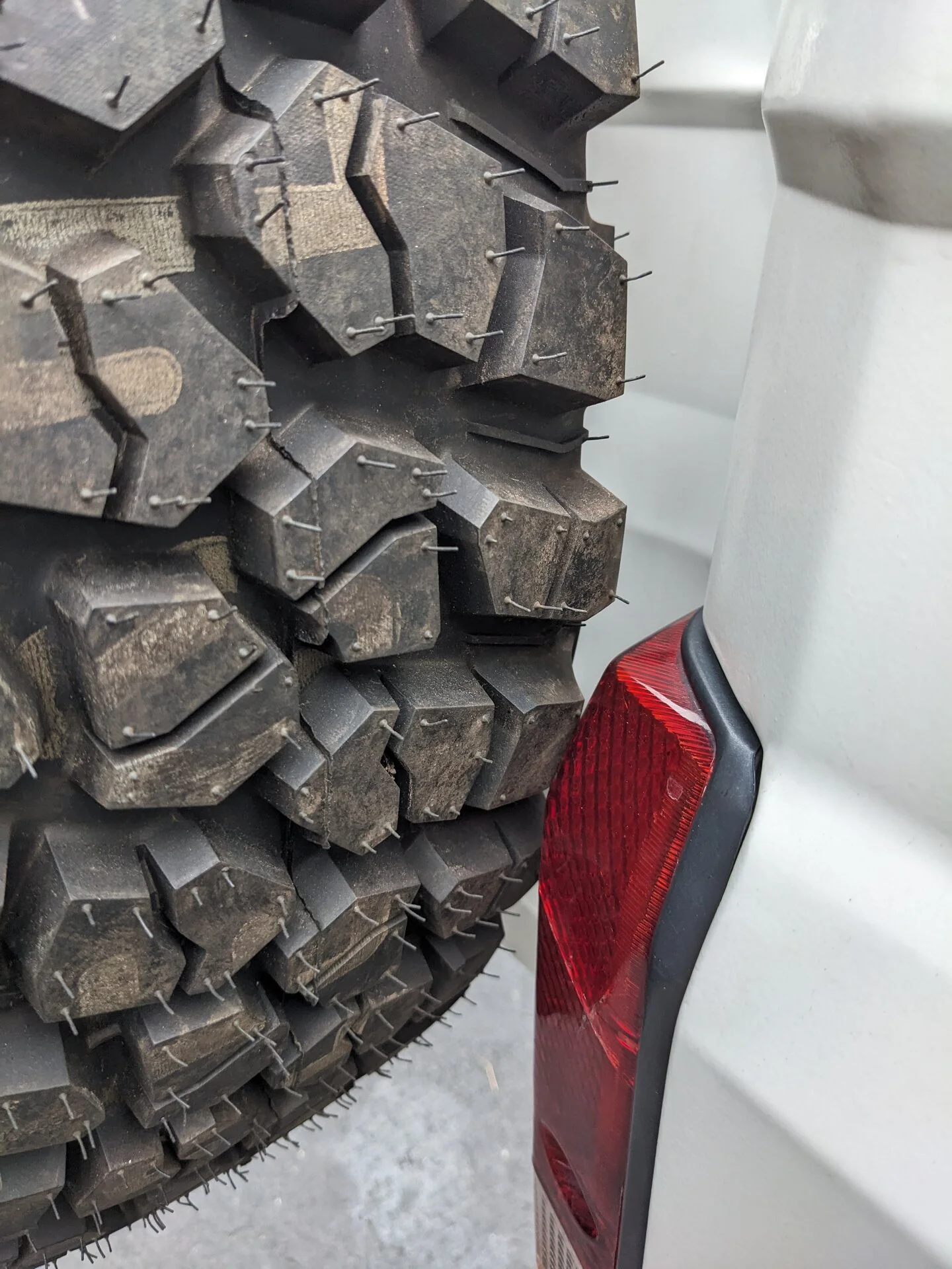

So turns out either it was that my tire is slightly larger and/or the dent in the door from the previous owner that required me to add two of the small slip-on spacers in addition to the 2-in spacer. But with all that it just touches the tail light. I don't love the solution but it will suffice for now.
Wow. That's wild that it STILL touches even with how far that spare tire is spaced outward.
Making me nervous to upgrade to 33's now. I'm curious how the guys running 35's are handling this issue?
These are 255 85 R16 BFG MTs... which are spec'd at 33.1 diameter... probably a little bigger than most "33s" (the 33 12.50 15 is spec'd at 32.5)
That, and the dented in door.....

Contacting the tail light lense might be a better contact option than sheet metal ...
If you get overly energetic opening the door and the tire breaks/cracks the lense, that will be cheaper/easier to deal with compared to a body repair.
