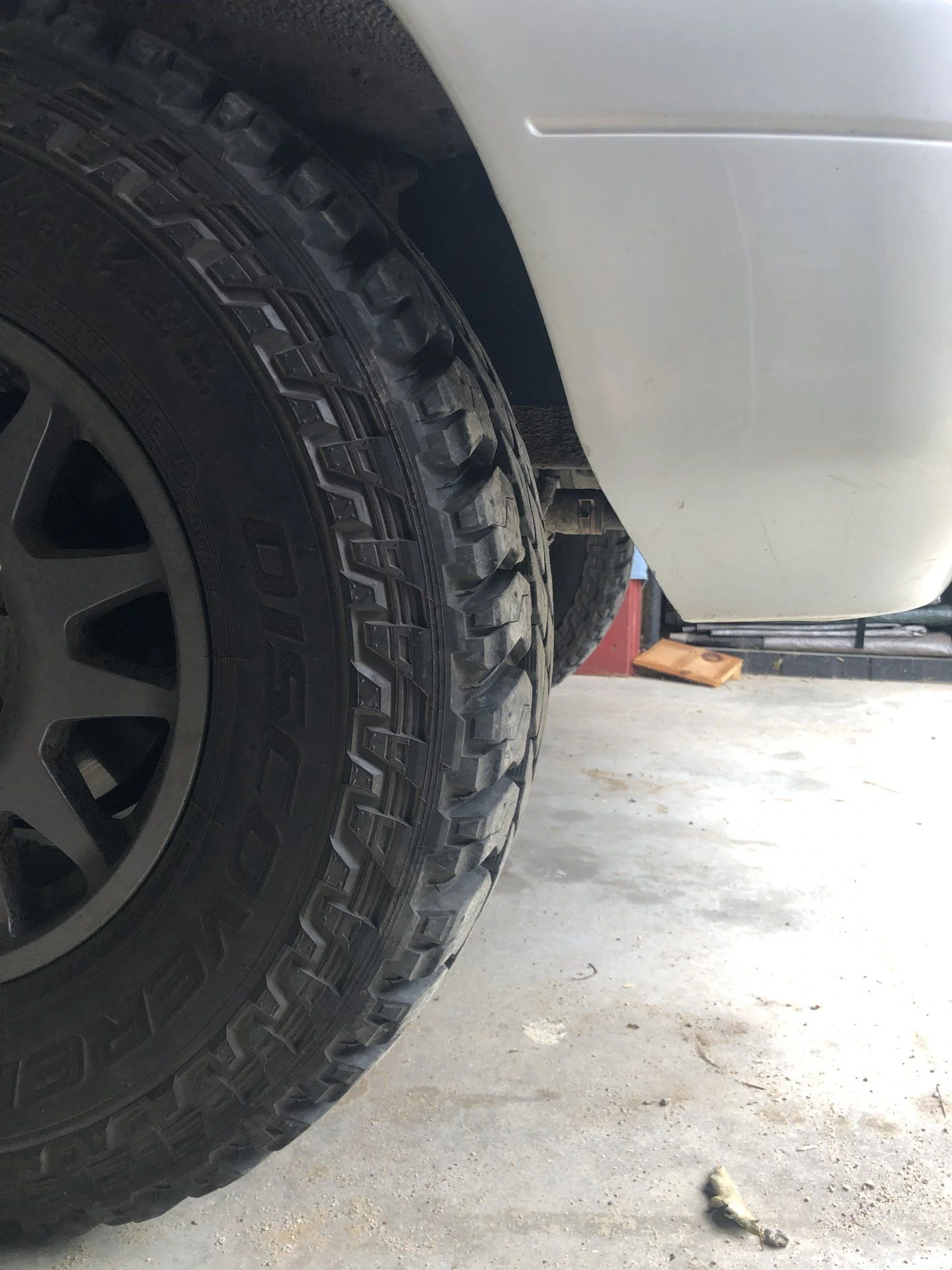

I'm running 33.4" and mine rub with AHC on neutral just as a data point.
What is your tire size? I’m referring to 275 70 18 at 33.15” that have no issues.
