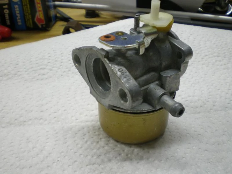

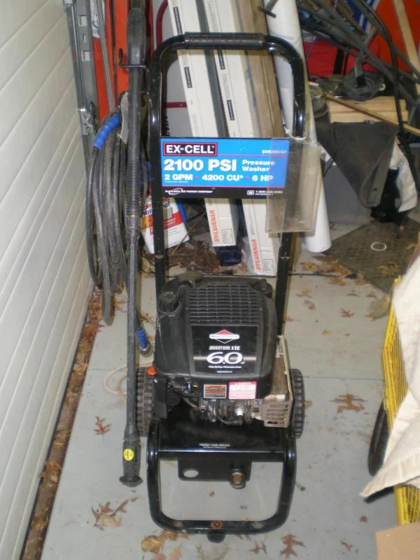

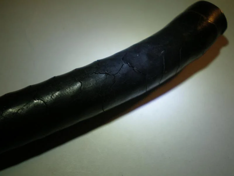

I was looking at craigslist for junk and came across a post for a 6HP 2100PSI pressure washer for $30 the next town over . Guy said the gas tank was leaking and hes not a handy person and it comes with a new H.P. hose and wand . I picked it up and the gas hose was all cracked and hard from the tank to the carb. so I pulled off the gas cap and with the smell I knew Id better clean the carb and tank . Figures I didnt have any 1/4 hose line so I'll pick some up for $1 .
I was able to get it to fire on carb cleaner so If all goes well I should have a good running unit tomorrow .
An hour of time, $1 of hose a couple of cans of carb cleaner I hope to be golden .
