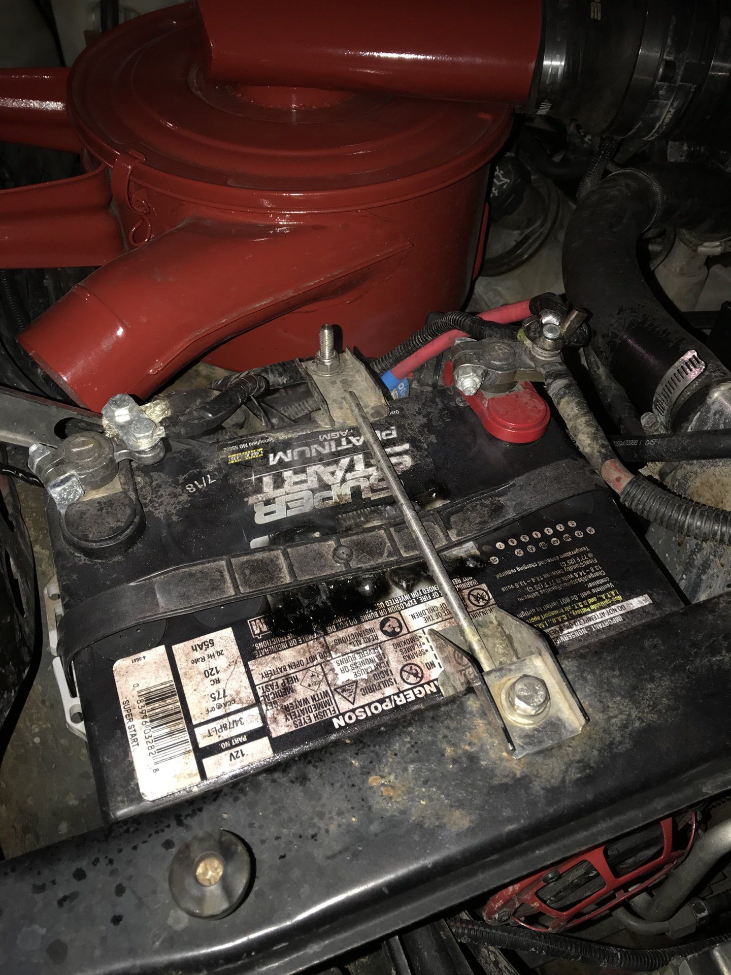

So I’m driving home tonight and I had my roof rack LED bar on for a few minutes as I went through some curvy roads and I started smelling Sulfer, pulled over and the battery was fuming.
Some back story, at the SAS this year my 8 year old auxiliary optima met the same fate, but I wasn’t using lights at the time and attributed it to a old battery. However, This time around the battery is top of the line and less than five months old.
My rig has a dual battery system with a battery isolator. Should I look at that first as the culprit? None of the fuses blew - from the lights or anywhere else - which leads me to the only non-fused link....the isolator.
What I don’t understand is that If the isolator is bad why didn’t my autozone special starting battery boil as well? Wouldn’t both battery’s get overcharged?
Where does the witch hunt begin?
