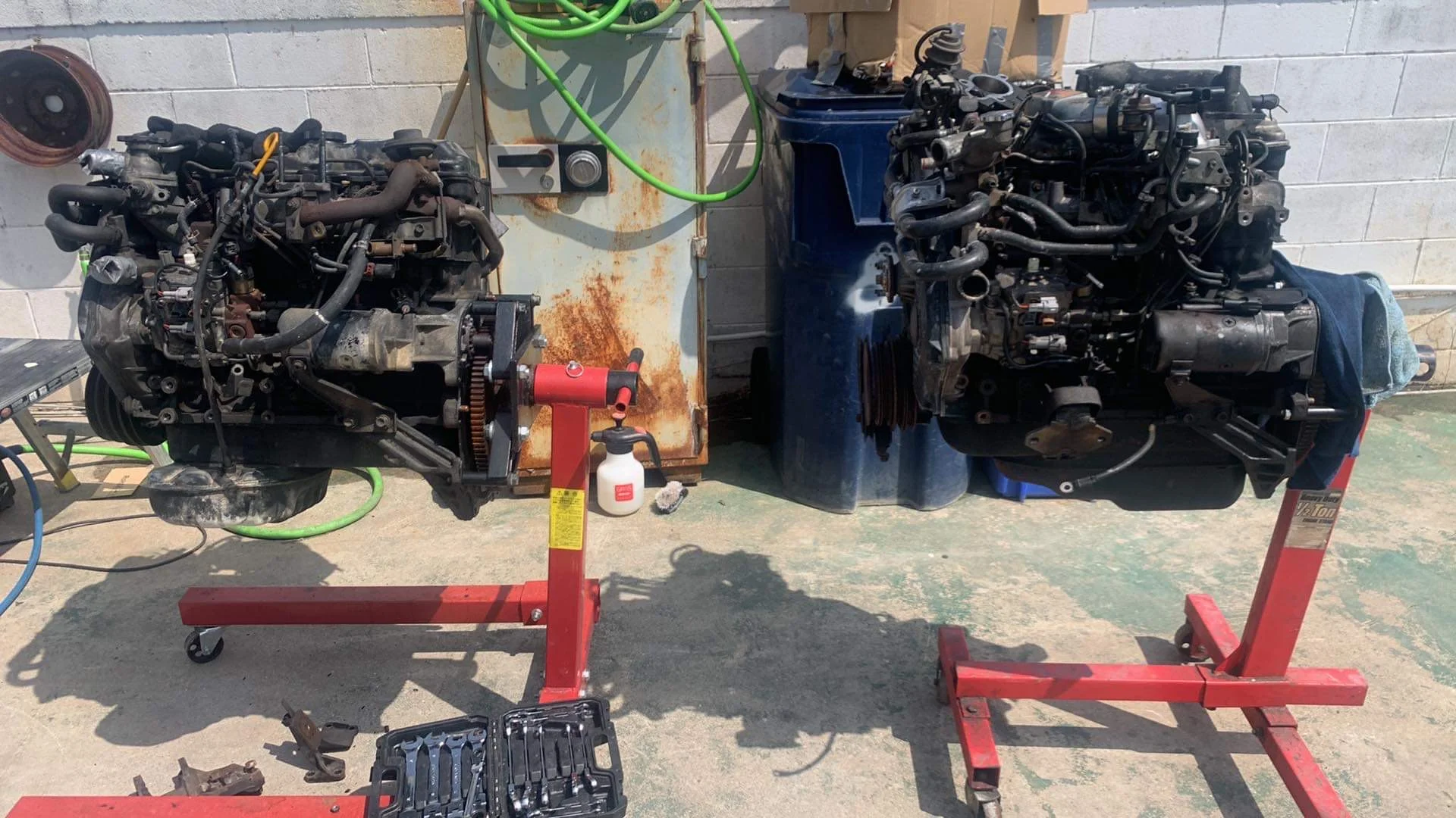

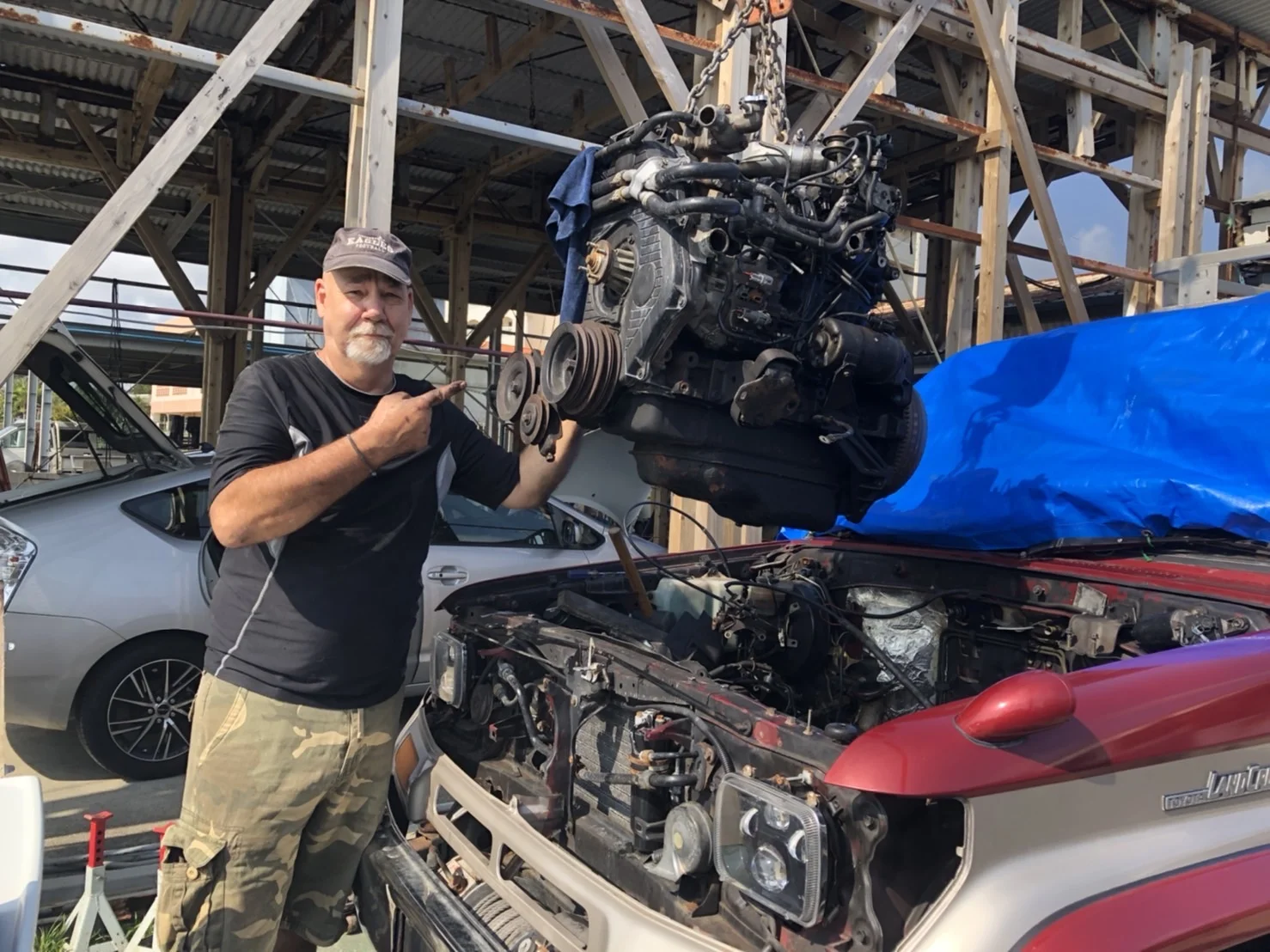

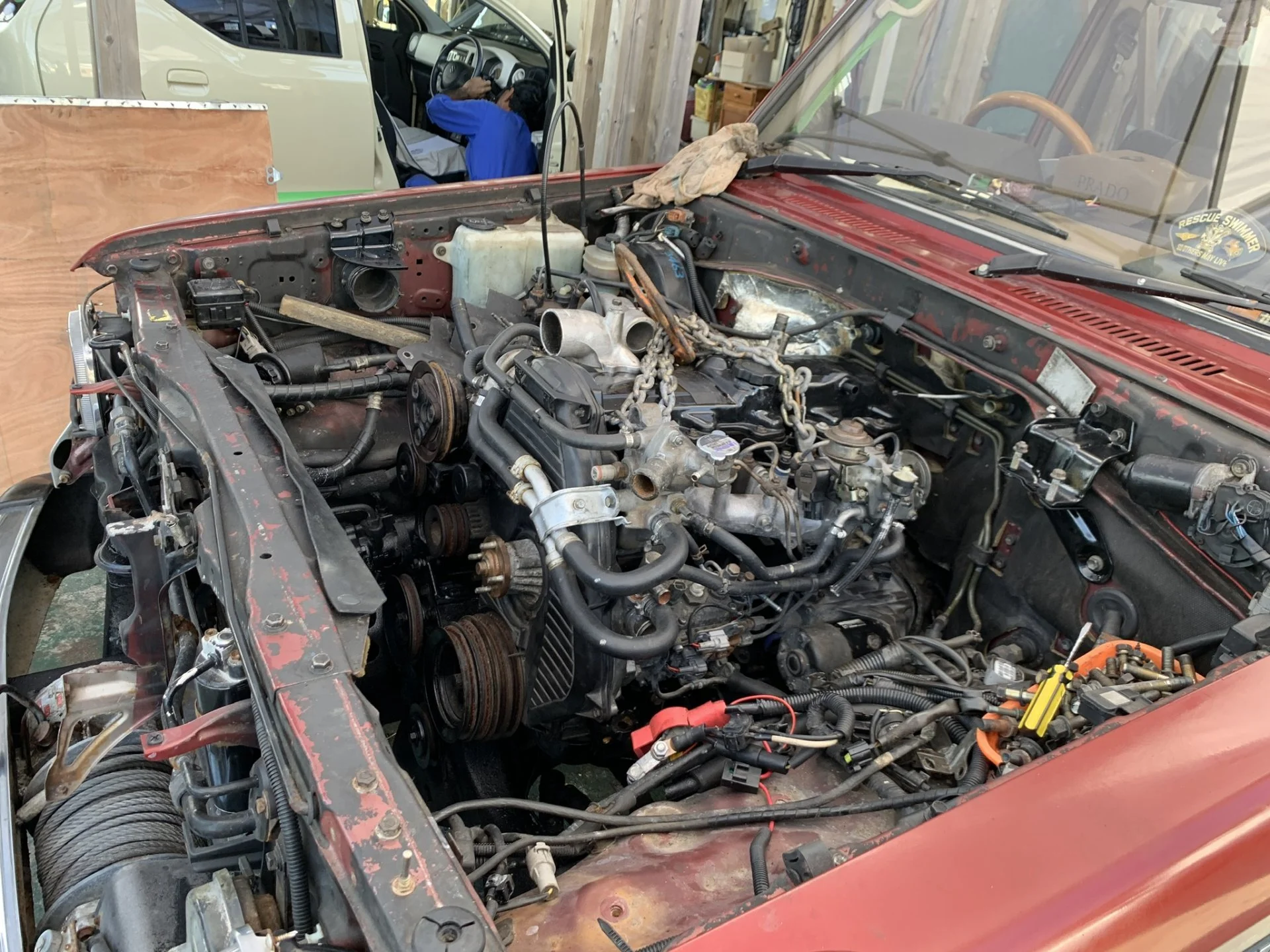

When I had mine out, I left the torque converter in the bell housing. My guess is your problem has something to do with the torque converter. Here are some pictures when I did this work. Might help you figure out which torque converter is which, and double check the engine pictures.
After looking at yours I’m convinced that it’s the correct torque converter but I believe your right that it’s not in all the way. Should have just kept trying to install it with converter already in bell housing. I’ll try it again.
