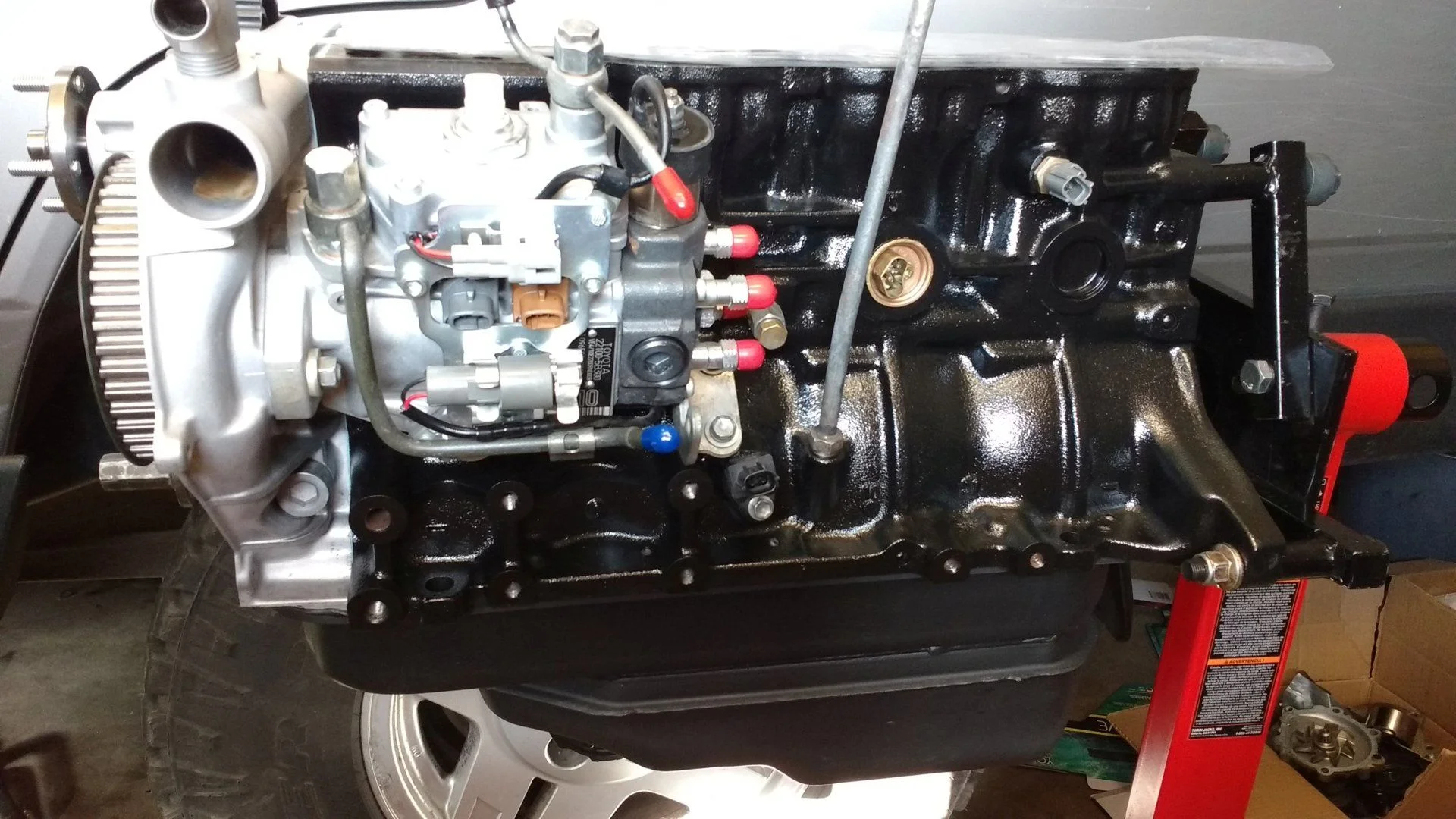

I just bought a Tempro off the shelf from NAPA autoparts for my 2LTE. They carry the line and had lots of different ones in stock. I went with the 3100024. I'll be installing it in the next few days, but I've heard from other owners that it fits perfect.
So that part number that I used is intended for the first generation L, 2L and 2LT engines (pre 1989). It did not fit that well in my 2LTE, but I was able to make it work ok with a bit of modification. Here is the catalog that has the part numbers for the Tempro heaters: https://phillipsandtemro.com/wp-content/uploads/2016/11/2016-Zerostart-Catalog.pdf The one that I used is for a 35mm bore diameter. You can see they have quite a few of them listed there for Toyota motors including the 2H and 3B diesels. A mix of 35mm and 40mm bore diameter.
The trick is getting the element to fit in the cooling jacket at the right angle. I think that is where every motor is different.
Edit: Here is a picture of the block heater in my engine shortly after I installed it.:
Thanks for the follow up. Yeah it's always tricky to find block heater s for JDM's. Not only the right plug size, and position in the block, but even the way it is clocked. As you say, clearance can be a problem.
I guess my first job will be to find an accessible frost plug and mic it, once I get the truck. Maybe a little digging in partsouq too, to see if they list the bore size of the frost plugs?
