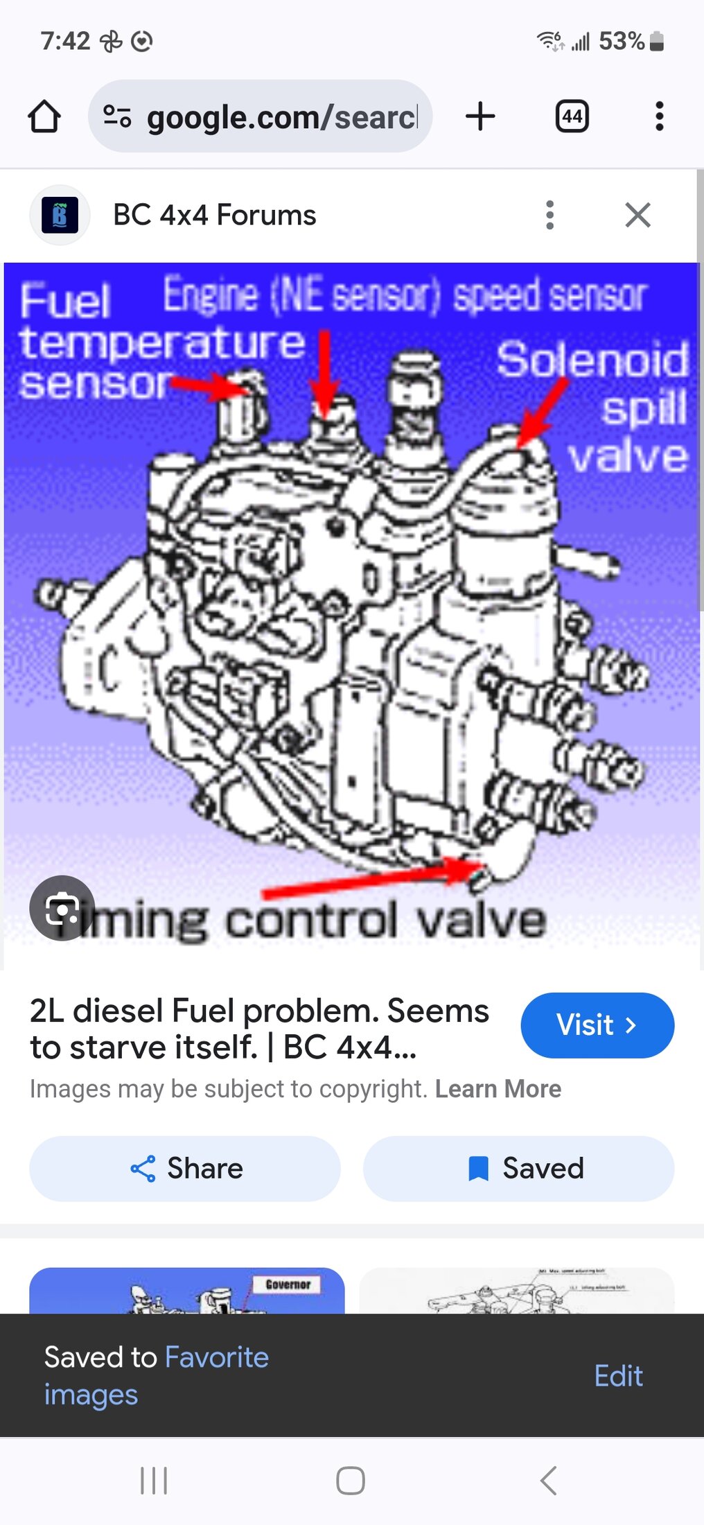

Thank you very much for the info. Which one is the solenoid? Is it the spill valve in the diagram above? thanks again!

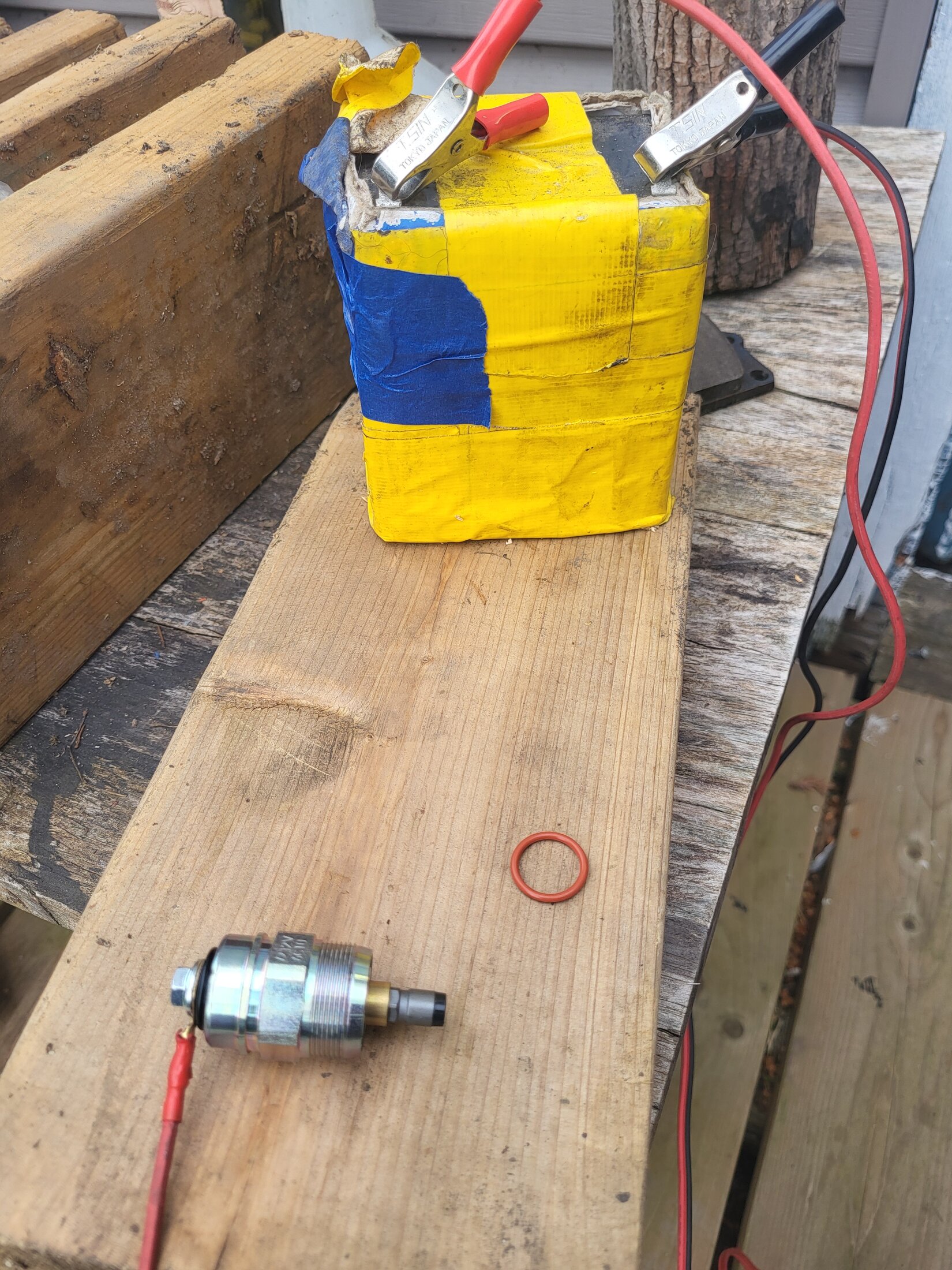

In the photo you see how I've energized the solenoid with + feed and tapped the - ground to solenoid body. Doing this creates the click and movement of a little plunger. Simply remove the rubber boot and apply battery positive feed to the solenoid, if it clicks then it should be OK.
In no click then change the solenoid, if it clicks you have a wiring issue.
If the wiring is bad, run a fused wire with a rocker switch and make your own anti theft device.

Guys guys guys. The 2LTE is electronic injection and has a spill valve in place of the fuel shut off solenoid of mechanical injection. If you put 12v to the 2LTE one it'll ruin it. It's made only for pulsed current. Best is to check resistance. You'll have a heck of a time finding a replacement if you do wreck the spill valve; likely having to buy a new injection pump.

Pretty tough even finding info on this part other than being common to toyota diesels from Corolla to Hiace if that helps.
