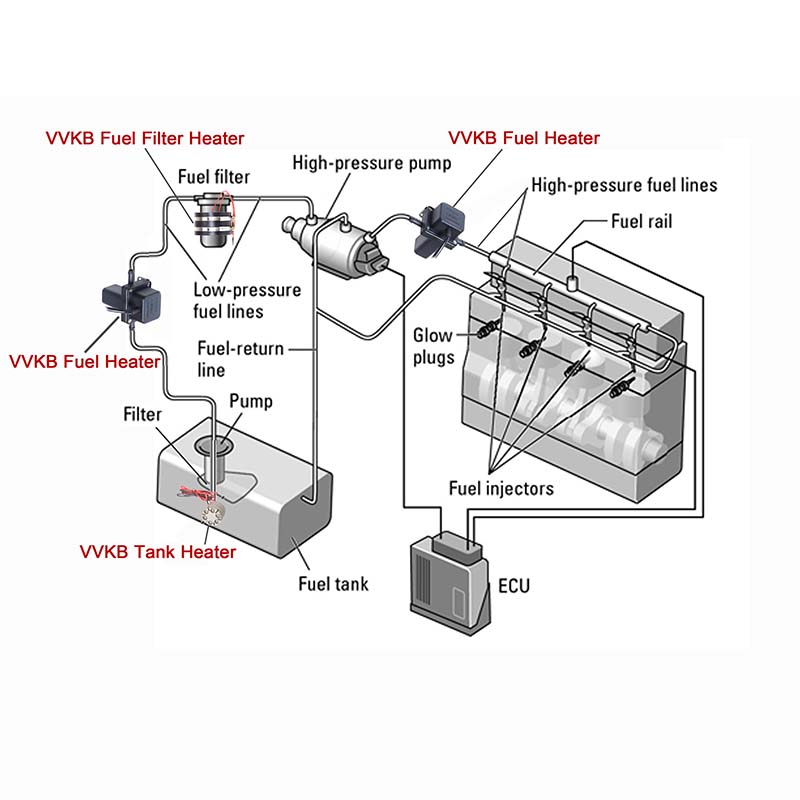

Cold fuel is harder to burn. The engine sends about 3/4 of the fuel through the pump back to the fuel tank. Each time it goes through it gets a little warmer. Some engines come with a fuel warmer next to the fuel filter. You can add one if you want.
This type wraps around the filter
