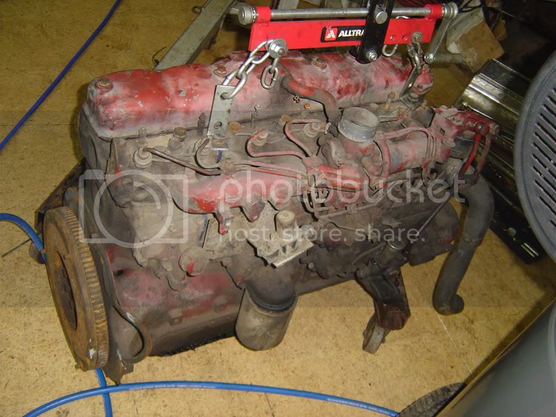

Hi guys,

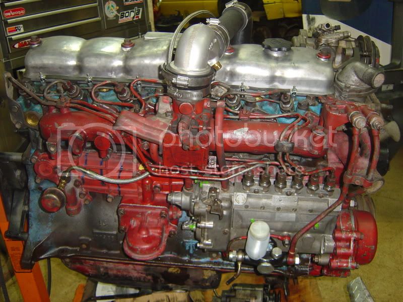

Just wanted to post some pics of my latest project.
Before:
2H Turbo

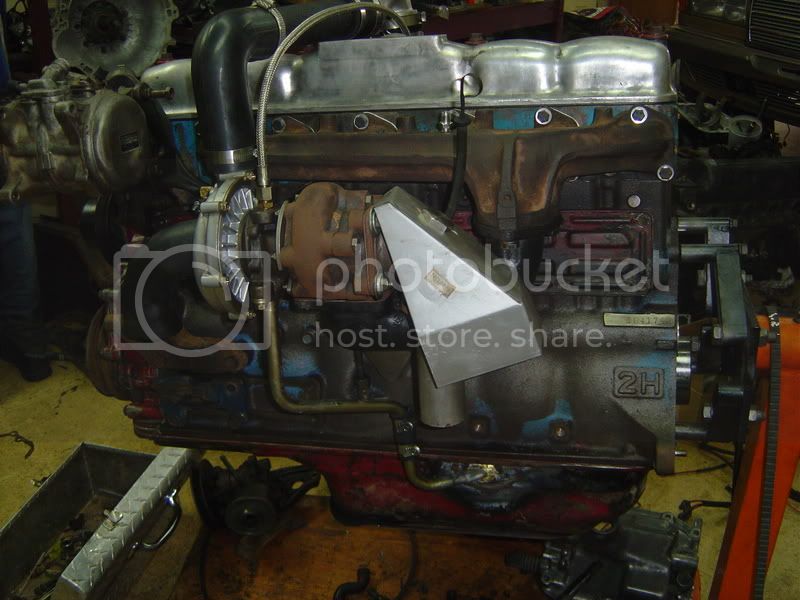

Who's kit is that? And if you dont mind how many $$$
Hi, very curious where the turbo U-tube from the exhaust outlet to the turbine came from.
Which turbo are you using? What's the turbine A/R?
~John
Hi,

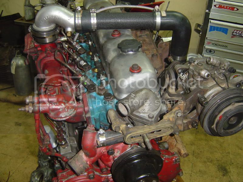

The turbo and U adapter was made by a japanese company called SK Turbo. They used to sell these kits a long time ago, I don't know if they still exist as I got the parts used at a diesel inyeccion shop.
It was the same turbo used in a 3b turbo kit I recently got and was made by the same company. The turbo is a german made KKK. I think its a ct26 but am not sure. Since i got rid of the b motor, I decided to complete the kit with the parts off the 3b turbo kit. I paid about $1000.00 for all the parts , but realize that it was Old stock and they were trying to get rid of it.
The U adapter is made out os cast steel, but can easily be copied. Other than that and the turbo, all the other lines and hoses can easily be bought or made locally.

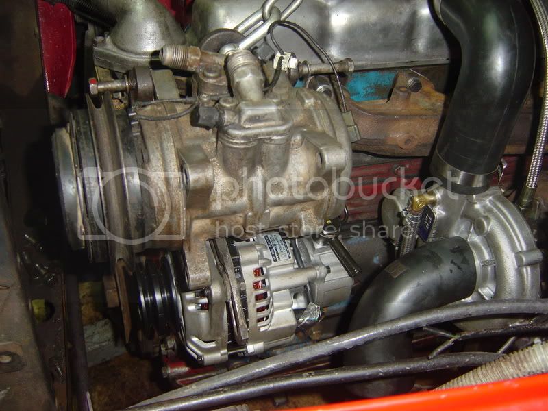

Yeah, its kinda tight, but I can get it to work with the original brackets. I'm actually going to use an alternator for Kia And Hyundai which is 90 Amp output and also has the vacuum pump built in.

Great work. It will be intere3sting to see how the turbo will work out on your truck. Hey, can you provide more info on the kia alternator you mentioned?

It's a Kya Hyundai Alternator that comes with vacc pump attached as same as toy alternator .. but with more amps .. factory.
Here I found one from a Galloper ( Hyundai ) in 190.00 USD with 110 amps .. :D

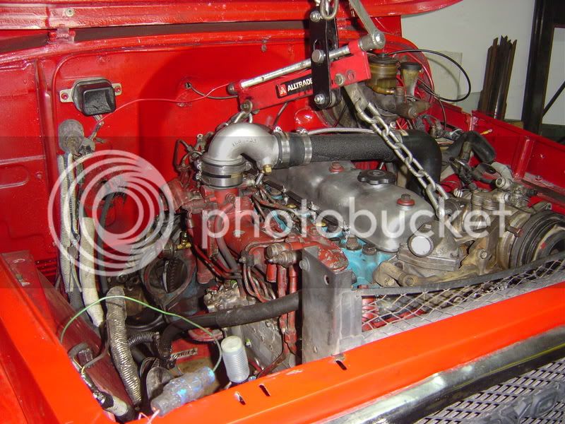

Latest Pics:
Hyundai Alternator

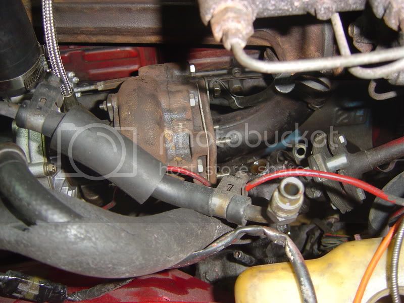

Clearance issues between turbo and steering box
We will have to add an extension to the turbo adapter to lift it above the exhaust manifold. We might need to move the tranny xmember back a few inches for the fan.
