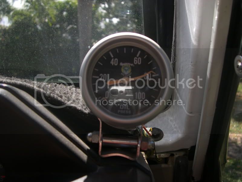

This is a picture of my oil pressure gauge after the relief valve jammed as you can see it went right passed the 100 lb pressure mark and bent the needle on the rest post. Well over 100 lb pressure. I reckon it would take about 2 minutes to pump the sump dry. Man was I lucky as I was told by a good bloke behind me as the shut off had not responded yet?????. LOL.
