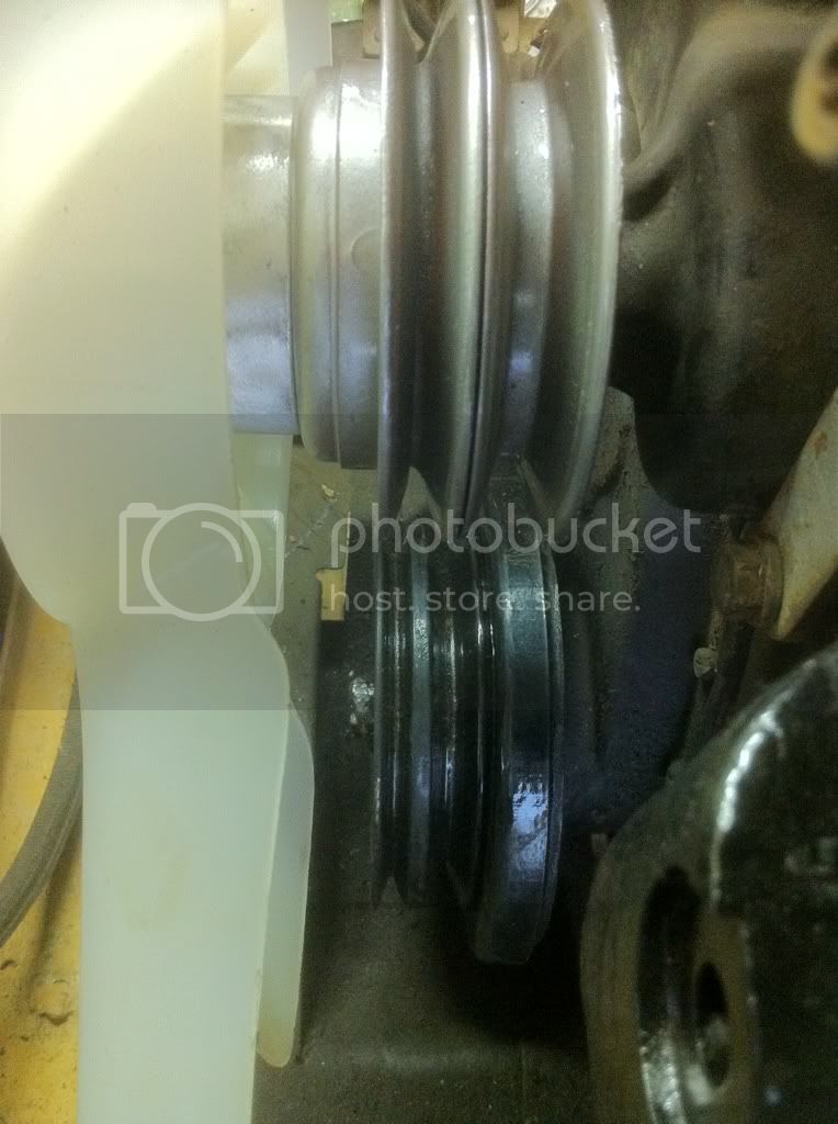

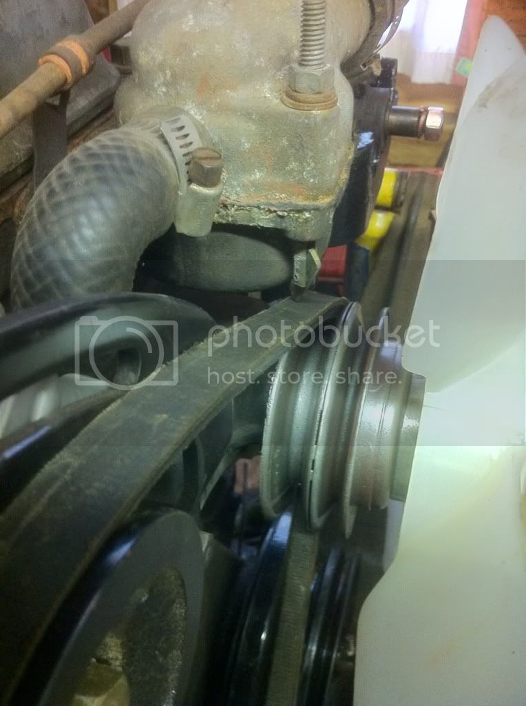

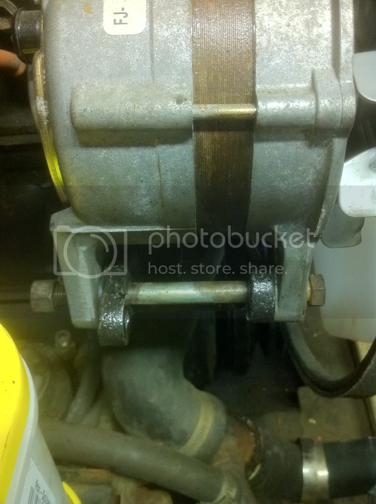

Alternator lined up in what I call the inside position. This would require a spacer between the alternator and bracket. Here the belt lines up with the inside set of grooves, but the belt hits part of the water pump housing.

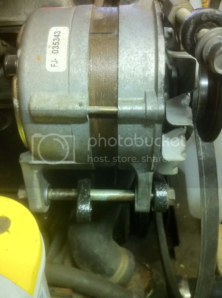

Here it is lined up in the outside position.

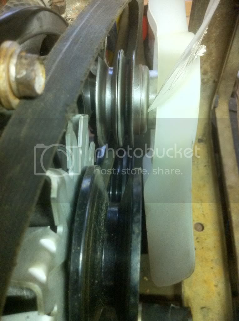

Here's a view looking from the other side at the water pump pulley and harmonic balancer.
So...what do I have wrong? Wrong alternator bracket, wrong pulleys or something else?

Alex, the 3rd picture appears to show the alternator in the correct position. Keep in mind that the late 2fs with PS used 1 belt around the crank, alt, and PS pump and then another around the crank, smog pump and water pump. You may need a smog punt eliminator pulley to make things work in a stock config.

I'm at work and can't see my cruiser from here LOL!!! But IIRC the alternator needs to be in the "outside" position as my alternator and bracket is set up on the outside like Rocky's and mine is a 78 2f (in a 40), stock set up. I used an MAF pump bracket and the belt went to the back (or second) grove of my water pump. As for the types of pulley's and belts, mine were for the V belts and I actually had to run the narrowist one for the P.S. to keep it from making noise (belt squeeling). Oh, and I used a chevy P.S. pump, this may be a difference.

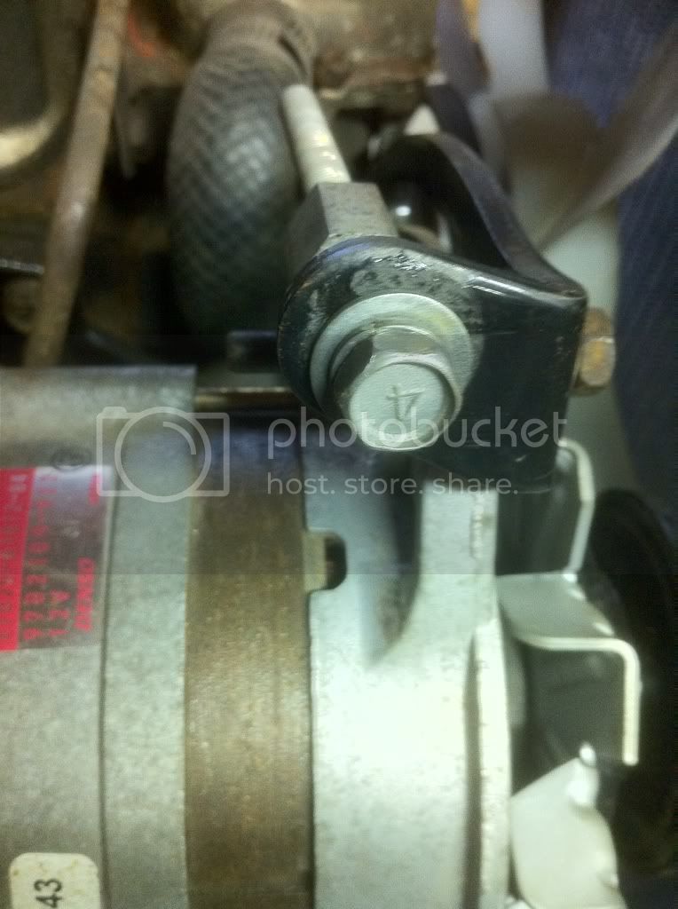

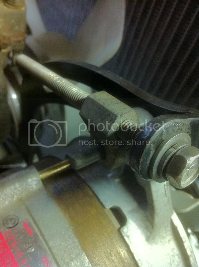

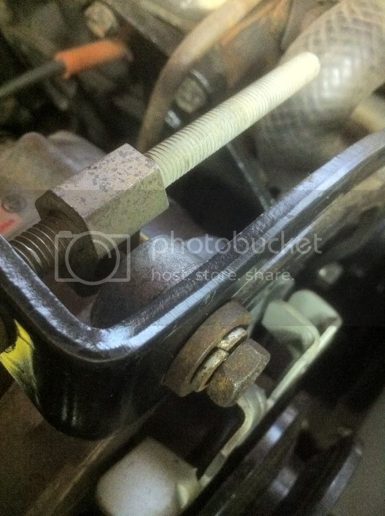

If I put it in the outside position, how does the tensioner work?
I realize the ear on the nut needs to face down. Does the bolt go through the threaded hole in the alternator and into the non threaded hole in the tensioner nut? I tried and the hole in the nut is smaller than the hole in the alternator, so no go.

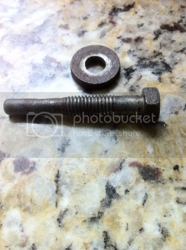

you need the special bolt that goes through to the back side of that tensioner.

Alex, it's a special bolt with a skinny non-threaded end on it that threads into the alternator and then sits in the tensioner nut.
Yeah, it makes sense. I just called CDan and it's an FJ60 bolt and it's discontinued. I guess I need to call my screw guy and have one made.
Anyone else need one as I'm sure there'll be a min buy?

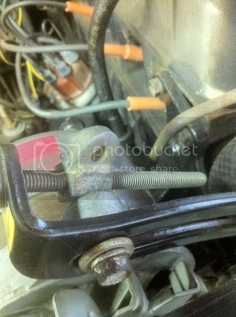

SouthBostonFJ said:
I just ordered one from Cruiserparts.net. It should be here on Friday.
In case anyone wanted a better picture of the bolt, here it is...
