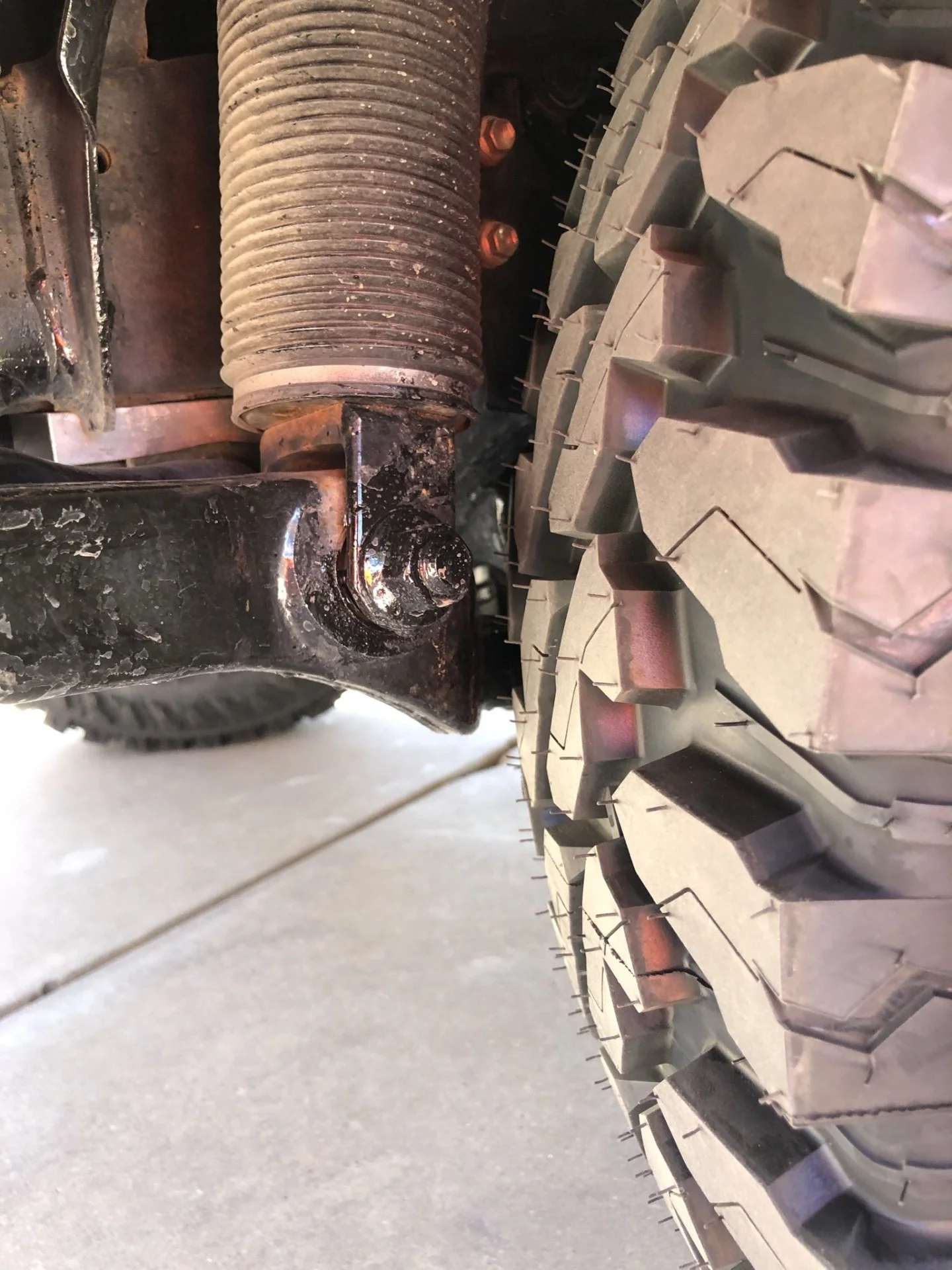

Running 295/70/18, KDSS Relocation, SPC UCAs and Ironman suspension. No wheel spacers. Tight fit, but no rub at all. Messing with the castor is what did the trick for me as far as the KDSS bar goes.
You've gotta post some pics.
