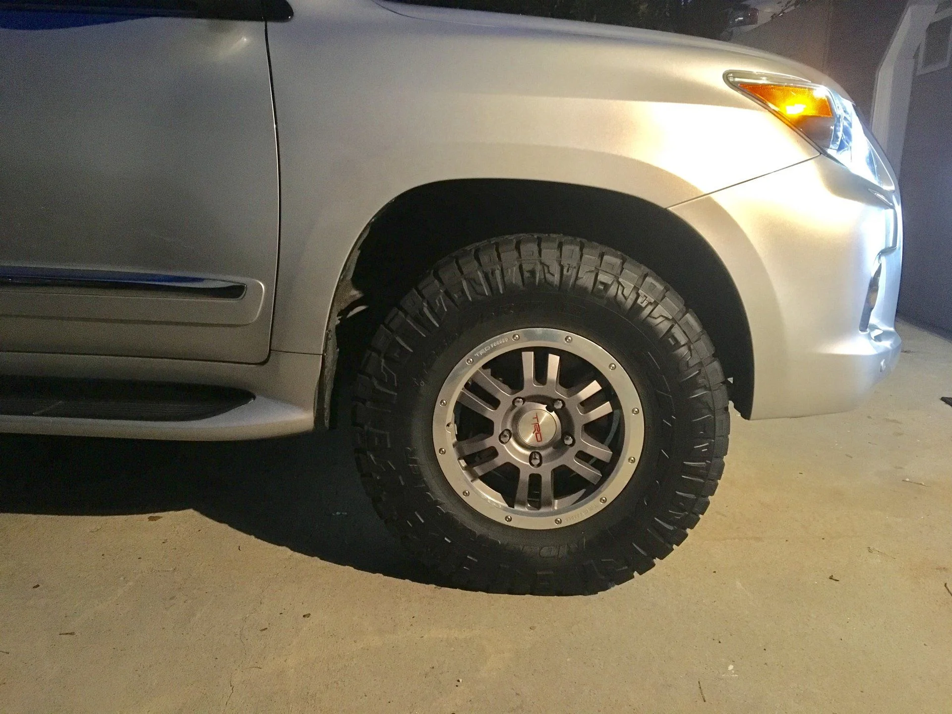

With 285/70/17 I had to trim the rear of the front mud flaps a little so it would not rub at full lock. With 285/75/17 I bet it will have more rub and will need more trimming and massaging. However if I were to do it again I would probably have gone with the 75 and a bit more trimming.

Split the difference and run 275/75/17?
