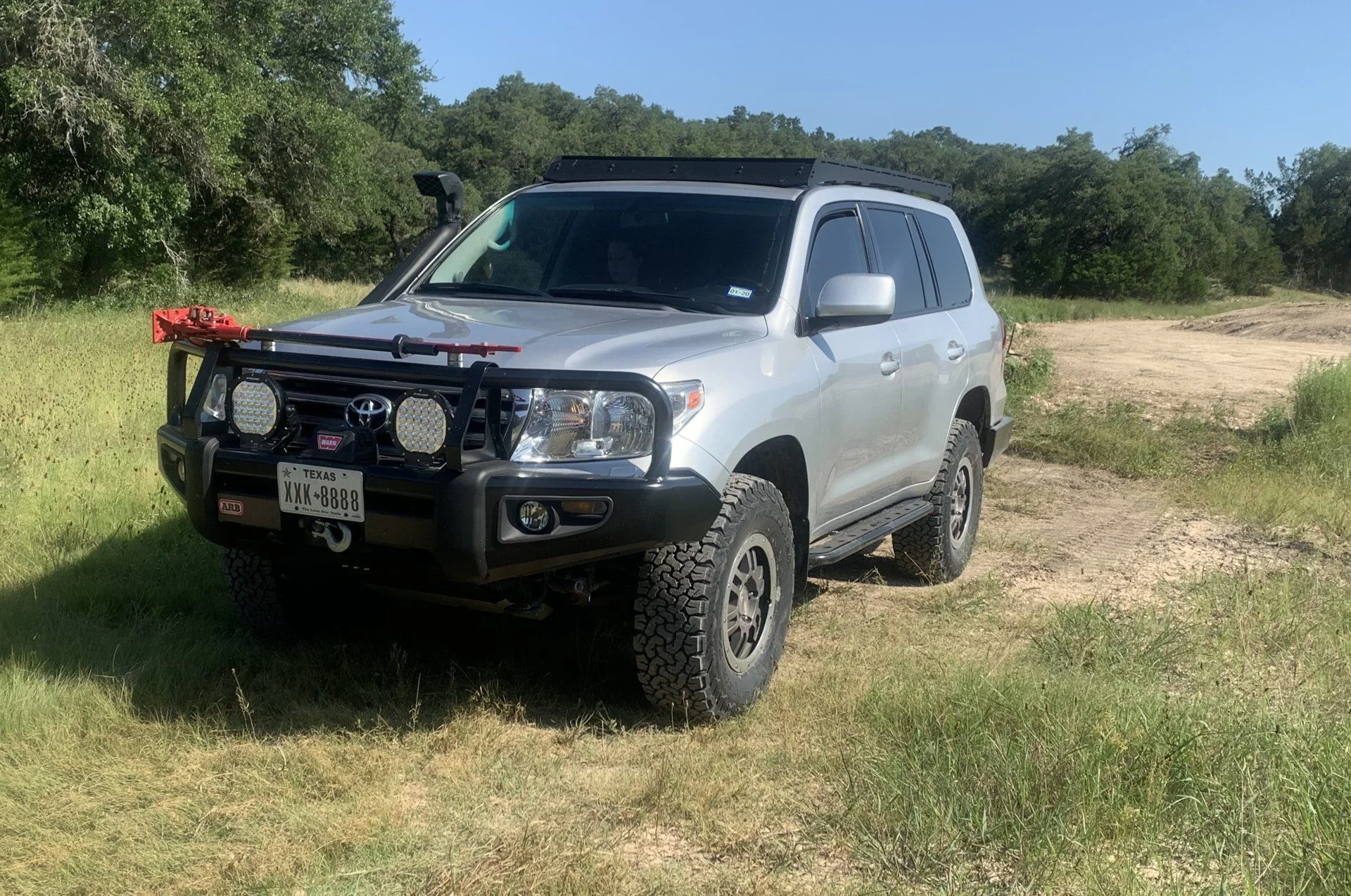

Here you go. OME medium duty lift, stock UCA's. 285/75/17 KO2's. No rubbing but haven't had them at full flex yet. I am getting some rubbing against the driver side front mud flap since it's warped and protruding a little. Only happens during a certain turn when flexing the suspension a little. Passenger side is fine. Hope this helps.
Was thinking of 285/75/17 on my RW’s. What kind of “effort” are we talking about? Stock bumpers 40/20mm of lift with SPC UCA’s.

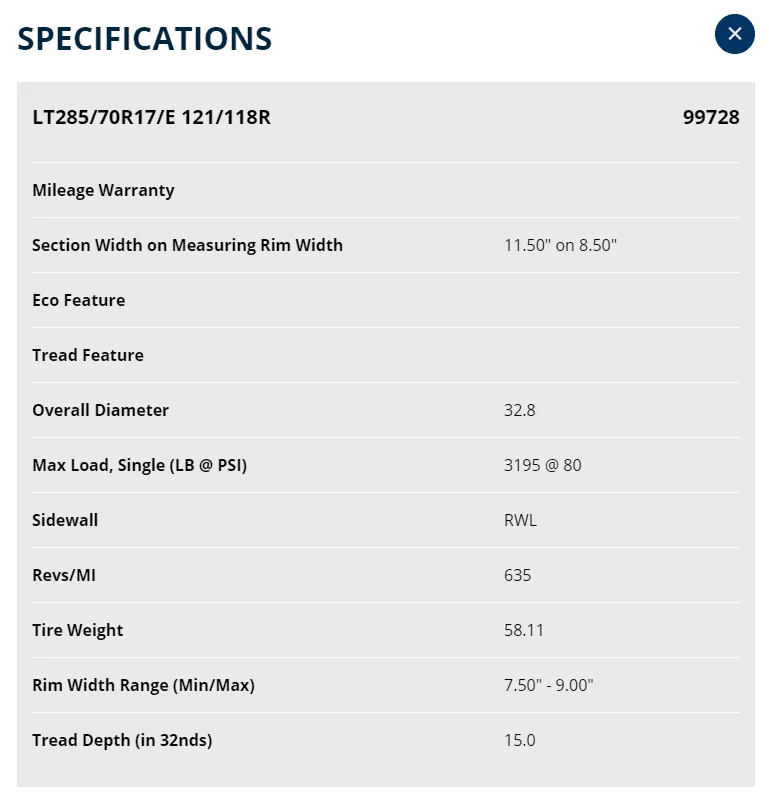

Does anyone have the actual diameter of the 285/70r17 KO2 when "normally" inflated and mounted?
BFG claims 32.8".
Most folks say BFG "tends to run small" in real life. There have been other postings trying to measure the tire size as well. I know this is probably what you're really asking.
Keep in mind tire size is calculated at max PSI when mounted on the correct size rim, but not on a vehicle. So if you have an 80-psi E-load tire and are running 42psi it's likely the tire is a bit smaller than advertised (in fact different tire diameters depending on inflation pressure are how old school TPMS systems work - measuring differing wheel speeds vs actual pressures). Putting the weight of a vehicle on it will deform the tire as well, of course.

Yep, you are correct. I'm looking for the actual measured diameter of the 285/70r17 BFG KO2 tire on an 8" wide wheel when inflated to the proper running psi and actually either mounted or unmounted as long as it's specified. Yes, from lot's of reading I understand the stated manufacturer diameter is at max psi so it's always a larger diameter than what is actually used day-to-day. Just as the KO2 in 285/75 flavor lists 33.9" but mounted on RW's and inflated to the @gaijin specified 37psi that diameter is ~32 5/8".
So, that's what I'm really looking for. How much smaller is the KO2 in 285/70 flavor when inflated to the "normal" operating pressure than rated diameter and mounted on an 8" wide wheel?
