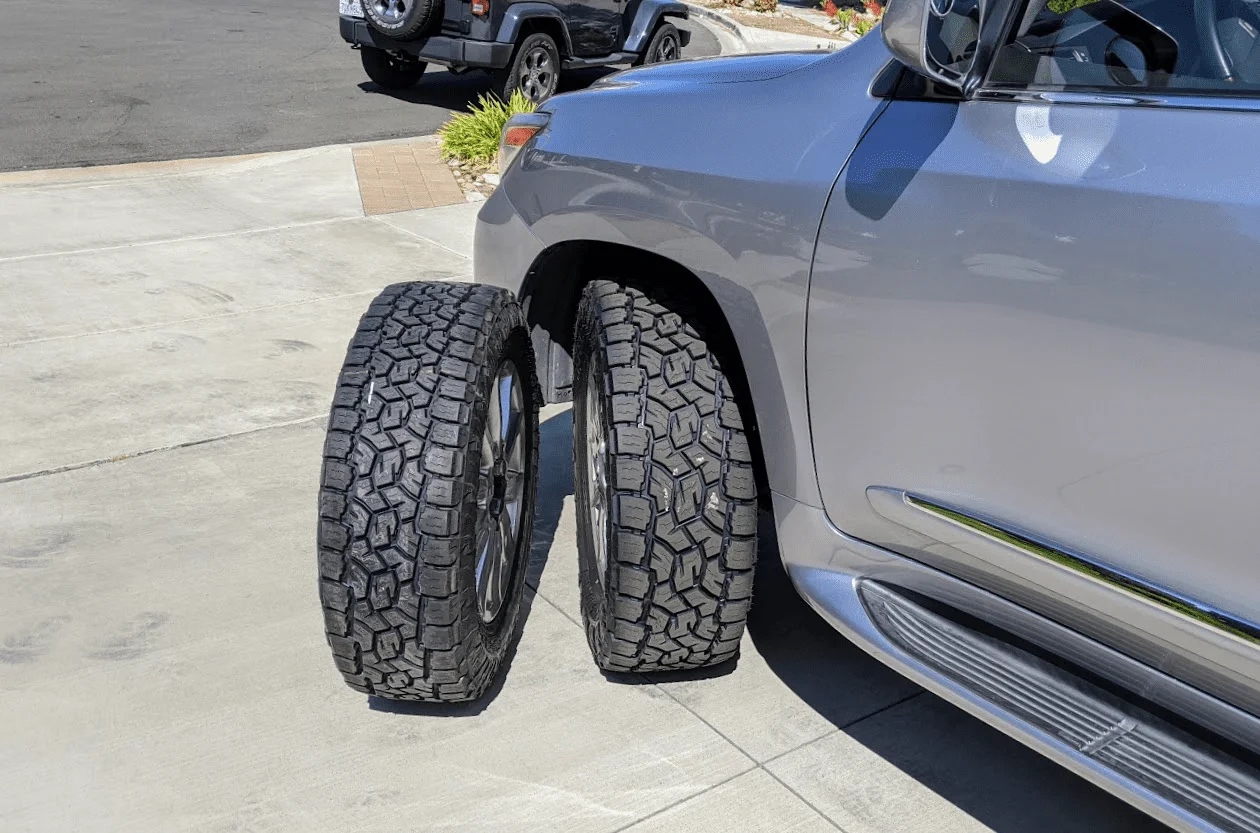

That's a 275/65R20 at the left next to my full fat 35x12.5R20s. It doesn't look like it but they do differ in size at 34.1"x11" to 34.5"x12.5" respectively.
There's a good chance it'll drop right in with minimal mods. Key is offset as the fitment is pretty sensitive at these sizes. Just enough offset to clear all the suspension arms, yet not so much that it makes the steering swing too wide creating clearance issues at the forward and trailing edge of the wheel well. A 1" spacer with stock wheels (-35mm offset) will clear all arms in my experience for a narrow tire. I'm finding my wider tire will need a tad more offset so I'm switching to a 1.25" spacer. The 1" spacer will also make just about perfect scrub radius suspention geometry.
Then it's just a matter of pulling the forward edge of the fender liner up about 1.75" which is cake. Then remove the mud flap and perhaps cut a bit of the inner edge of the side step. I think that's it and you should be just fine or perhaps very minimal situational rub against the body mount.
Lastly, I have the 275 for a spare, so it'll fit there just fine.

Guys, thank you for your enthusiastic responses. Wow, next to the 35” it doesnt seem much narrower or shorter.

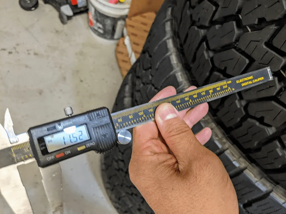

I'm measuring 10-12mm (at least 13/32) left on my Wildpeaks that I just replaced, and they already have ~30k miles on them. Yes, they were that deep when new. Some people criticize the weight, but they really do start with more rubber.

Thanks for your help on this. I really want to buy this tire but what you’re saying doesn’t add up to the specs I am seeing online. 18mm is the equivalent of 22/32, which is amazing but I just don’s see that anywhere. Not even close.

Wow, the tire is sitting amazingly close to the spring seat. I could live with thst but now I have to figure out if my 2013+ wheels have the same offset as your 2011- wheels.

It depends on tire size/type. Smaller P-metric sizes show tread depth starting at 12mm. All the way into the more extreme LT and Floatation tires that go up to 20mm. The tire in my picture is a LT305/55R20 that starts at 19mm tread depth. Your proposed LT275/65R20 shows starting at 18mm.
2015 and 2011 LXs have the same stock wheel offset of 60mm. You'll want spacers for two reasons - suspension arm clearance and correct suspension geometry. The tightest position will be full compression and full steering lock, where the tire will just rub on the upper UCAs.
