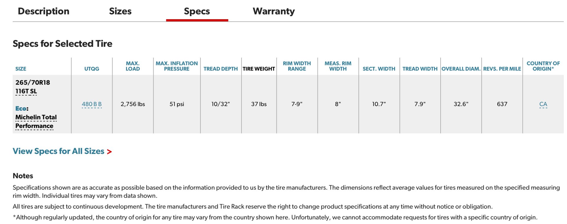

According to TireRack a 285/60/r18 BFG KO2 has a thread width of 9.7 vs 7.9 for the Michelin. That is a substantial difference. A Michelin Defender in the same size is 8.9".

It's not P-Metric, it's a Standard Load ISO-Metric.
The RCTIP for that 265/70R18 116T SL tire on a LC200 is 33psi F/R.

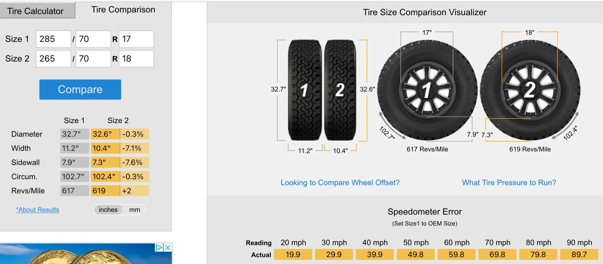

You think that it will rub KDSS bar?
I don't think it would rub, as that's both smaller diameter and narrower than the 285/70R17 that tons of people run without KDSS issues. Some do get slight rub at the rear of the wheel well if the mud flap is in place and hasn't been modified.

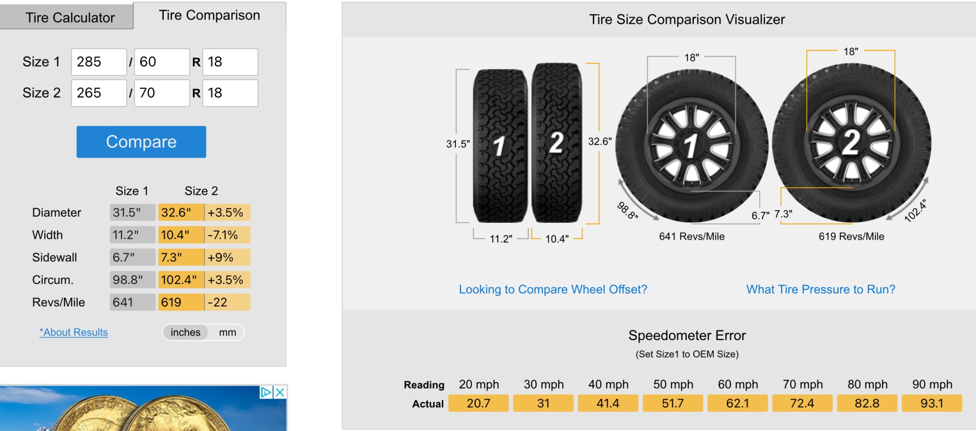

But if you want to compare you could punch that size in to your visualizer.
Note that there are two aspects to the rub usually.. total diameter, and the shoulder of the sidewall just as it transitions to the tread area. As you can imagine diameter and width impact these areas differently. Most people running 285/70R17 have at minimum 10mm more wheel offset than (I'm assuming) your stock wheels, moving their tire shoulder away from the arm, but those 265/70R18 tires give up that much on width in that area anyway.
Usually people don't start having KDSS arm problems until 285/75R17 which is almost an inch taller
