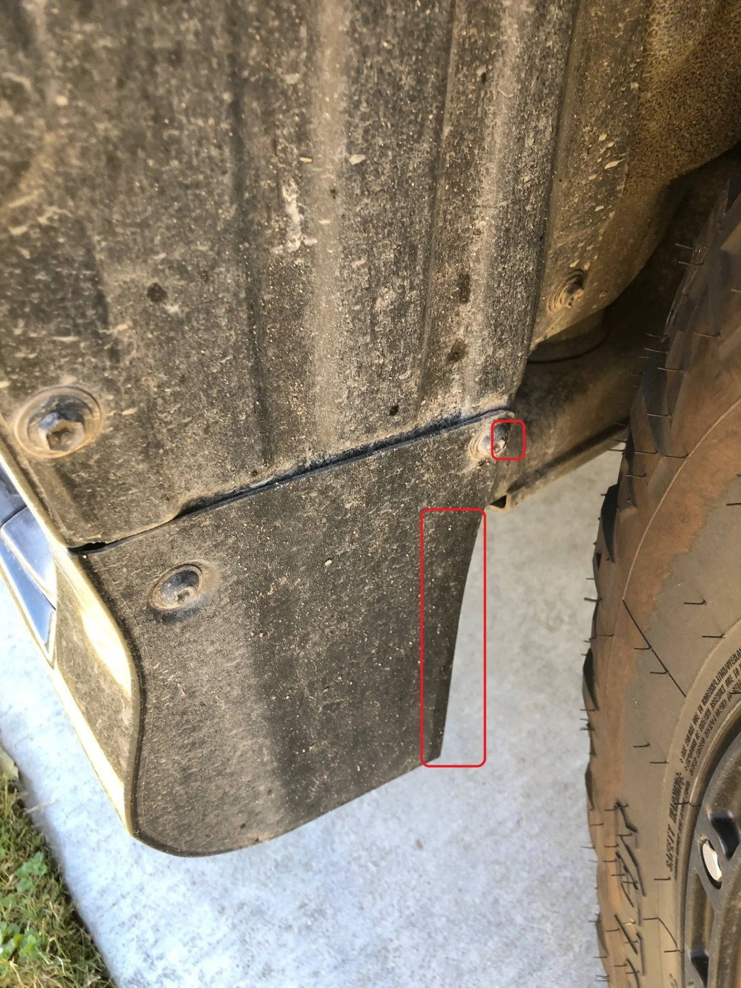

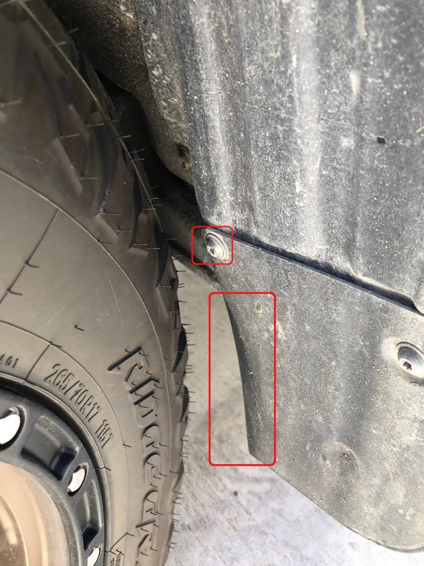

Ok folks, here's where my 265/70/17 Ridge Grapplers are rubbing. As you can see it is just a wee bit and mostly on the bolt head. So, any suggestions that are inexpensive to try first? I suppose I could cut the mudguards at an angle and see about finding a lower profile bolt? I don't want to remove them yet as I don't have the wheel well or vehicle coated yet. Are there any aftermarket mudguard solutions I should consider or is my redneck science thoughts on the right path? Haha.
All nascar or political jokes aside, I do more left turns than right turns it seems. Oh and I know they aren't technically mudguards but meh, I couldn't find a better name for them because its Monday and I'm sleep deprived.

Let me take a pic of mine in a hour or so and I'll show you what I did, but it did involve cutting a vertical strip out of the inside edge of the running board piece in red.

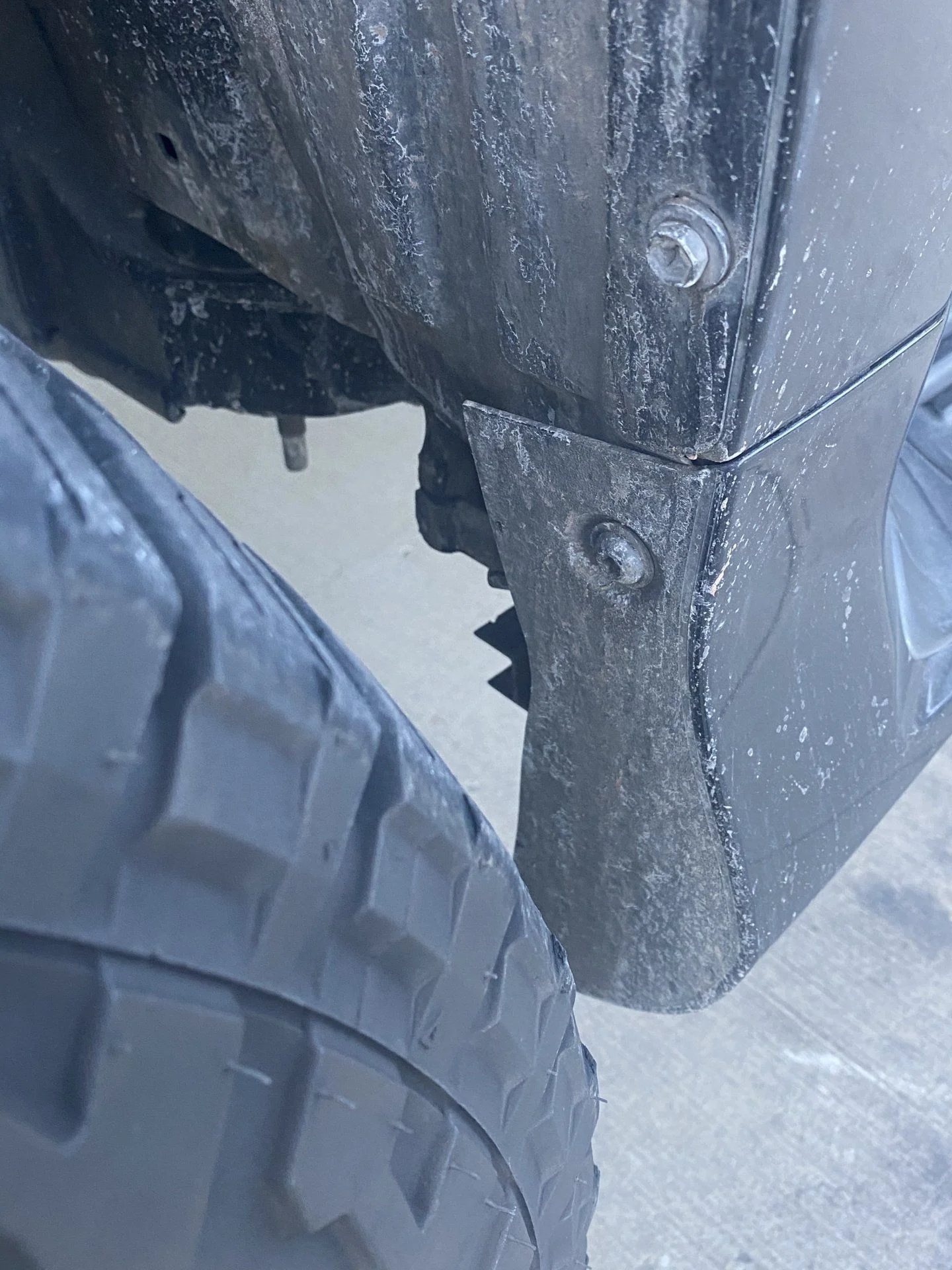

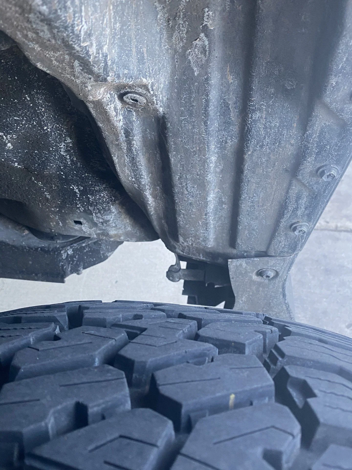

My bad, one hour turned into many, but better late than never. What’d ya come up with?
I trimmed the running board inside edge and the inner fender liner with a razor blade. Then screwed the fender liner to the seam weld to stop it from flapping (since I remove a bolt that held in and the top inside corner of the running board).
I used the rubbing marks to determine where to trim, gave it a good 50% extra clearance too. Then I had to flatten/bend the seam weld at the bottom edge and BMC. All just for 285/70R17s.

I don’t think your tires are big enough to think it’d be the body mount or seam weld behind the fender liner, so I’m going to guess either the front of the inner fender or the back of the inner fender where your removed the top-inside running board bolt.
If that corner of the liner is dangling loose, it could easily bend out a touch and contact the tire just as the bolt in that spot did.
I also rubbed on the front side of the liner on mine due to some missing fender liner fasteners that let it sag. Wore a hole and had to cut some excess off in the middle and then fasten it back up.
