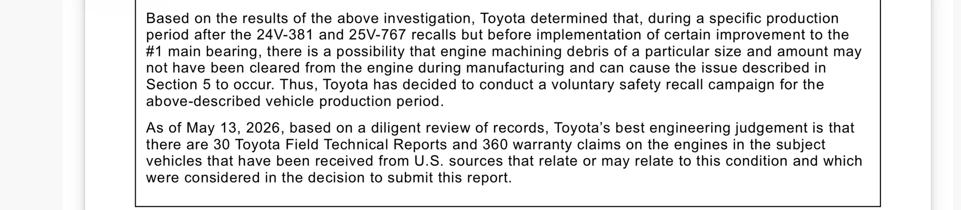

If it wasn't for the tundra, there would just be less of these engines on the road and less total failures. In theory, the % of failures between all these models should be similar though. It's not just the amount of failures that makes it an issue, it's the cause, if we're to believe toyota. One small metal shaving of the right size/shape and in the right place can grenade the bearing and it can seemingly happen at any time. And there's nothing an owner can really do to stop or prevent it.
People who work on the engine have been speculating that it is to do with some unintentional flexing in the engine bed. If that were the case then perhaps how the engine is attached to the chassis matters as well, which means it is not unreasonable to expect different failure rates for different models on the same engine.

Toyota provided some details on their latest recall notice. Screen print attached.
