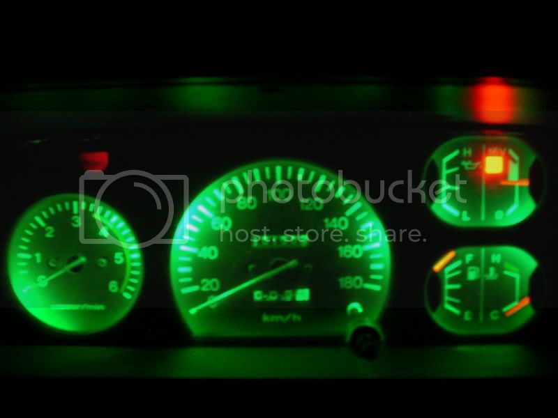

I fitted green 6 LEDS to the instrument cluster and it was a big improvement.

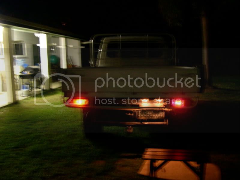

I also tried a 19 LED brake/taillight bulb and it showed more of a pinkish tone of red and was no where near as bright as the standard bulb. LED on right of picture, perhaps a different brand would be better.cheers

Wow, that looks like a great improvement over my dash lights,will have to check into those.:cheers:

I just replaced my rear lights with the ones referred to in this post:
https://forum.ih8mud.com/showpost.php?p=1639472&postcount=61
I really like them, they are VERY bright big LED clusters (but that source is in Oz).
I was only able to do the rear as the ones I got are are larger profile, and the front bulbs are smaller (but your source has the right ones it looks like). One note is that the lower current draw / resistance makes my blinkers blink faster as noted earlier in this thread. It may be that since I still have some incandescents they do still blink. So I guess a resistor may be a bit of a hack, but may work. The correct blinker relay is what you want.
