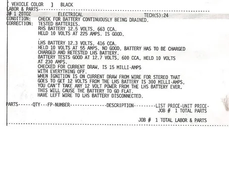

Here
Here is what the people wrote...

First of all make sure all the battery connectors and the ground connetions to the engine is good.
In a 24 volt system both batteries need to be the sama size and in the same condition. Since one battery was bad, I recomend you to replace them both.
Then get a 24v-12v volt converter, never "steal" 12v power from the lower side battery. I´v been there and it was trouble all the way.
Try to get a converter thad draws no power unloaded. Connect it to the 24v power outlet next to the air filter house.

As mentioned you are stealing power from the low side battery. Get a converter and run your 12v accessories off of that. I run my CB radio, cd player and 12v cigarette lighter for charging cell phone and gps off it. I wired a 6 gang hella fuse block into the converter so I can quickly & easily wire 12 v accessories into the truck. As mentioned in your headlight post, your headlights should be 12v not 24.

Which dealership are you dealing with? Personally, I would avoid almost any dealership like the plague. They tend to charge you ridiculous prices for mediocre work. I only use them for buying factory parts that you can't get elsewhere. Like my $10 a bolt fasteners for bolting my driveshaft to the transfer case. Your converter hooks up with a single thick gauge wire running from your highside battery and a good ground. Any decent shop could do it for you. As for how did they wire it without the essential converter? They wired it improperly, that's how. They created the battery drain problem and then dropped it in your lap. What scares me is that they don't seem to have the faintest idea what they're doing.
Sounds like they just slapped it together to make a quick buck (go figure). I would kick up a big stink and see if you can get them to put in a converter on their dime. At the very least they should be responsible for installing a supplied converter. Make sure to remind them that they killed both of your batteries and they should be held responsible.
