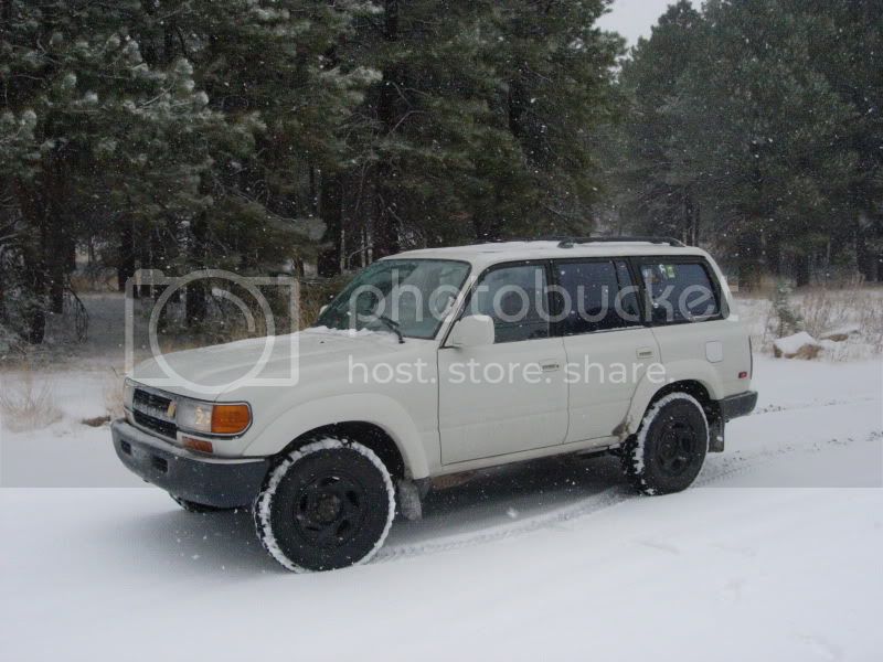

I run 235/85/16 MTs on Tundra 16x7 rims, and love them.
We just had our first major storm of the season, and have well over 2' of snow on the ground. These tires cut through it better than anything else I've owned.
I bought mine from TreadWright for about $85 a piece.
This is a pic about an hour into the storm, just to show the size relation.
