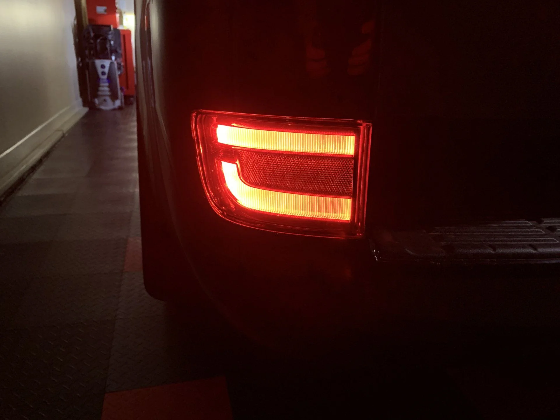

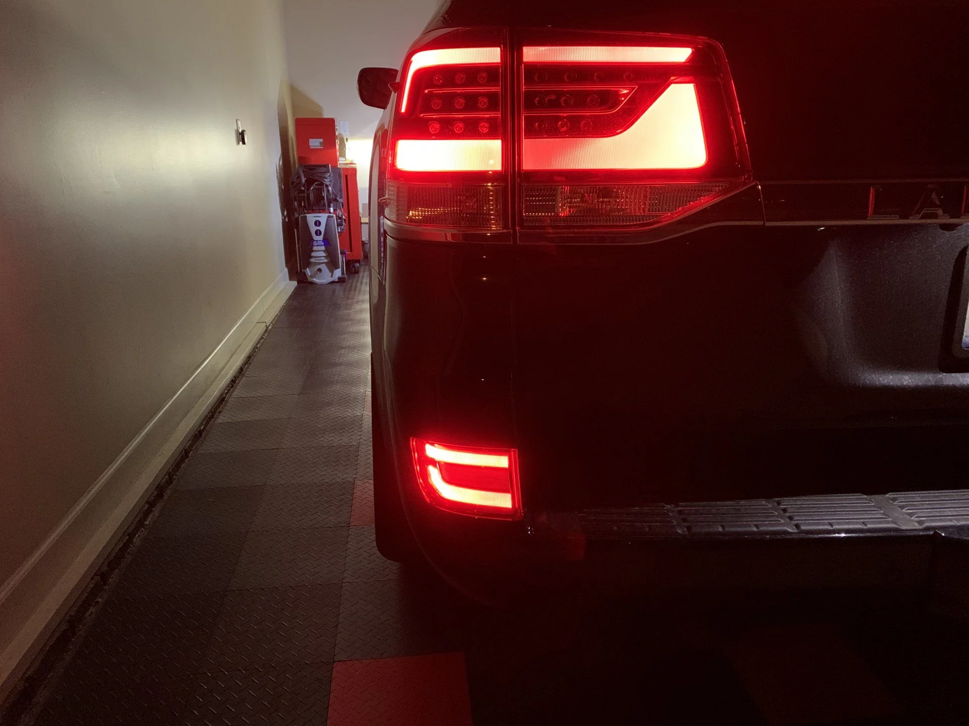

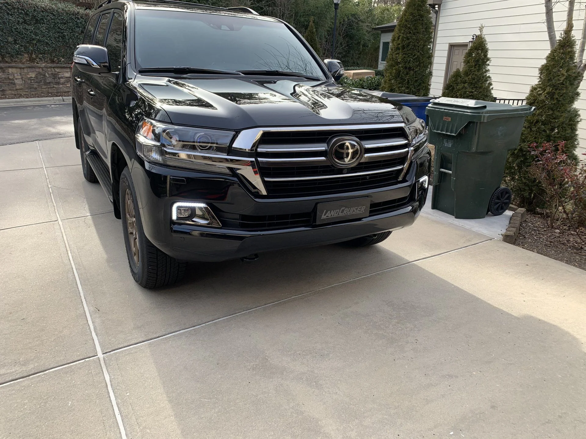

Only non-LED are turn signals and reverse. 7440 for turn signals and 921 for reverse. Recommend VLEDS for those. You can do some other upgrades but it will require parts replacement. As an example rear bumper reflectors can be replaced with LEDs lights from AliExpress which look great with lights on at night. I have as well installed DRLs by fogs. Attaching couple pictures of additional upgrades.
