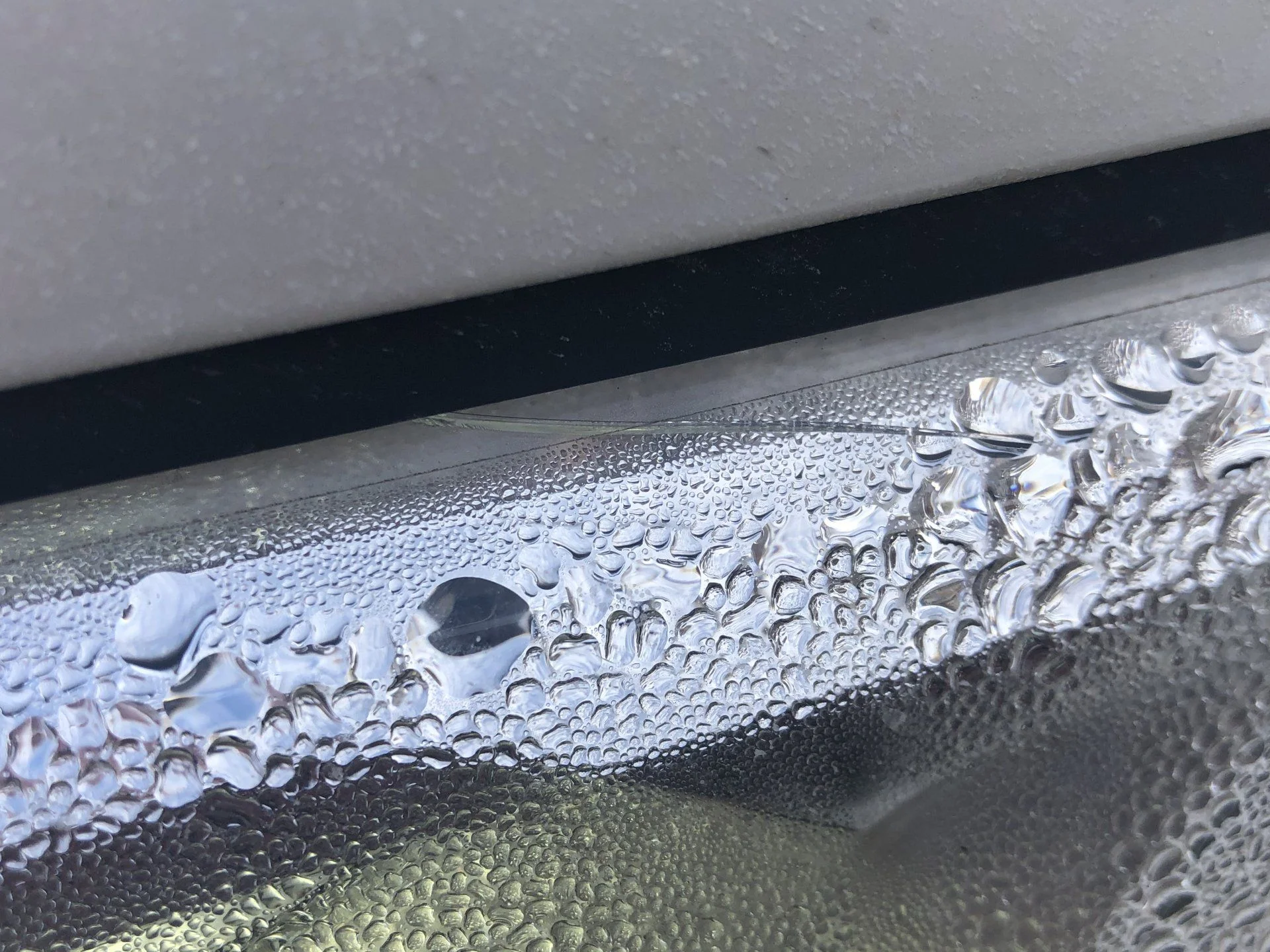

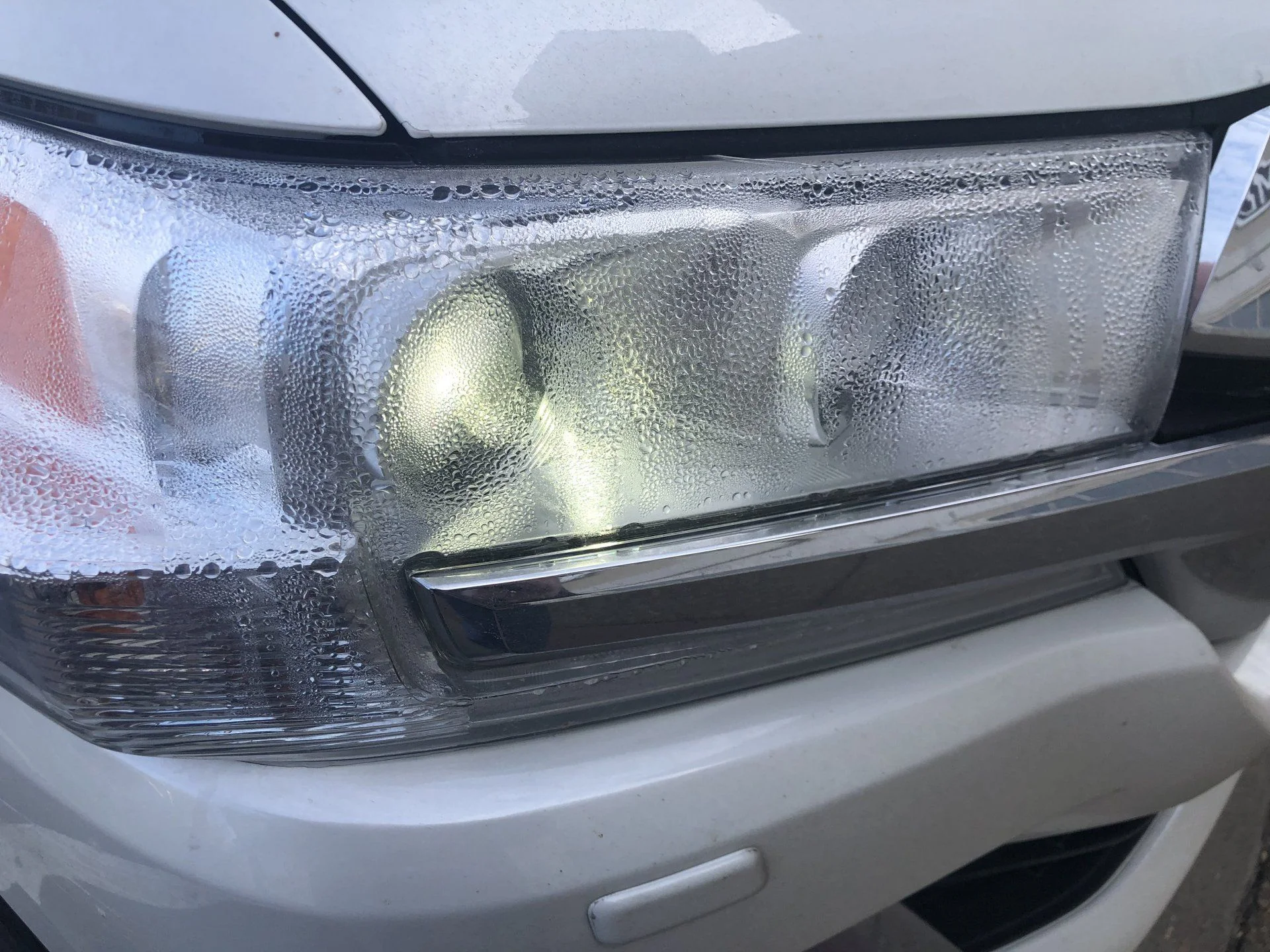

I recently hit a bird while driving down the road. I got out and checked the impact area which was right at hood level on the passenger side of the grill. At the time I didn’t see any damage. A few days later I notice condensation in my headlight. Upon a closer look i saw a hairline crack along the top of the headlight assembly.
The local dealership said that cannot replace just the headlight lense, and that an new assembly for a 2019 LC was $2100 plus installation. A google search didn’t provide much relief on a replacement cover except for a set from China ($200) that take 6-8 weeks for shipping.
I am thinking of parking it in the garage with a shop heater on it. Then drilling a hole in the top of the assembly and then running a hair-dryer to dry out the condensation before trying to seal up the light again before going the replacement route. Any thoughts?
Does anyone know of a good source for a replacement lense or are these meant to only be replaced with a sealed unit? It looks like 2015+ assembly‘s will work, so maybe I can source a used part from a wrecked LC?
HAs anyone replaced one? Is this something that is fairly easy to do (I assume you have to pull the grill and lower portion of the fender to access), or should it be done by a body shop?

The crack is along the top, about an inch long In the clear area. I actually had the entire front end wrapped in the 3M, and the crack is right along the top of the wrap. I honestly didn’t realize that the bulbs come out. I figured it was all one piece.

I would remove the headlight, leave it face down at home and let it dry out (should be nice a clear within a day without side marker and turn signal bulb. You can try attached in the garage as well (with the two bulbs removed) but would put a heater directed at the headlight. In current weather it may take days to dry out. When is all nice and dry, I would put clear coat touch up paint over the crack. It should seal the crack nicely and I would leave as is unless you want to go through insurance or pay out of packet $1000. I have not tried this before but windshield crack repair kit which comes with glass filler may work as well.
The crack is really small. I can’t even flex the plastic, but it’s enough for water to get inside.
o_O That's not just a little condensation, that's a lot of water on the inside of that housing.
Two thoughts:
- Judging by the amount of water, I would not be surprised if you eventually find another crack or two somewhere else on the housing
- Even if you somehow manage to evaporate the water out of the housing, it's going to leave a lot of residue on the inner surfaces and the light lenses
If it were me, I'd pursue an insurance replacement.
Two thoughts:
HTH
Agree that there may be another crack so removing the headlight for drying would be ideal as it can be properly inspected.
