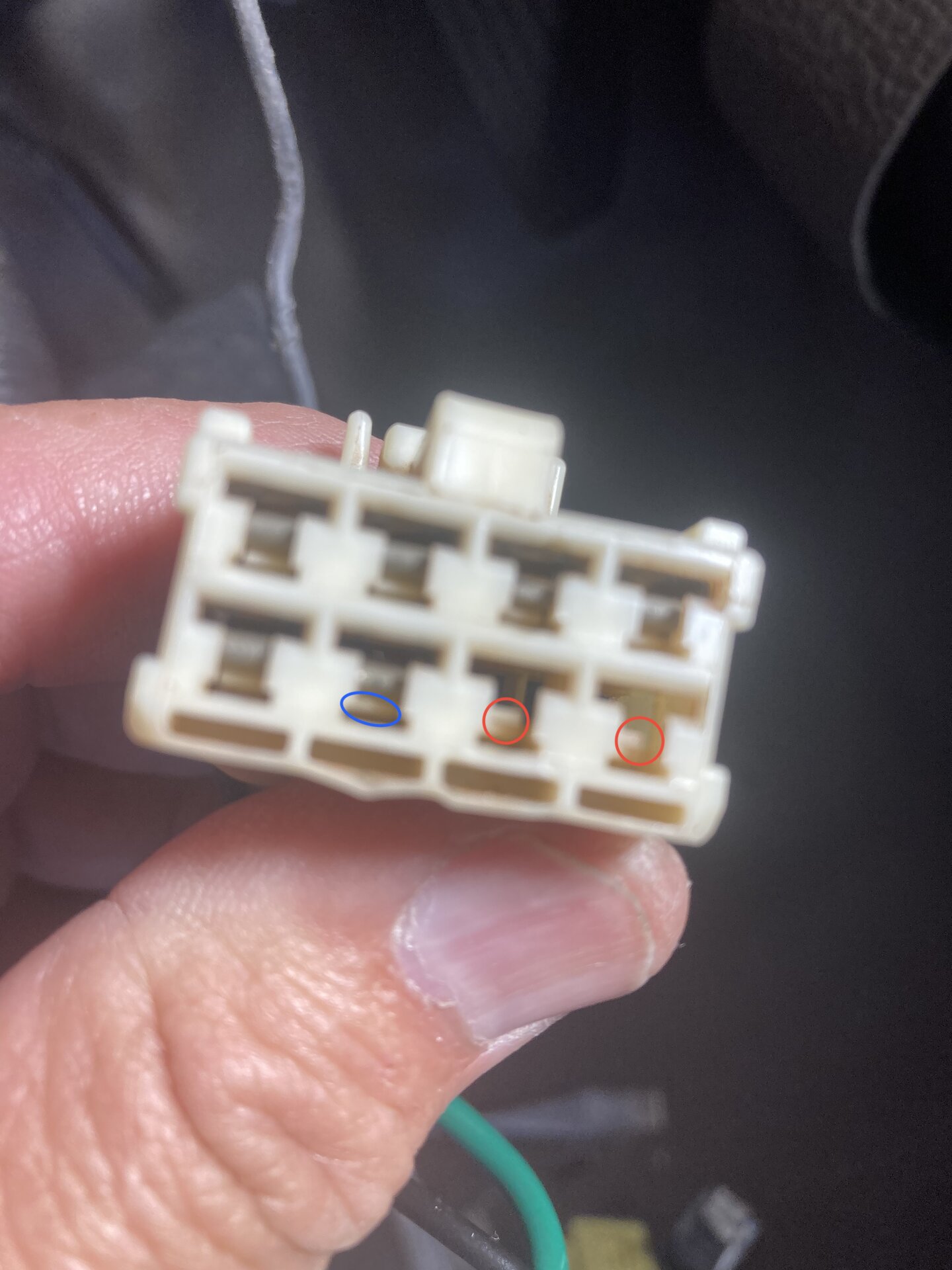

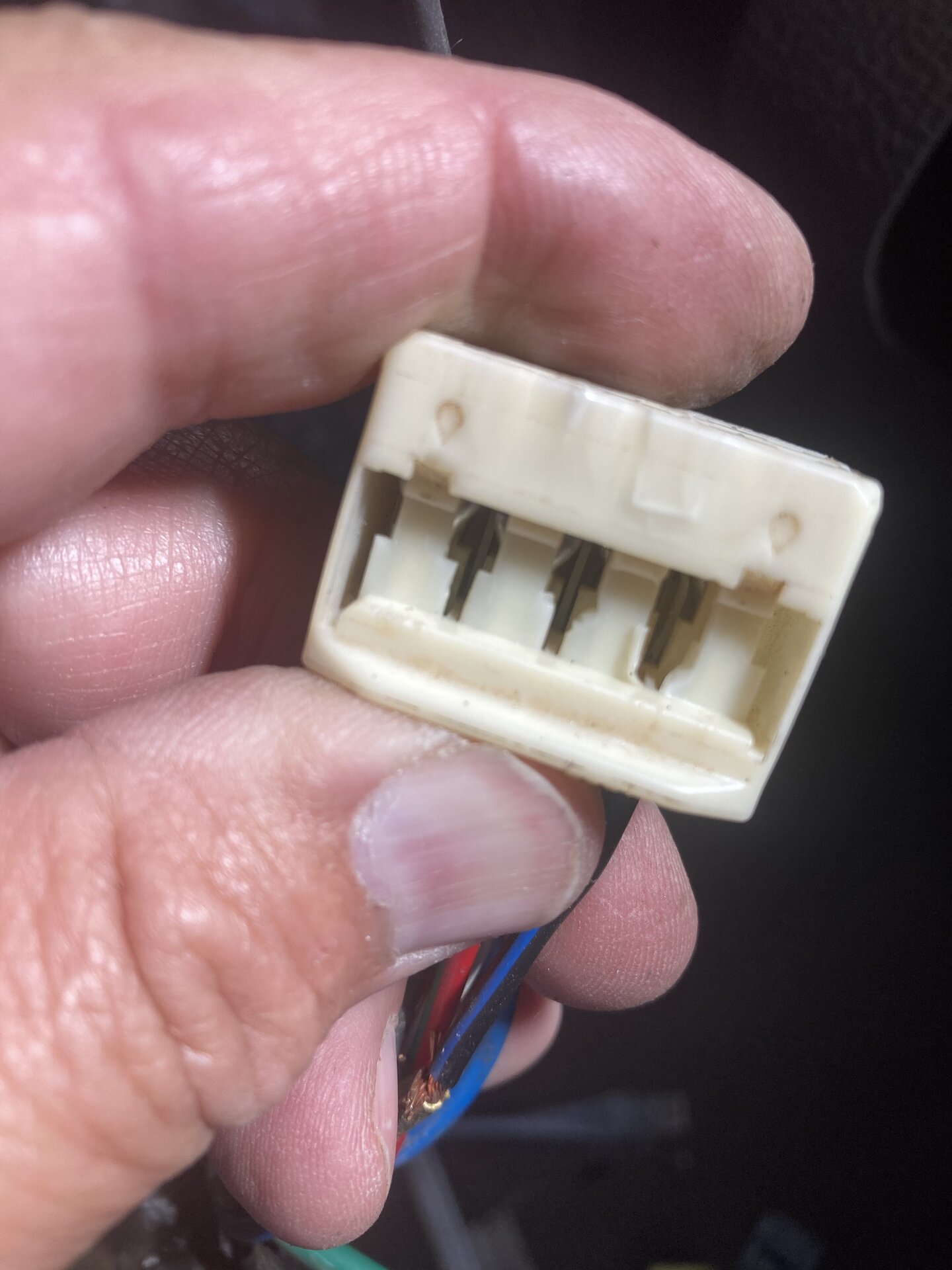

Get back to my build, mainly wiring up the dash, installing the cooling system and completing the AC system and she’s done. Doing a little “repinning” today and can’t figure out how to release the wires, already removed the retaining clip. Anyone have an idea? You can see the two ends still stuck in the connector
Anyone know how to pull these terminals?
Thanks Matt, now I just need to figure out which terminal type I have.
If you don’t already have a set of these get some as they are very helpful for this type of work

This video shows a cutaway of a connector. It shows how the tabs hold the pins in the connector and how to release them.
I copied your photo and added circles to the tabs inside the connector. The part circled in red is the tab that holds the connector in place. You’ll need to use a pin removal tool or something small enough to push down on the tab circled in blue. Like it’s shown in the above post.

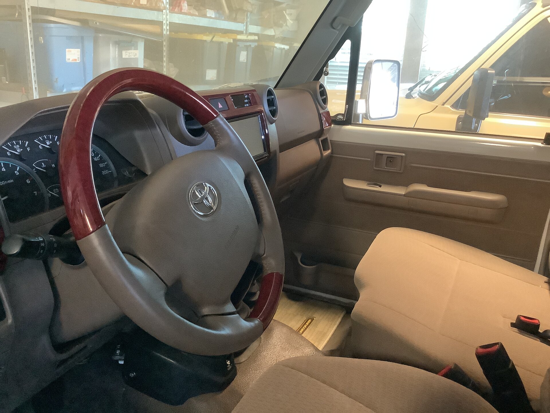

Your dash looks so much more tidy than mine… I may need another visit to learn from the master.
“When it cools down“ might be December here in central Texas!
Finished wiring up the dash, converted from RHD to LHD, addEd power antenna, microphone, USB port and rear speakers. Will wrap up the dash once it cools down here in Texas

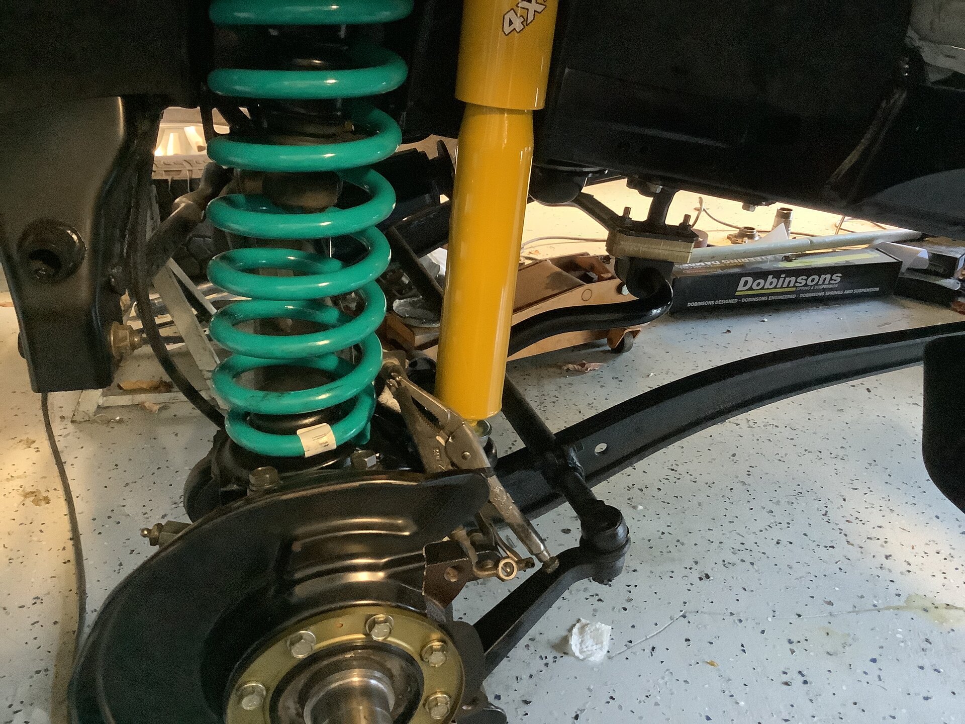

Updating the 79 build. Just completed the front axle rebuild, waiting on new OEM soft brake lines which have been on back order for months. Once I get the lines just need to bleed the brakes and clutch drop in a battery and fire it up.
Jeff, the soft lines are in stock on Partsouq!
