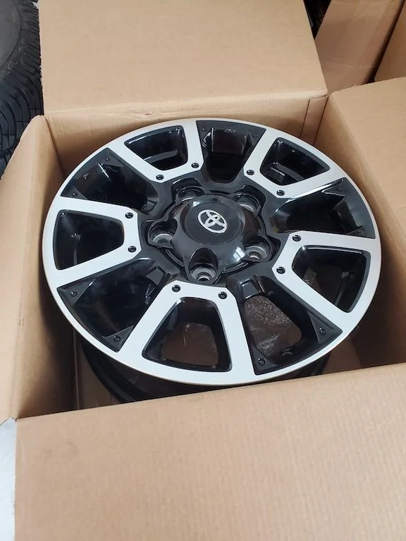

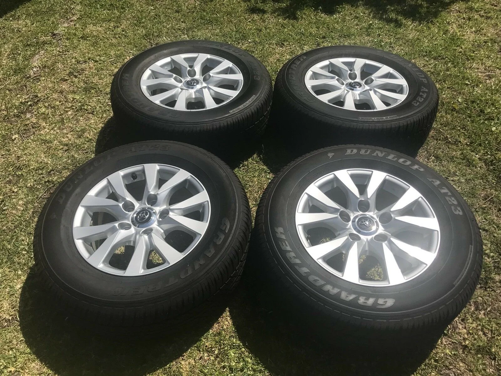

Hey mudders, I noticed that I have not seen any wheels from a 2017+ 200 Series on a 100 Series. Mainly the wheels below. Now I know why!
I researched and found that the hub and bolt pattern is the same on a 100 VS 200. I found some take offs from a 2019 LC so I grabbed them. Went to install and they fit on the rear, but not the front. They clear the hub, but the nuts on the flange interfere.
I think these are clean wheels that would look nice on my 100. Was excited this morning when I bought them. Lol.
Has anyone overcome this somehow? Any suggestions?

Wheel spacers. You are running into these issues because the hub bore is not totally open on that particular wheel. Getting some spidertrax spacers from slee will fix that. I run the spidertrax 1.25” spacers on my stock 100 wheels and the stance on the truck is infinitely better.

@atnolan94 Thanks for the response! When you say the stance is better, what are you referring to if you don't mind embellishing. Is this the reason you run them on your stock 100 wheels? This truck is all bone stock. Not looking to do much with it other than drive to work...Haha.
Yes, the bore is not open all the way through. Only the back portion which is what clears the hub. I was at America's tire so I am not sure by how much it's off.

@Maxthrust27 glad I'm not alone!!! It's frustrating because all the specs of the wheels are the same with the exception that the OEM take offs aren't a full bore...ugh! I really want to throw these on. Spacers seem to be the goto, but I've also heard the downside to them. My truck is all stock and currently drives sliky smooth.
But looking at these wheels, I just don't see a way. Was hopeful that someone here would bring something I didn't think of to my attention!!!

@Maxthrust27 what does the back of the wheel bore look like? Mine steps down quite a bit quickly...I'm not sure there's enough material to open the bore up and not come through the face of the wheel.

MaxThrust, tons of people run those wheels problem free...the issue with tundra wheels is usually the center caps won’t pop on because our hubs extend out through the bore in the front. That particular wheel has the bore all the way thru so they still bolt up. Just run them without caps or run wheel spacers. For you, there is a big thread that already exists called something like “tundra wheels on 100s” it is probably 20+ pages of people running tundra wheels.
I personally don’t have any issue with high quality hub centric spacers (BORA or Spidertrax). Have run them in many applications problem free. That’s your personal decision to make. I have wheeled mine as hard as (almost) anyone on here with 1.25” spidertrax spacers, and I used to run 1.5” BORA spacers, and have never had an issue to speak of.

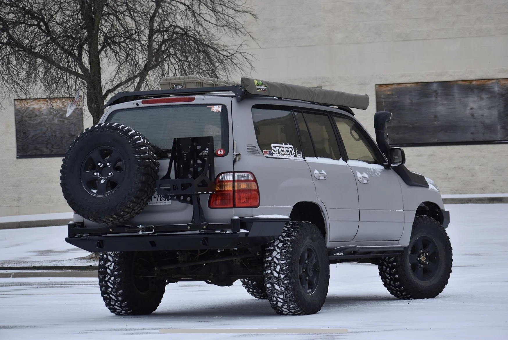

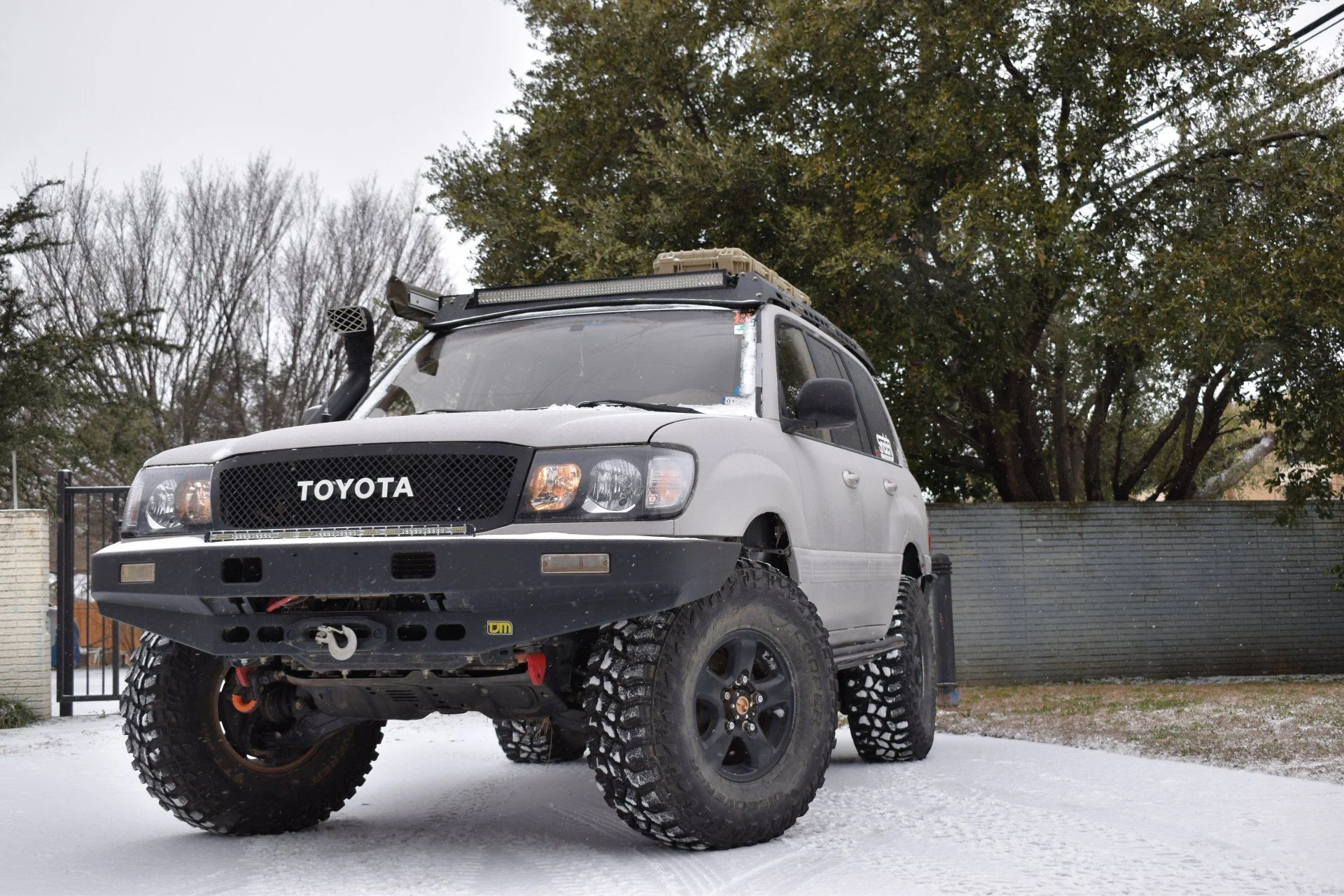

I run mine actually to fit my 35s a little better. In addition, I have always felt that the wheel track on the 100 was no narrow for the overall width of the vehicle. The wheels look sucked in pretty significantly making it look bloated and top heavy. The wheel spacers push them out and make the car look much better. Here is a picture of mine. It’s not apples to apples because I run a 315/75r16 tire but generally all LC and Tundra and Sequioa wheels run the same offset so the same principle applies.
For OP your issue is not just that the center caps don’t clear, it’s that the bore doesn’t go all the way thru the wheel, to it is contacting your hub studs. The only solution to this IMO is wheel spacers. And I’d guess you’ll probably need wheel spacers of at least 1.25” so the hub ring on the spacer extends all the way past the end of the hub studs. You could bore the wheel thru but them they’d need to be refinished and wouldn’t look right.
