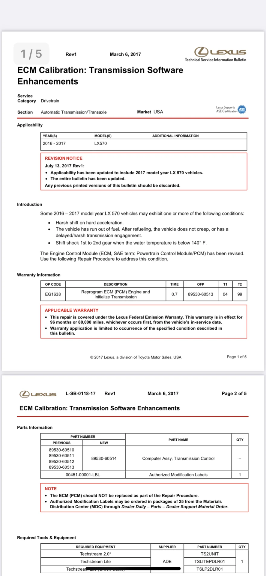

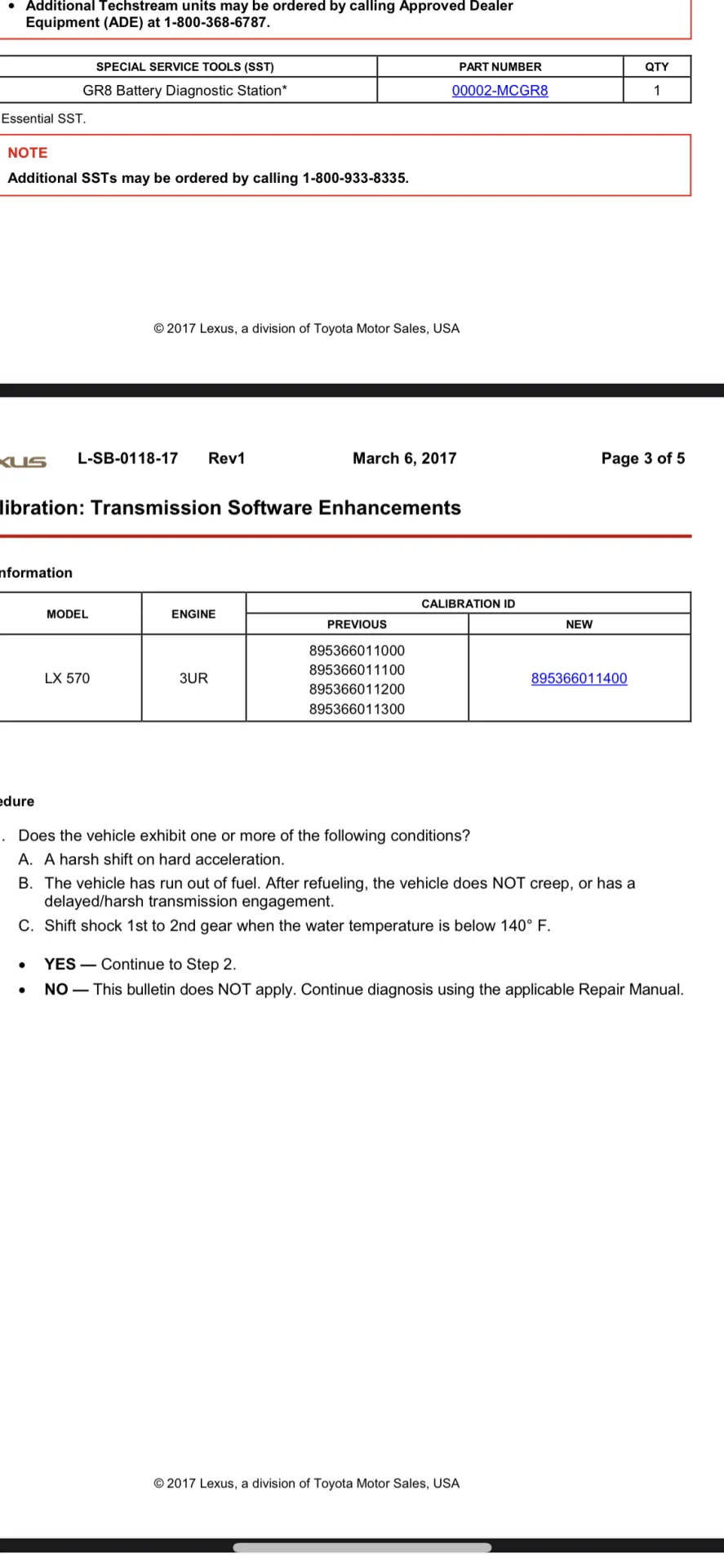

Hi everybody. my car lx570 is currently Shift shock from 1st to 2nd and vice versa. slow vehicle speed. Every time you accelerate, there's a knocking sound underneath. According to my research, my car needs to be updated with the ecu software. I downloaded the file from toyota's techinfo website but it seems that the parameters are not the same with my car. currently my ecu parameter is 895366013100. my car is made in japan, the vin number is: JTJHY00W6G4204379. ------ 89530-60550
can anyone tell me where i can find the right file for my car?. Thank you very much. in the attached file is a spec that i found on toyota's techinfo which is not the same as my current code.
