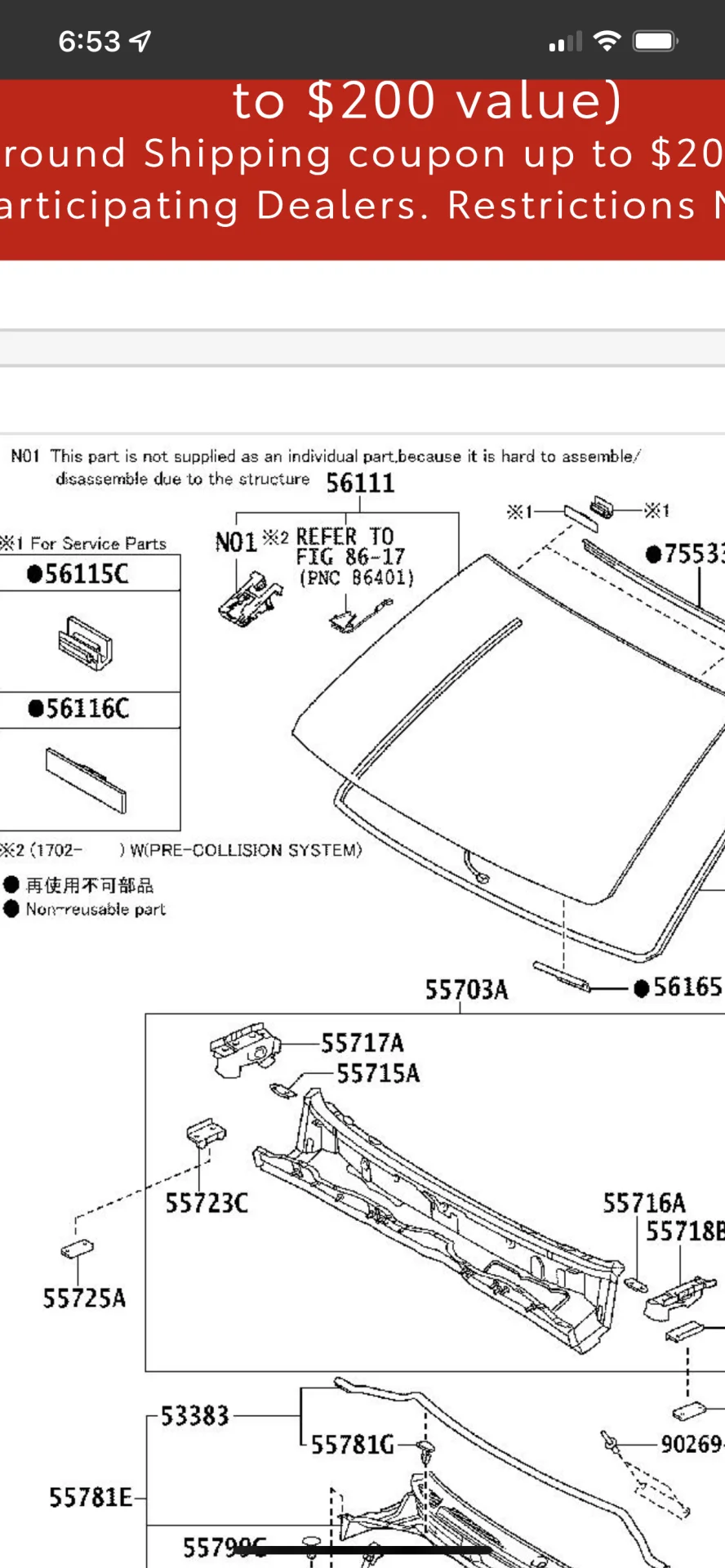

This is fantastic. It is indeed a 2015, I fat fingered the title and can’t seem to change it. Is the metal bracket a stand alone part or does it only come with the oem windshield? From what I think I understand in the parts catalog, that sensor/bracket only comes as one kit with the windshield. See attached screenshot
As far as I know it’s only available as an assembly with the glass panel.
You still have the sensor after it fell off the windshield? The bracket should still be attached to it. I don’t see a reason it couldn’t be glued back to the panel, but as mentioned you’d need to be careful about not adding any distance between the sensor and glass.
