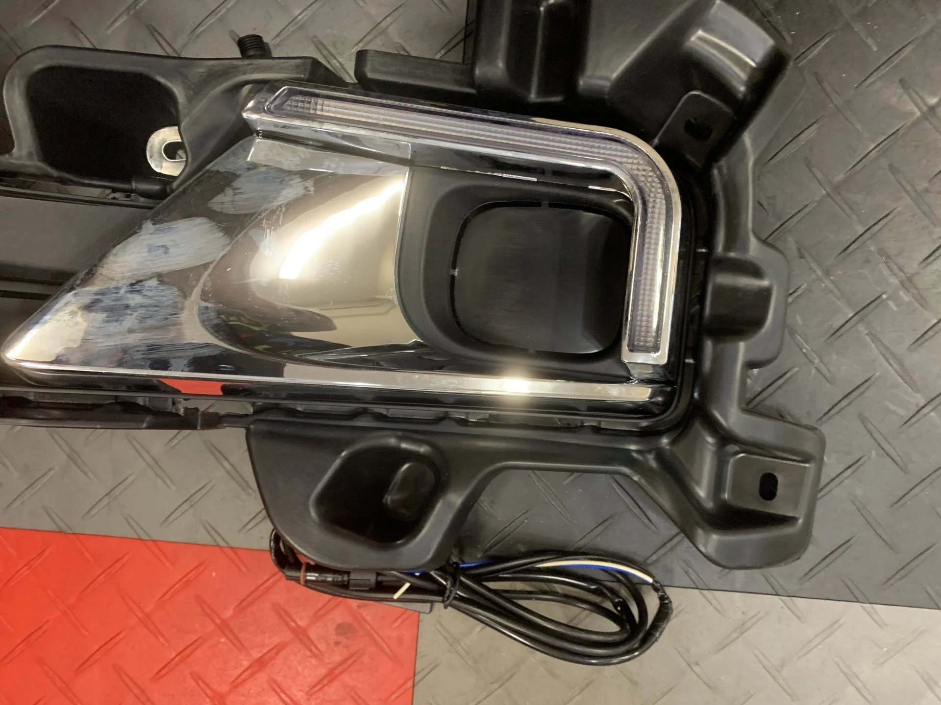

Many US buyers are unhappy that the 16+ LC doesn't come with DRL module in headlight like outside US and uses the low beam as Daytime Running Lights. I am one of those unhappy people. Folks investigated if there is a way to change that but no positive outcomes came out of it.
A little a year ago I was working with a company in Asia and bought a test unit which I have installed on my 16LC. It worked flawlessly and went with the LC when sold it. Just bought it 20LC and decided to add it again.
At that time I have installed the first I have received many questions / interest about it when share couple pictures so since getting single unit from Asia is expensive, decided to bring 5 sets and offer to forum members 4 sets at a discount (cover unit and shipping costs - shipping costs divided between the 5). Someone was selling them on Ebay for $300 which I thought is steep (Fog Lamp Cover With Light for Land Crusier 2016 LC200 FJ200 LED Yellow Turning | eBay but explains due to cost of shipment. They look like the truck came with them. Personal taste but like them better than running with low beam headlights.
If interested, please PM me. Anything not sold will go to Ebay soon and will be available there.

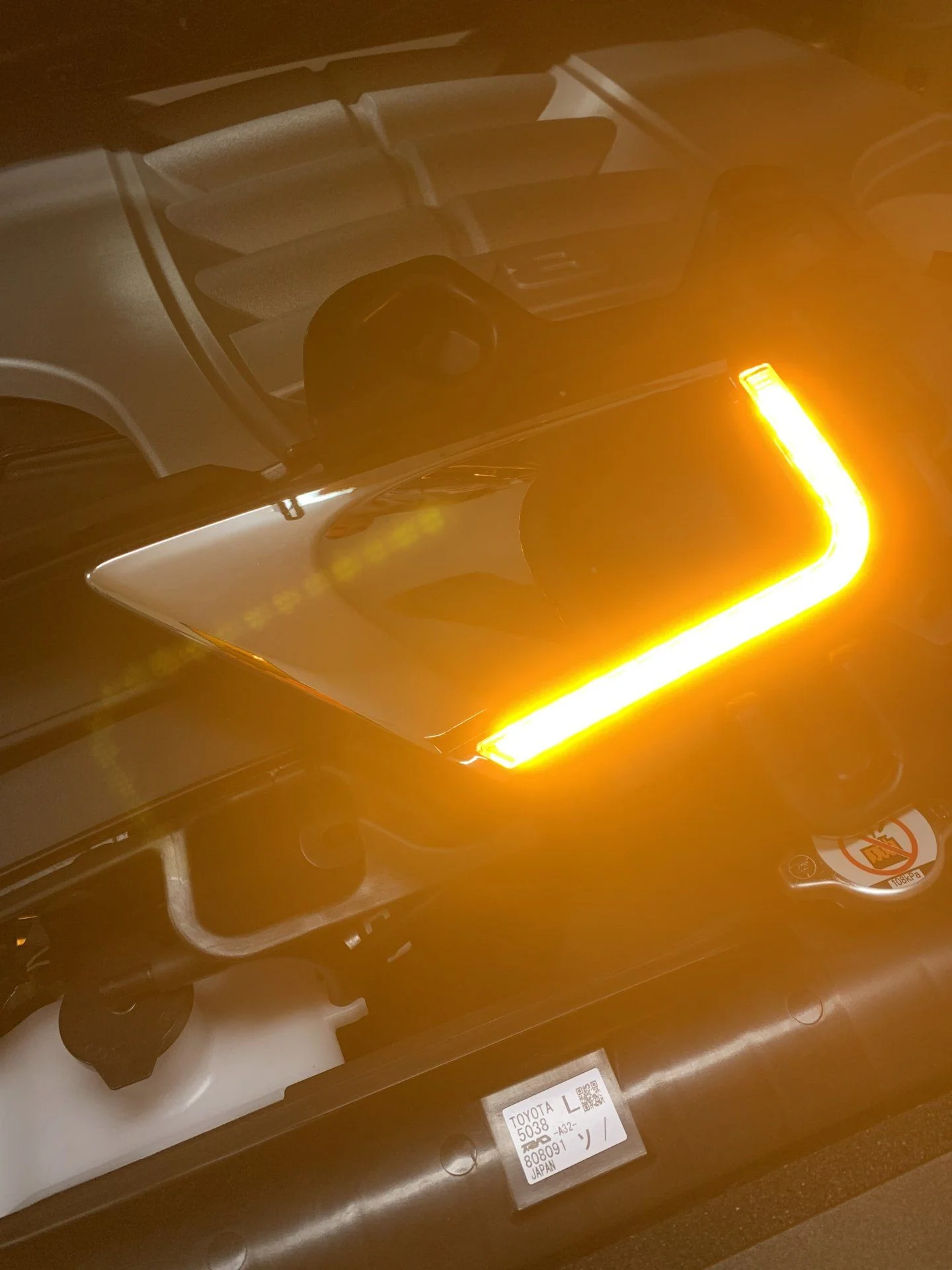

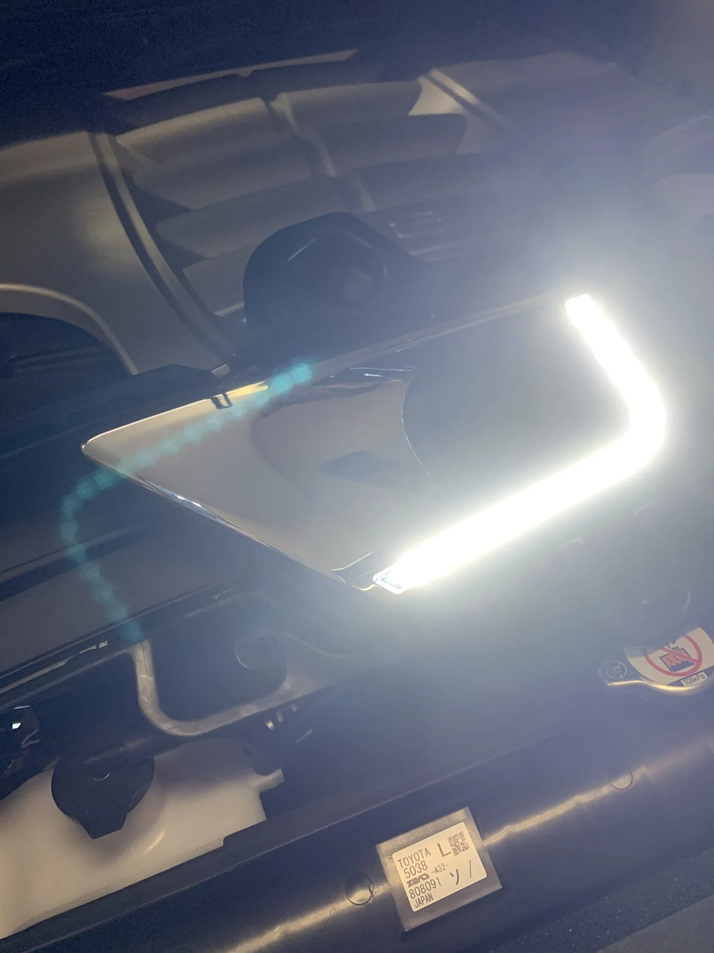

Lets deep dive what it does
I am using the module as DRL only, but it has as well yellow LEDs. So you can use either color as DRL, or yellow as turn signals, You will need to buy a Relay system to connect to the car. I am using one from amazon (link below) but changed the switch to Toyota one (got it for $6-7 OE on Ebay).
Amazon product ASIN B01MY2L7R3

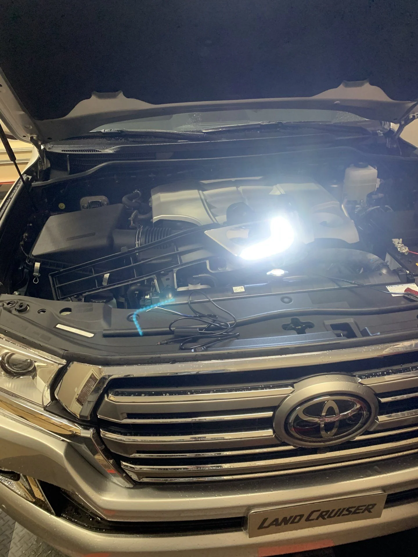

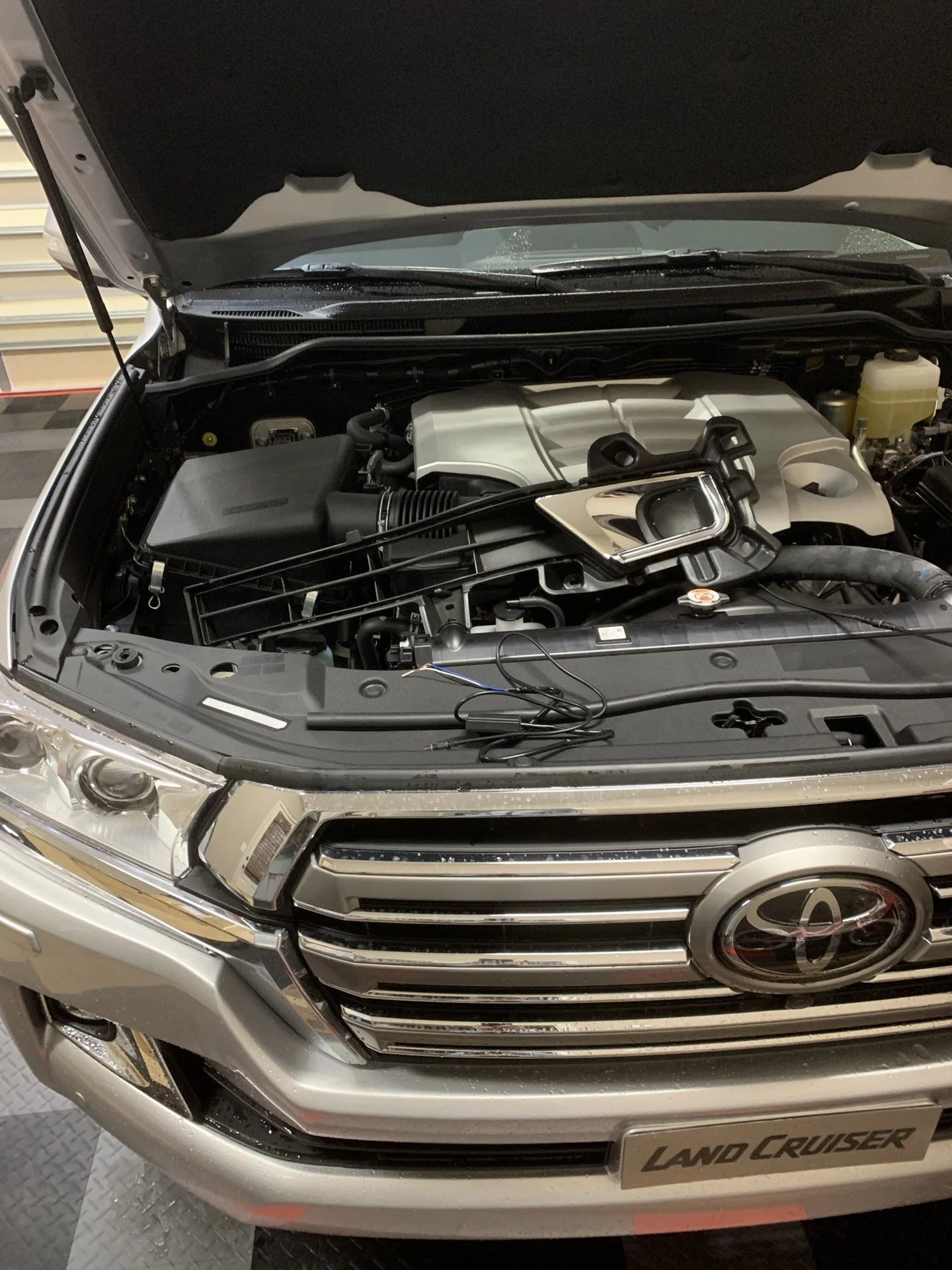

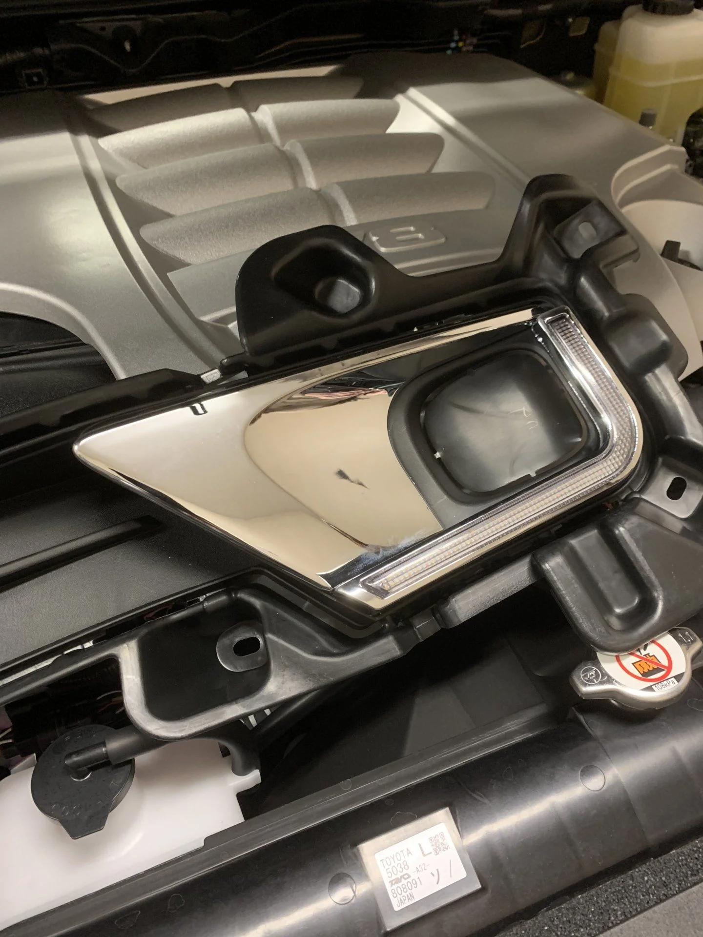

There are two ways to install it. You can replace the whole insert you see in pictures OR just replace the chrome piece to the one with LED and drill a hole behind it for the wire. I went with the latter option as didn't feel like spending extra 30 minutes removing and putting back the bumper. After that you connect it to the relay and connect the relay to the car.

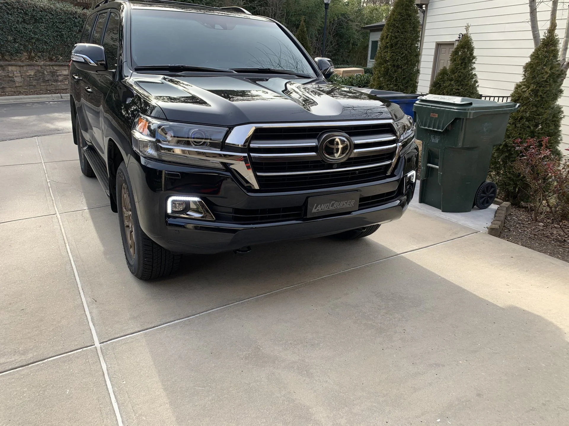

Sorry, just got 21HE replacement on which have put a set and left one set as a backup. I don't see the supplier I got it from selling them anymore (don't see anyone selling them anymore) but can hit him up to see if they can procure more but it would have to be a higher quantity (a group buy) to be worth bringing them over. The shipping costs are too much now. I was able to get cost down to $140 with shipping per set as bought multiple sets. Here are couple pictures from my latest install.
