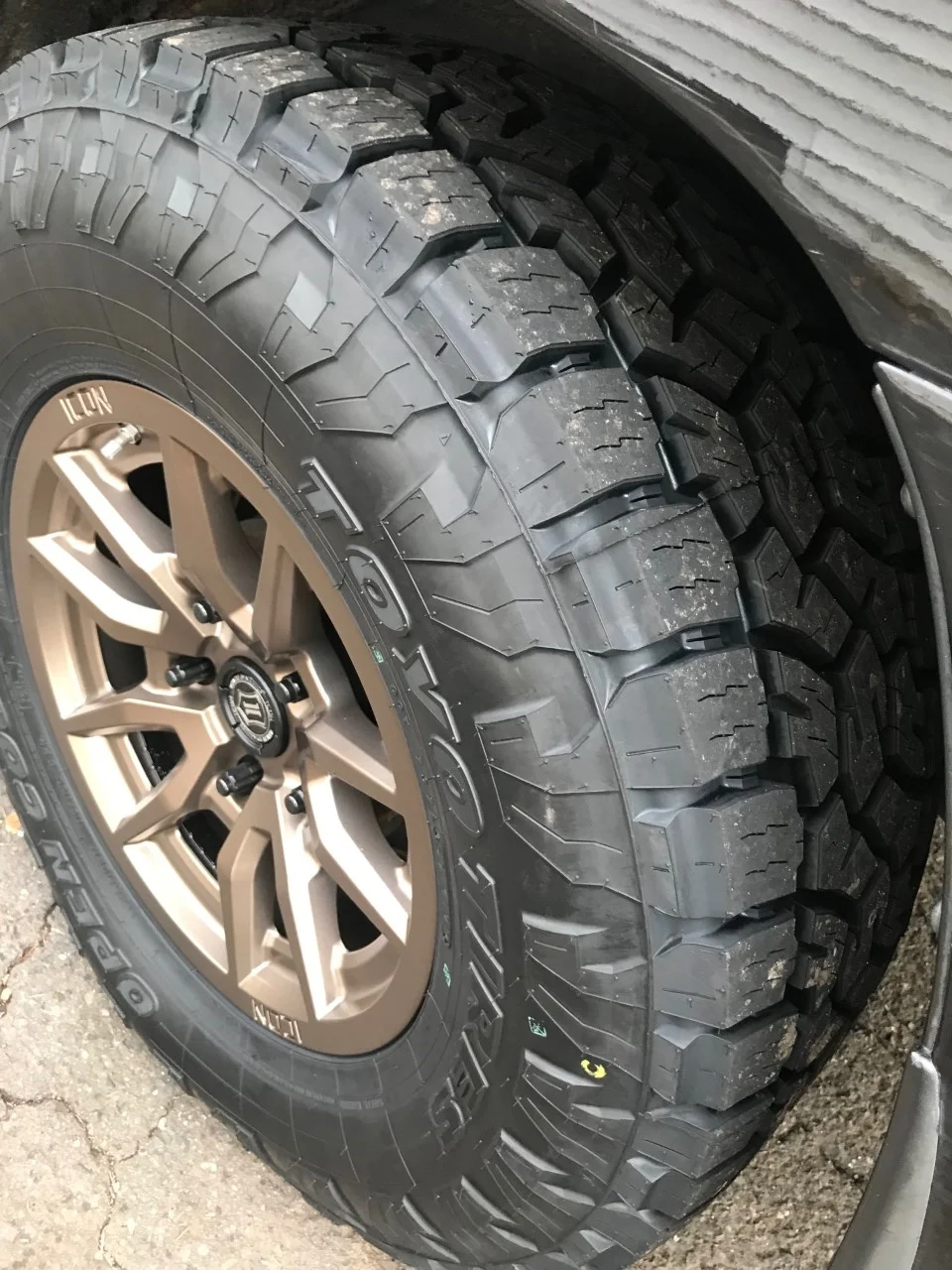

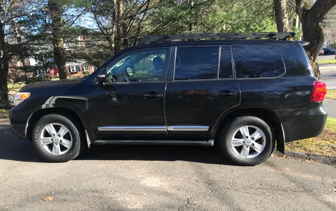

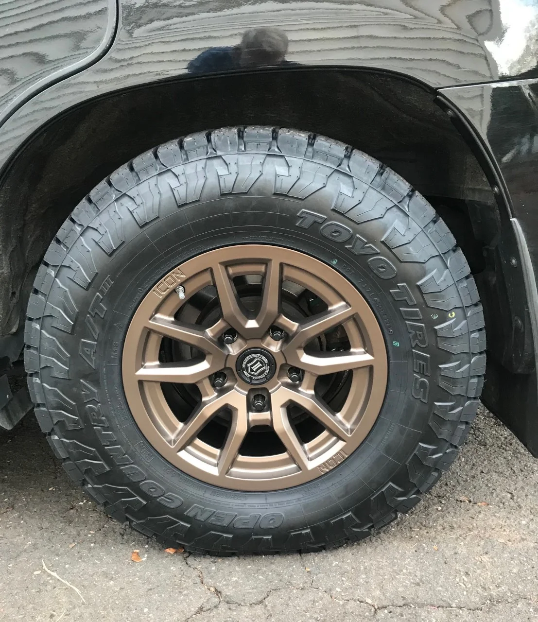

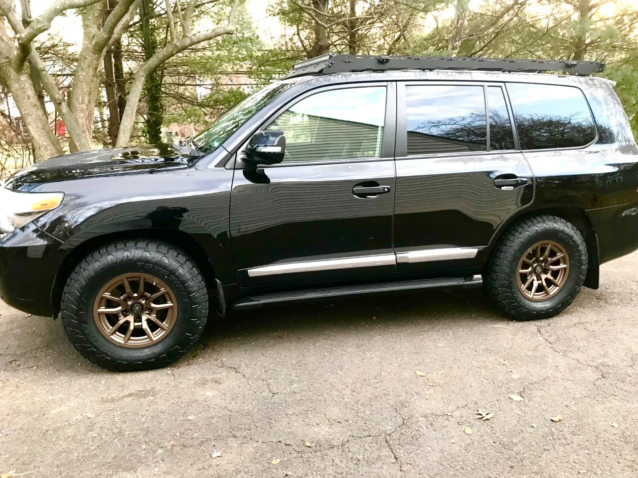

I finally upgraded from OEM wheels and tires to Icon Vector 5 +25mm offset and Toyo Open Country ATIII 285/70/17C
The 285/70/17 has the same width as OEM but the height is 1.25" taller! The only rubbing was on the front mud guards which I removed.
I also upgrade the spare with the same wheels and tires and it fits underneath with no issues.
View attachment 2881700View attachment 2881701View attachment 2881702View attachment 2881703
Looks great. Stock height?
