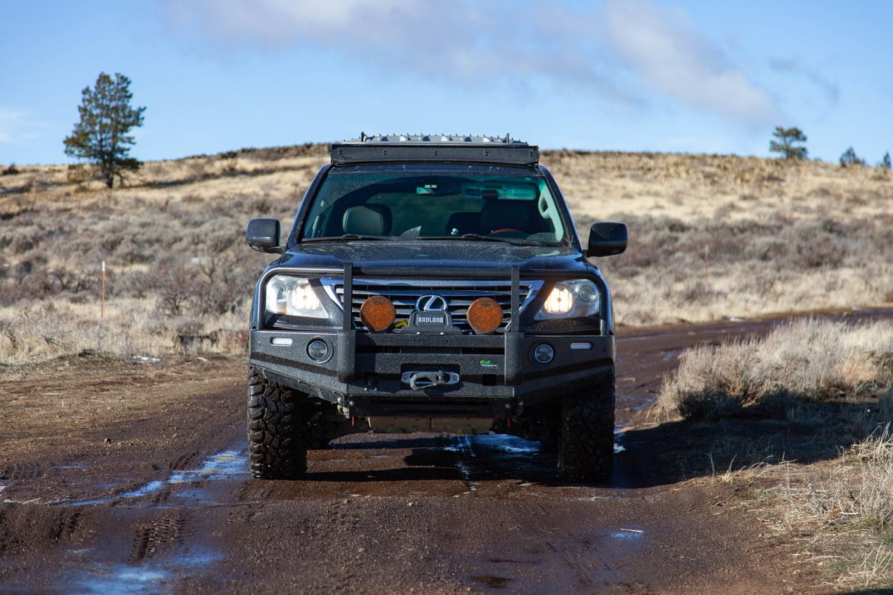

I bought my 13 LX with 106k and it now has 130k. I have added a FrontRunner rack, Front and Rear bumpers from Dissent Off-road, Slee sliders, and a custom drawer system. I run 285/75/17 KO2s on ICON wheels.
The truck is not my daily driver, but it does get driven quite a bit and has been on many trips on and off-road. I don’t wheel as hard as some folks but certainly harder than most LX owners. i just completed a cross country road trip, with me, the wife, 2 kids, and a dog. We logged over 6k miles on the trip with temps ranging from 5f to 90f. We saw lots of snow and ice, tons of rain, and plenty of bright blue skies.
Even with all of the mods, the KO2s, and all the off-road adventures, the ride was excellent and comfortable. It still drives like a new truck. I just took it in for a post-trip service and it got a clean bill of health. I would get in and do the trip all over again without hesitation.
As far as MPG, I don’t really keep up with it too much, and on this trip it would be hard to say what the overall average was, but under normal driving conditions in the flat Midwestern states, I was getting over 14. Keep in mind that is with a tailwind and using cruise control on the interstate, but it was also with a roof box on top. If I were guessing, I would say that my average was around 12 for the whole trip.
If the truck you are looking at has no signs of fluid leaking anywhere, and has had regular service, it is likely to run without major problems for many years.

This is a great angle on this bumper. Sweet look!
ARB Sahara front and Slee rear bumpers are on the like to have list and part of Phase 2 build along with Slee sliders and skid plates.
Most of my bolt-ons are aluminum, and I’m a heavy pig. My guess is that the steel arb/slee will net 300+ pounds over aluminum.
