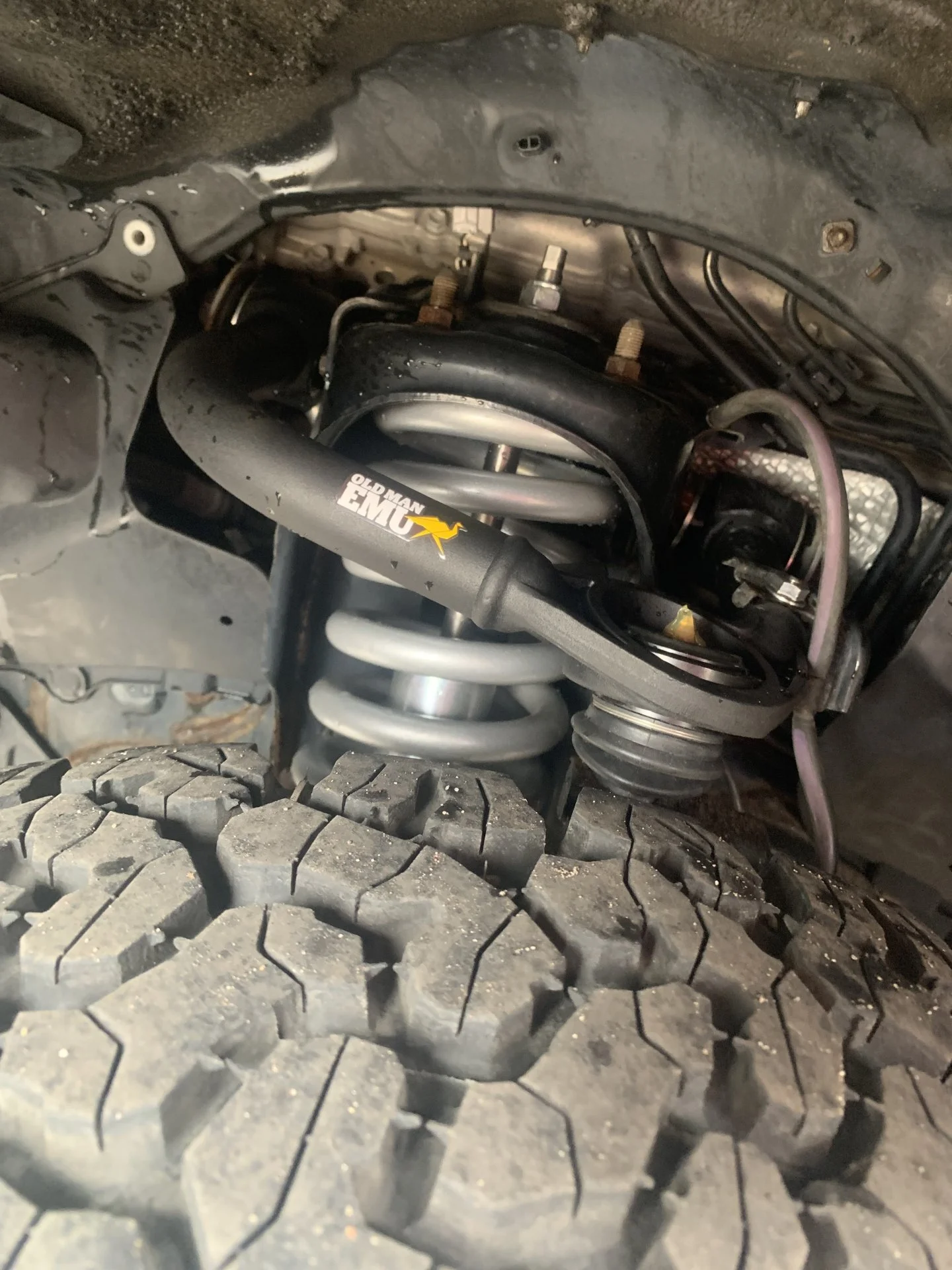

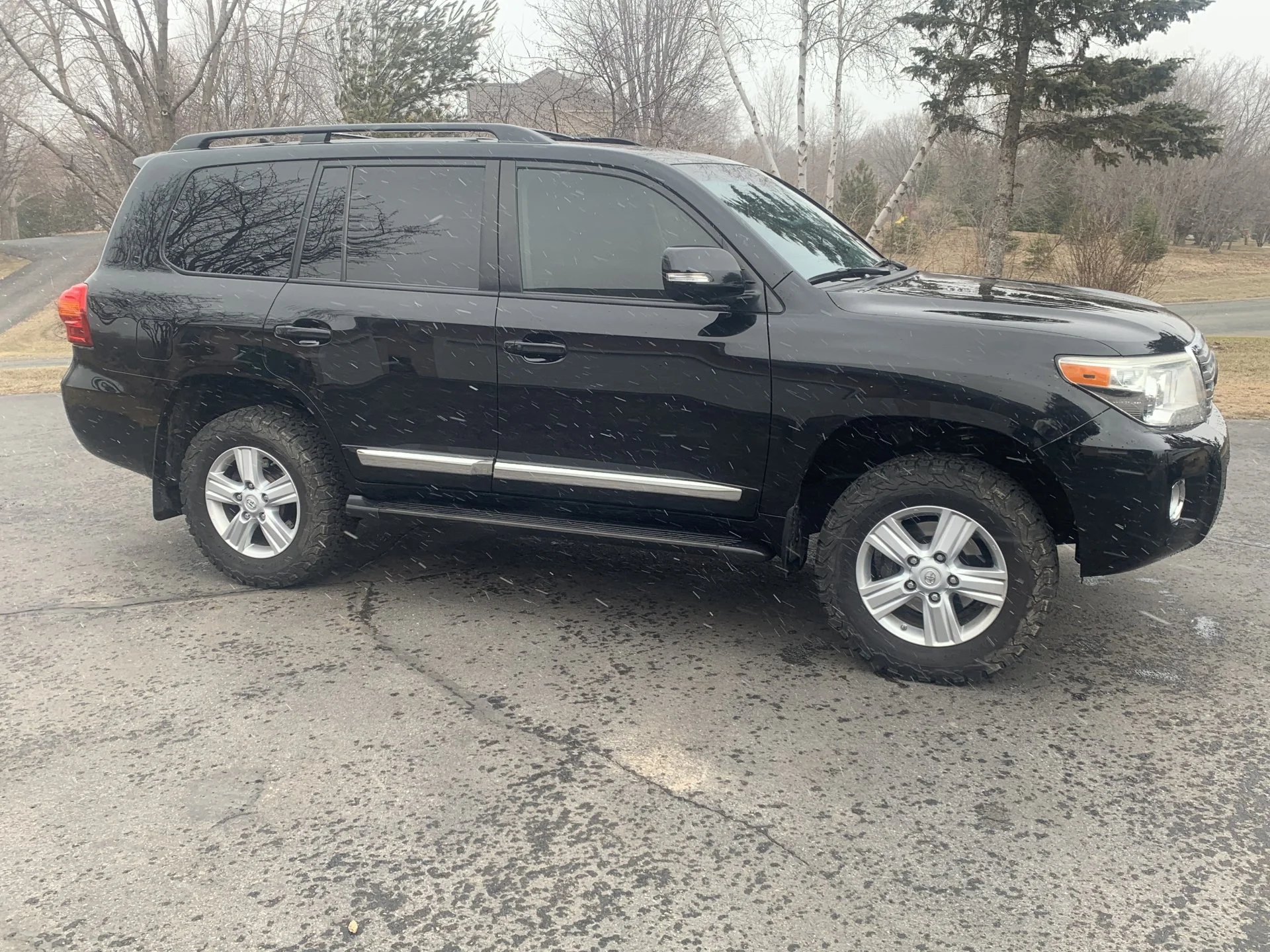

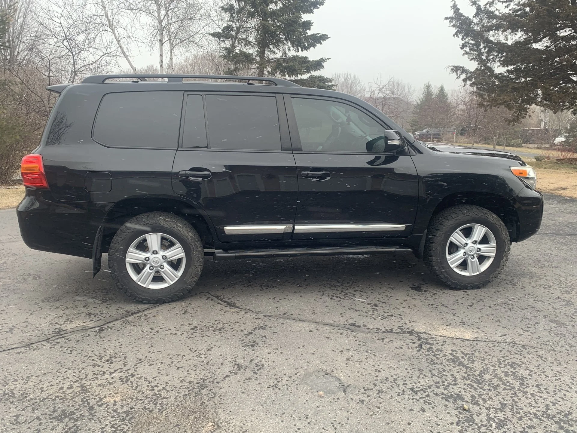

Just got the LC back from the shop. Took them two days to install.
Got the Eibach Pro Lift Kit Stage 1
2.5 inch in the front, 1 inch in the back.
OME UCA
SPC Rear LCA
Total cost was around $2800
Eibach $900
OME UCA $550
SPC LCA $250
Plus install $1000 & tax.

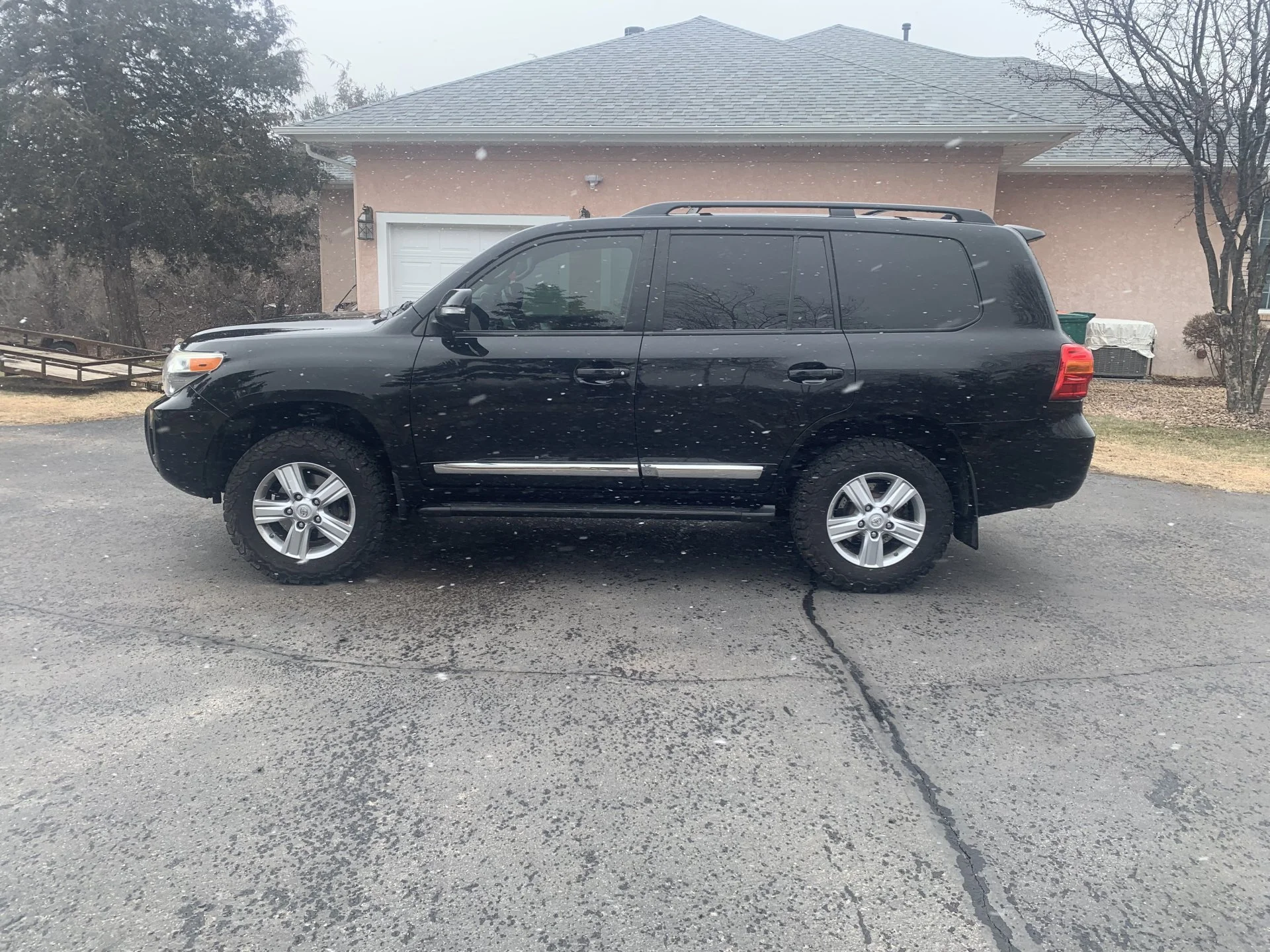

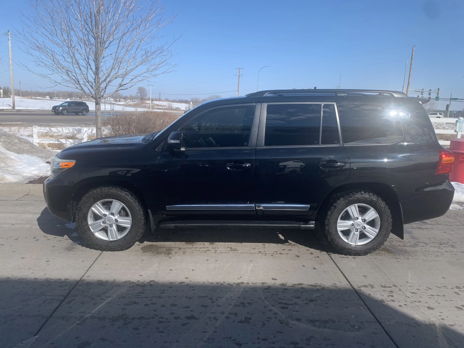

Before Photo
After Photo
Big difference in person. I like it a lot.

Looks great. I’d get the caps on your OME uca’s though. Helps keep the gunk out of the grease zirk fittings.
edit: FYI, you have to remove the zirks to get the caps on.
Looks like the shop did not put the caps on.
I’m gonna have to go back and get it done.

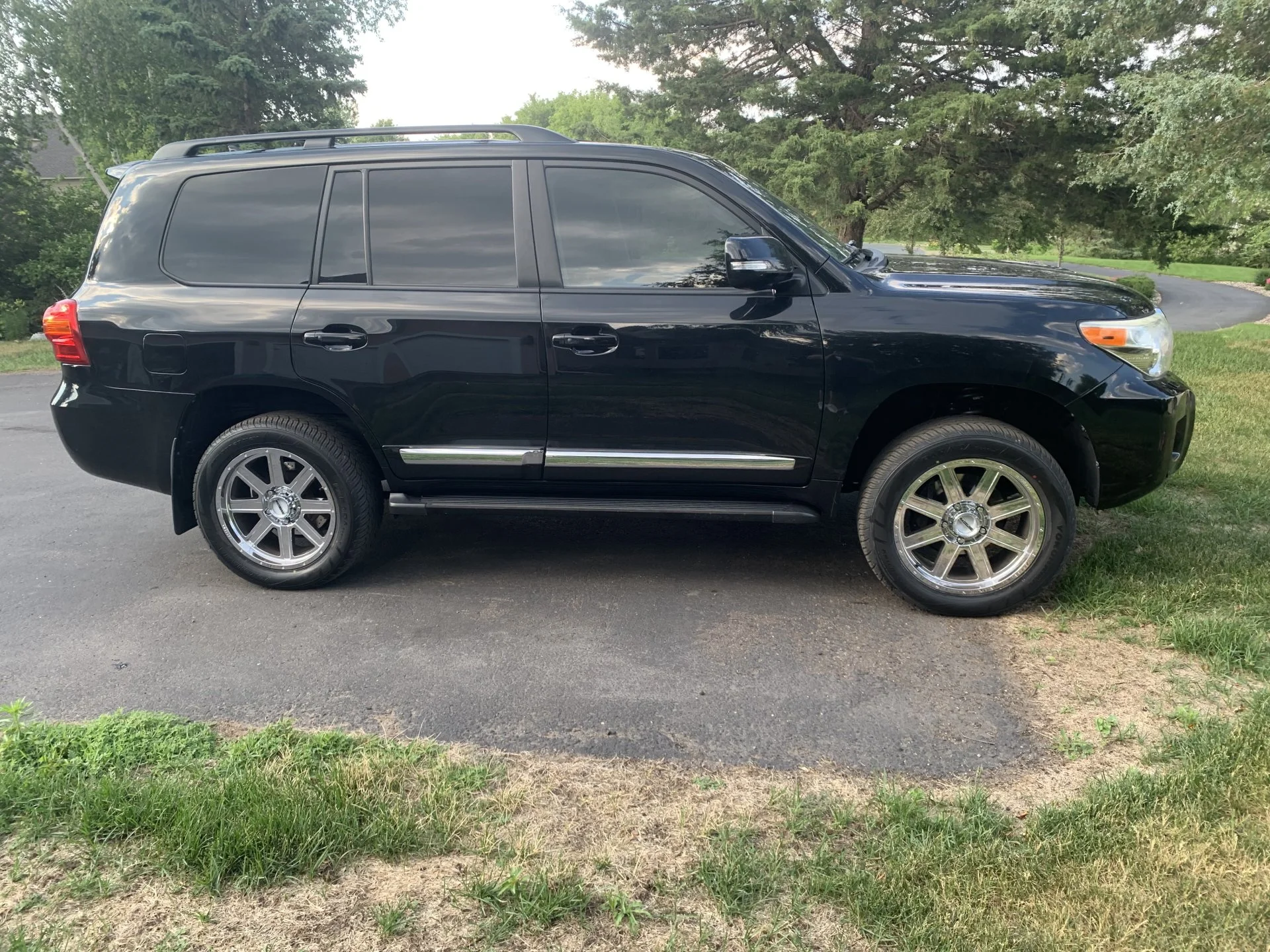

Yes there are different notches where you can adjust the height.
The shop asked me if I wanted the 1.7 or 2.5 in the front. I said give me the 2.5
The ride is definitely different. Car sits higher. No more hard nose dive when you brake.
Pictures don’t do justice from stock to OEM. There is a legit noticeably difference in person. Car just looks so much more manly hahaha.
I got two compliments already at the gas station and at the shop.

Ride quality is greatly enhanced
No more nose dive from braking. You can take corners faster without feeling like your going to roll over.
Plus it just looks so much better. I get compliments all the time how much better the suv looks.
This is with 20 inch Raceline rims and 285/50r20 Yokohama Parada Spec X
Performance tires. Absolute no rub.
