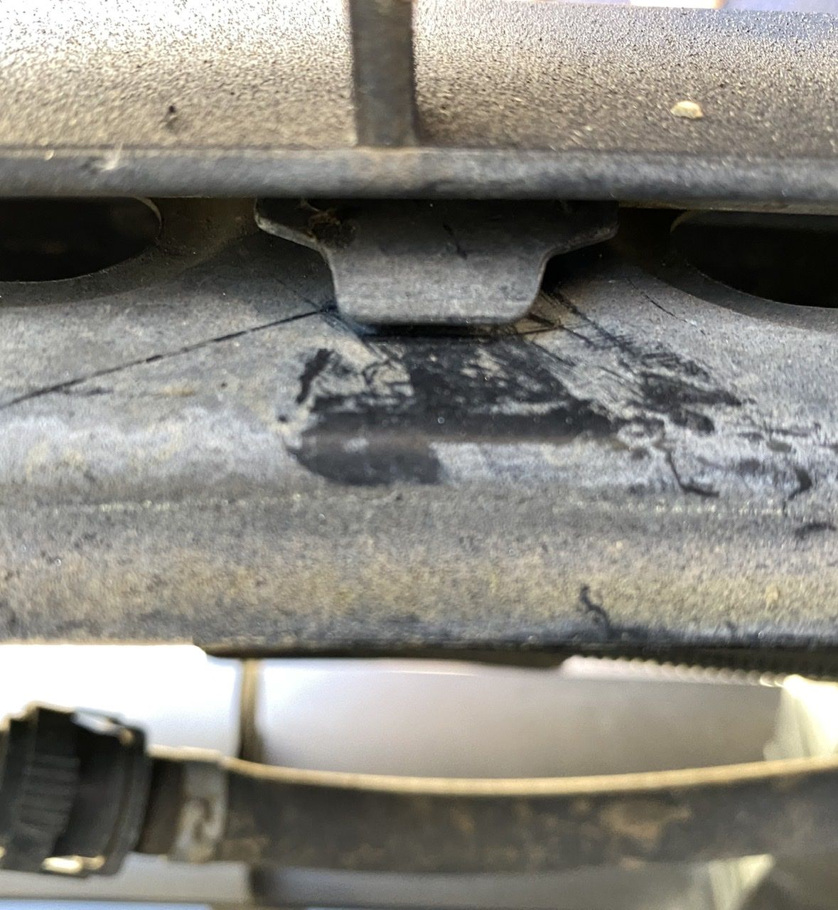

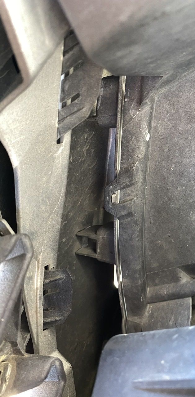

Yep did all that up until release the tabs. I think I’m releasing them but not sure, nothing clicks. Again I must not be pulling hard enough

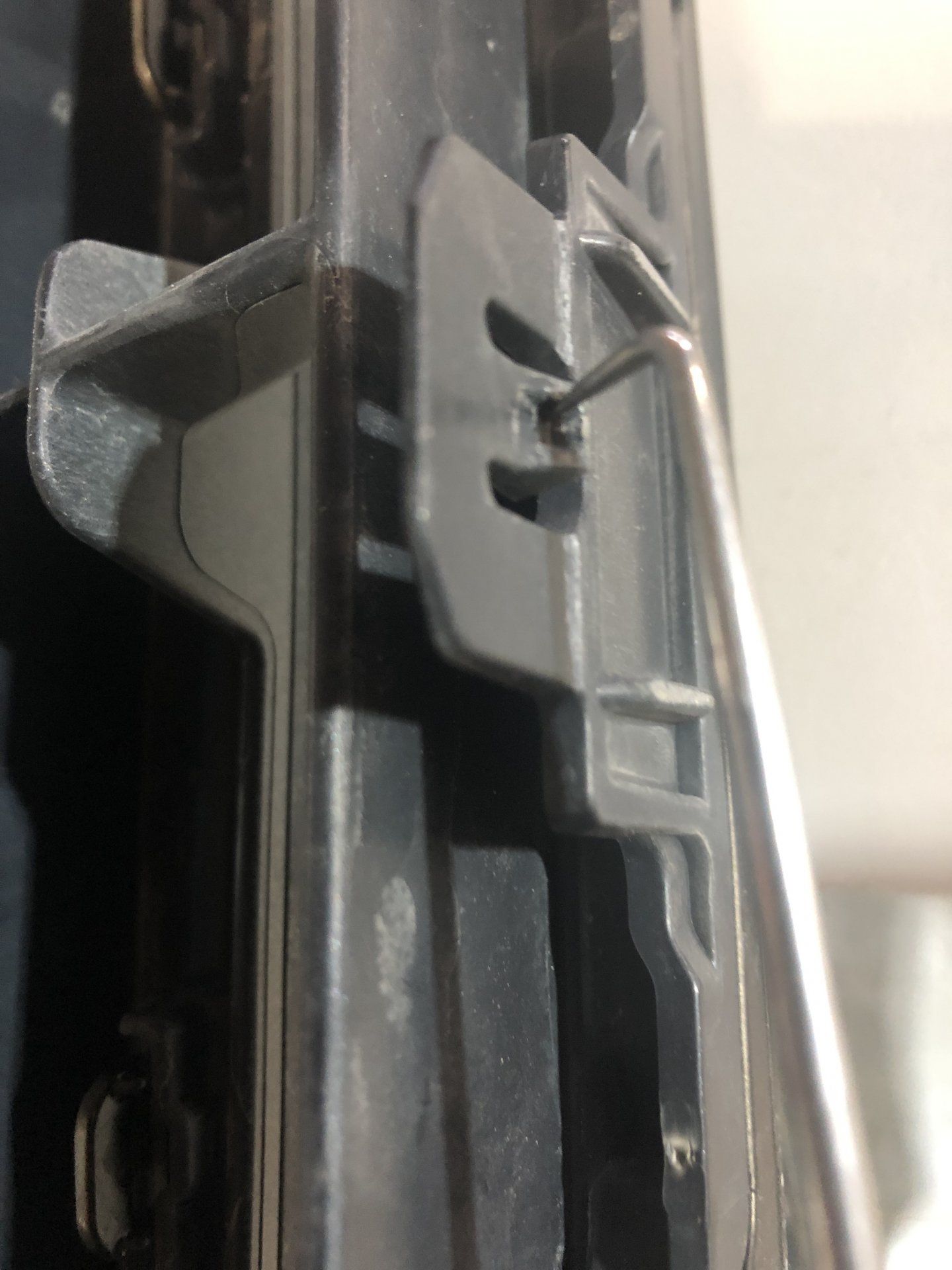

Check my thread linked above. Pictures of exactly where to push with a screwdriver and the process to get across. There are two or three on the left you cant get to but releasing the rest will get you far enough to just pull on those.
If you take a small 90 degree pick, insert under the tab with the short leg horizontal then rotate it 90 degrees upward toward vertical, it will push the release tab enough to release the grill.

So where do you press on these over under?
