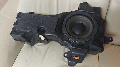

I just priced out stock speakers on my lunch break, and it's pretty spendy. $270 for 1 OEM 6x9 door speaker, $520 for a OEM sub. I honestly think at that price range, I'm going to go get a quote from an audio guy, Eric Sargent the GM from the local Toyota dealership recommended to me.

So are you saying that once I get a rear sub hooked back up. Then the 6x9's in the front doors will pushing more sound to the entire cabin, am I understanding that correctly?
No. 6x9 in front door (if using stock amp and connections) will ONLY get bass signals…with or without subwoofer in cargo.
No, he is just saying that the system is tuned to use those 3 drivers to produce bass, they aren't linked in any way. . Adding the sub back is the first thing i would do if I was in your shoes. See if that "fixes" the balance well enough.

I would definitely go the used route. Maybe check eBay.
I actually just found that sub and added it to my "watch list" before you posted.
