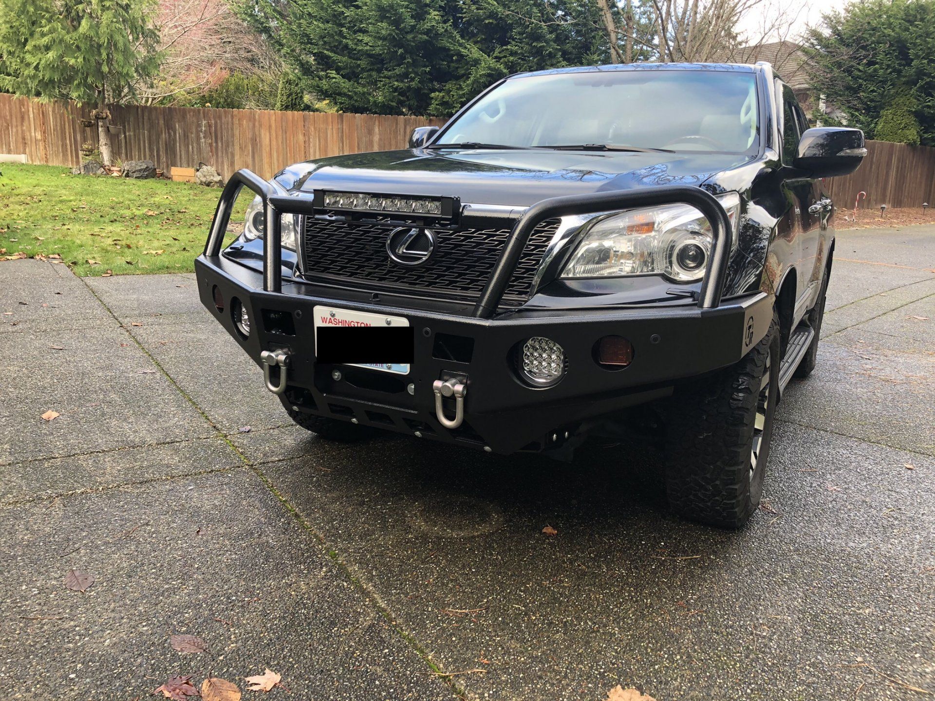

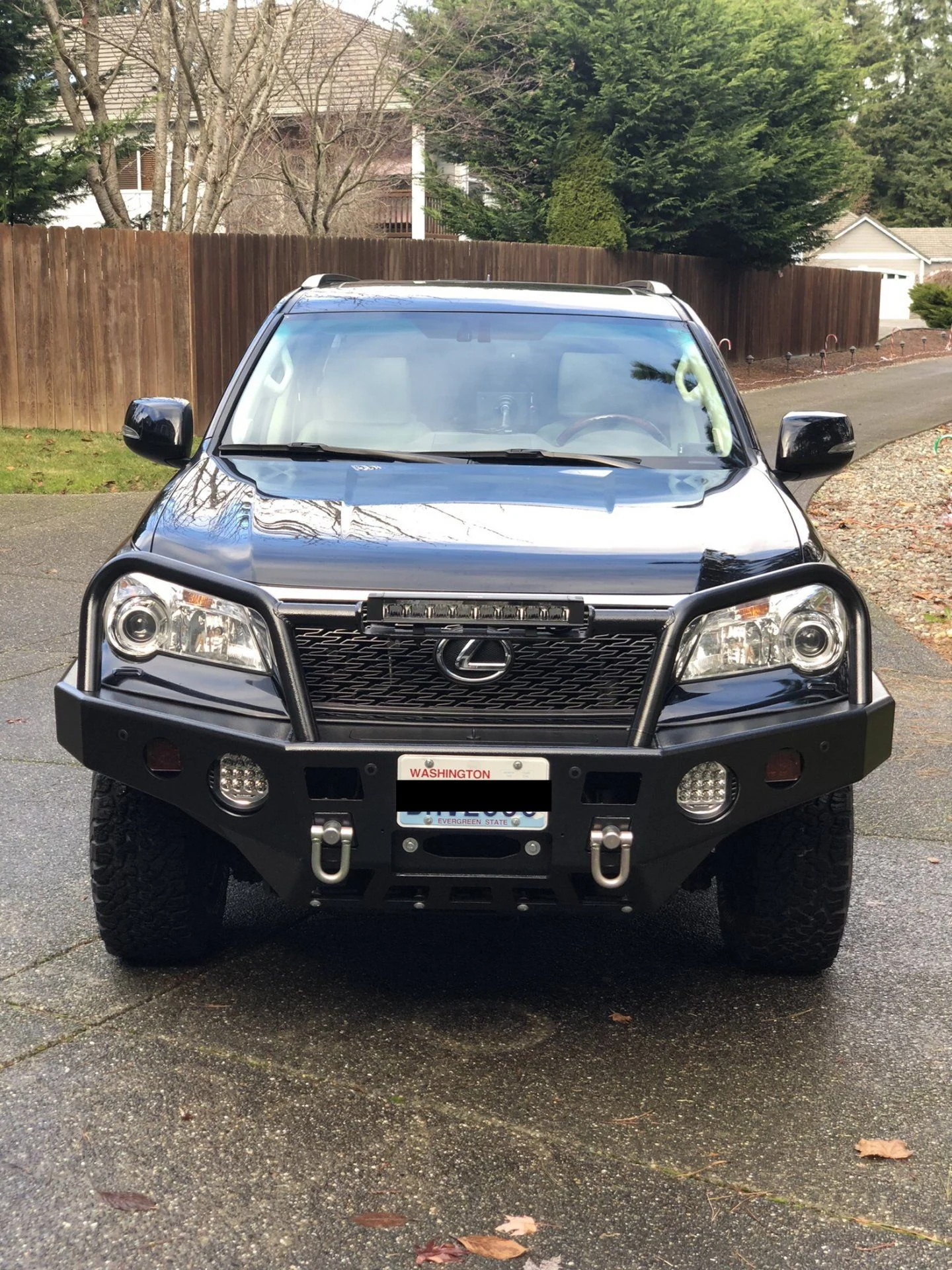

So I finally picked a company (Trail Ready) for a front bumper and they were able to slightly alter their original configuration to accommodate, and retained all the options I wanted.
  • Retain headlight sprayers (because the location of the cut stock bumper retained them)
  • Retain parking sensors (this is change from their original configuration and I supplied aftermarket flat sensor bezels)
  • Use of aluminum for rust resistance, and potentially lighter weight. (Winch cradle and hoops are steel, main bumper body is aluminum.
  • Hoop design for protection
I went with the Trail Ready bumper for the above reasons AND because I was able to go to their location and work with them. (They took measurements for the park sensor locations, and verified the headlight sprayers would work without modification).
I had them perform the install, which did require adding some wire to the park sensors at the corners.
I will say the process had very few hiccups, but all worked out in the end. I’m very happy with the end result:

The tube guard (steel) is actually bolted through the aluminum main bumper body with some rather large bolts. With the threaded part inside of the tube. The aluminum bumper (I’ll have to check thickness) is then bolted to the winch cradle (which is steel). All bolts are carriage bolts that go thru square/rectangle holes and are captured by large lock washers and nuts. This allows for adjustment which can be a pain, but also a blessing to align at the same time.
Edit:
[All plate (Aluminum and steel) is 1/4” (.27” with powder coat). Even the top winch cover door.]
As far as weight savings, I don’t think there is much compared to the Ironman or ARB.. as they said it’s about 135lb. (I personally didn’t measure) with the tube. I guess the nice thing is one could order this bumper without the tube. Currently I have stock suspension, and I think I lost about 1/2”clearance measuring wheel center to fender edge.
I can take more specific images if anyone is curious about something.
One thing I learned is that 18” PIAA light bar (which is what the center bar is designed for) has 2 generations of the same light bar. The 1st gen one doesn’t have side mounts, which the 2nd gen (although same model#) has, which would have made the light look very integrated into the bar. I’m ok with the 1st gen light as it was $300 cheaper and it sticks up a tiny bit over the hood line, so I can actually see the center bar and judge distance better. So it works for me, even if I had to drill 2 holes through the flat plate.

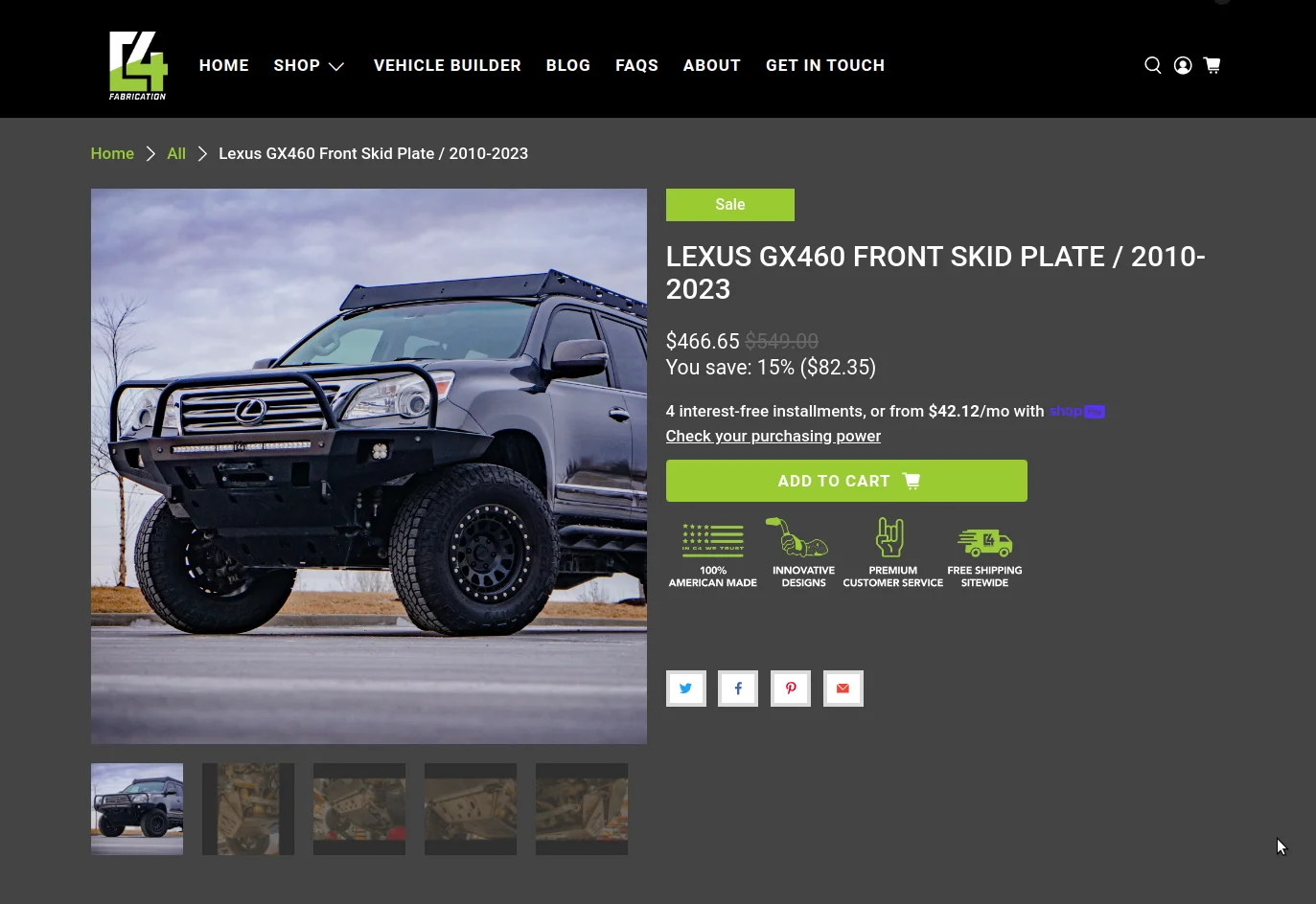

Link for the C4 bumper goes to 404 Not Found. :( But I found this image of a 2010-13 GX460 on their front skid plate page.

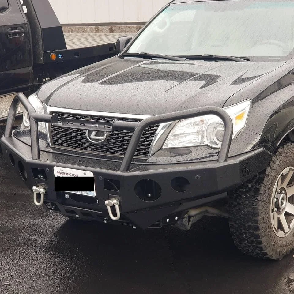

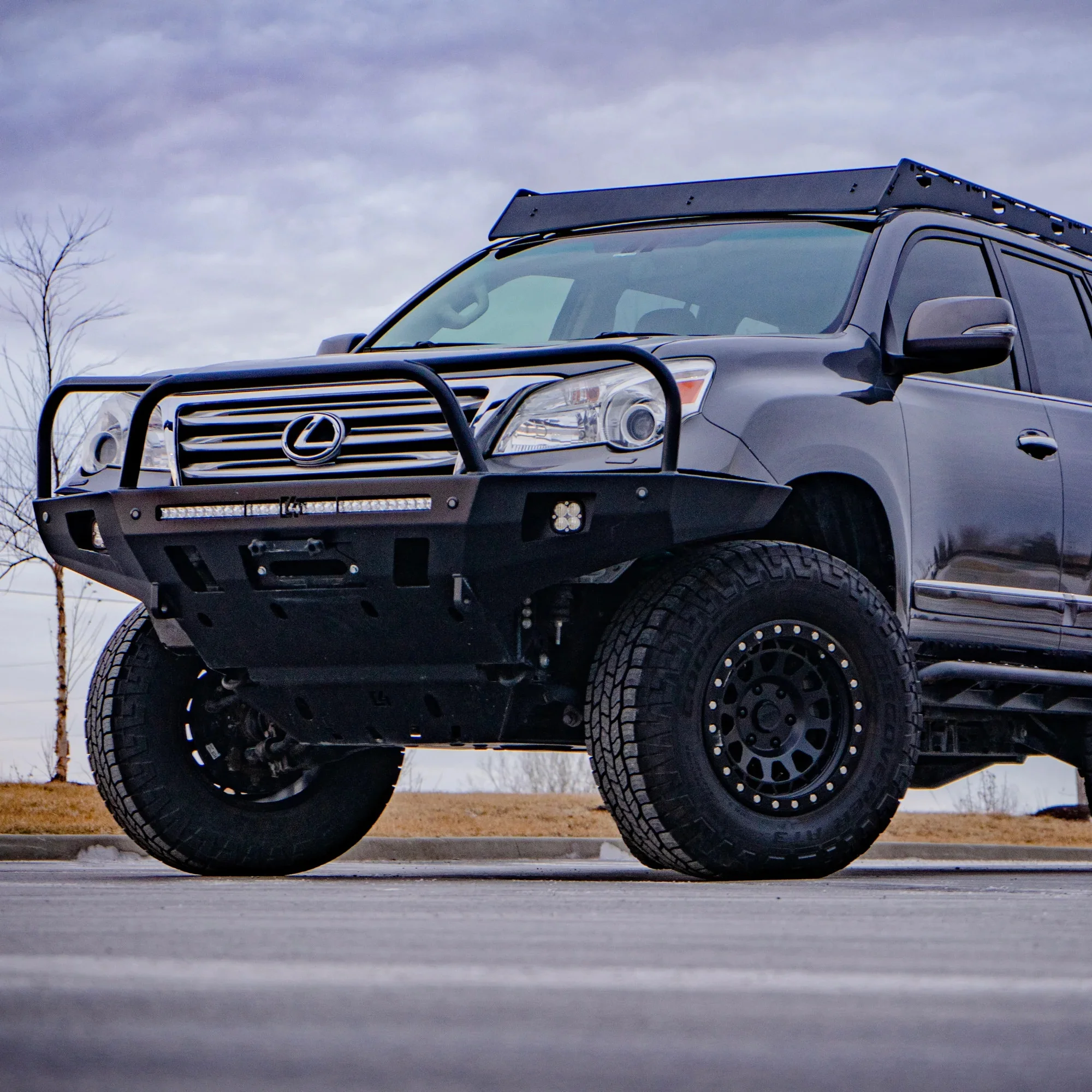

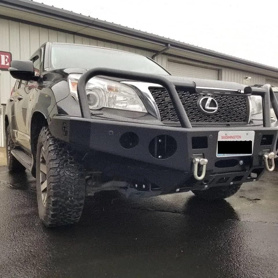

Is this the C4 Front Bumper that was being referenced? --I've seen another bumper they made and it was more of a hybrid and looked nothing like this one.
If not, anybody know who makes this bumper? I like the lines of it way better than anything else available for these trucks.
Only C4 in the past I am aware of..but looking at cutouts..looks to be another prototype or one-off

A 2020 prototype that I don’t think was ever sold
Looks similar to the Victory Strike, which is available in aluminum (for the OP, 3 years later).
