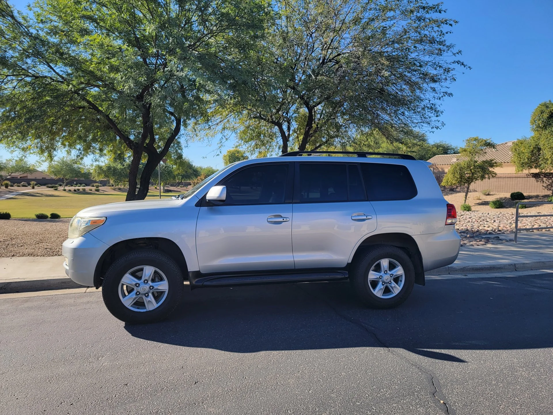

I've owned a 2008 LC for about 5 years and currently have 260k miles. Only major issues was a broken valve spring a couple years ago . That was repaired right and the truck is always kept up on maintenance. Other than valve spring and up until 2 weeks ago ran flawless. A few weeks ago she lost coolant, got hot, and shut down. The cause of coolant loss was some plastic fitting. I flatbedded to mechanic, he replaced the fitting, added coolant and tested engine and systems. Surprisingly? All tested good, she ran great...for two weeks. One morning, I noticed a misfire on startup for a few minutes. You guessed it. She's now got a head gasket leak, about 1 teaspon in cyl 5 under 30 minutes of pressure testing. After a few minutes of coolant burnoff she runs great. I'm no mechanic so any repair path means $$$
Here she is
While I contemplated repair options, I went ahead and bought a 2010 LX570, looks kind of similar huh?
