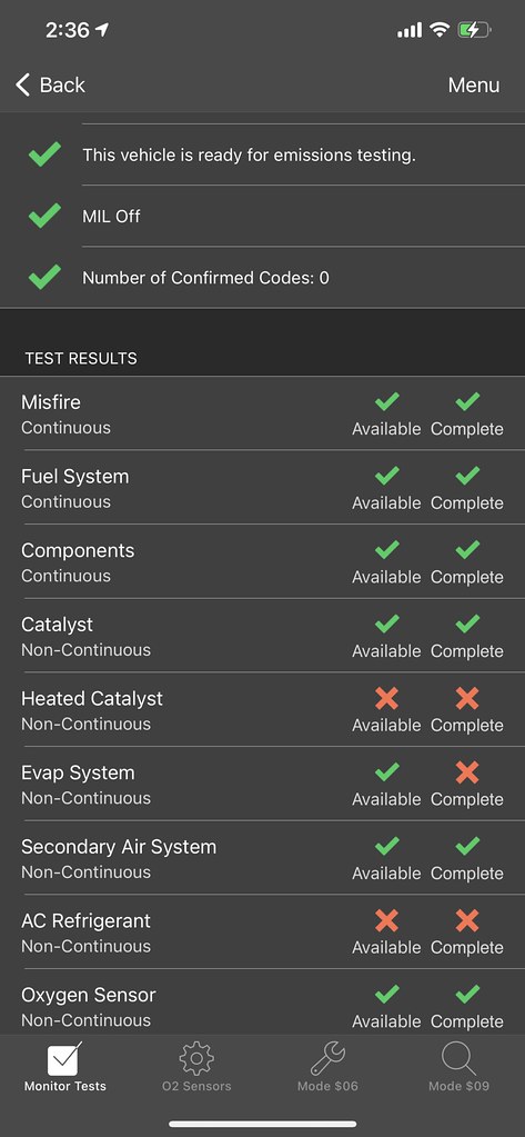

Alright just to confirm that the 234-4260 is the right part number for both rear down stream O2 Sensors, i thought the wire looks short in the package but when i unraveld it, it was the right length. It fixed my check engine light issue, all i did was drive maybe 5 miles and all the emissions monitor was set ready for testing. $77 at Advance Autopart. Old one was original toyota, 215K miles.
Left all my tools at work, went to harbor freight to buy this sensor tool and it snapped just as the sensor was free. Matco would've broken the sensor before the tool broke..lol
All the readiness monitors are set for emissions testing
