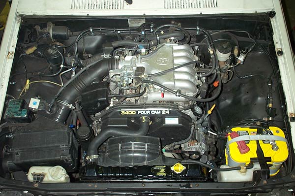

So I inquired a 2005 4-runner from a buddy and basically he started the swap from 3.0 to 3.4 . The 3.4 is in the vechile and he did the oil pan Dipstick and he Also redid the clutch and the fly wheel.. So it is a Manuel transmission with locking front hubs. I think it has a suspension lift ? All and all it's a really nice clean 95 manual with alot of potential. I have always wanted to do a swap and really make my own 4 runner for my newda. So I started getting some basic parts like y pipe that dumps on other side . Body alift so I could close good h20 sensors . Then it came down to the ECU and I decided to go with a mega squirt . I got it from a guy on e-bay he lives in Russia and is know for making mega squirts for vechile your choice at a decent price.. so really I need to find the person that I can send my mega squirt and ecu vin what ever else needed for someone to build me a harness for my mega squirt.. pretty much make it plug and play ??? Also so I then pretty much am replacing everything from pistons bearings water pump brake calipers drums raditor with a fan I got the battery tray and Rez over flow for 22re rims tires . Also adding abunch of accessories stero rear view camera CB radio ham radio scanner a weboost cell booster light bars pa .. I have everything I mentioned except for new rims and tires . Also putting 7 in computer screen so I can take advantage of having a mega squirt ... So anyone that knows of a good person to hire to basically take care of my electrical would be greatly appreciated. This is my first time ever joing.a forum never mind putting a post up.. I am going to take pics of the vechile and of the parts I have bought thanks in the bag
