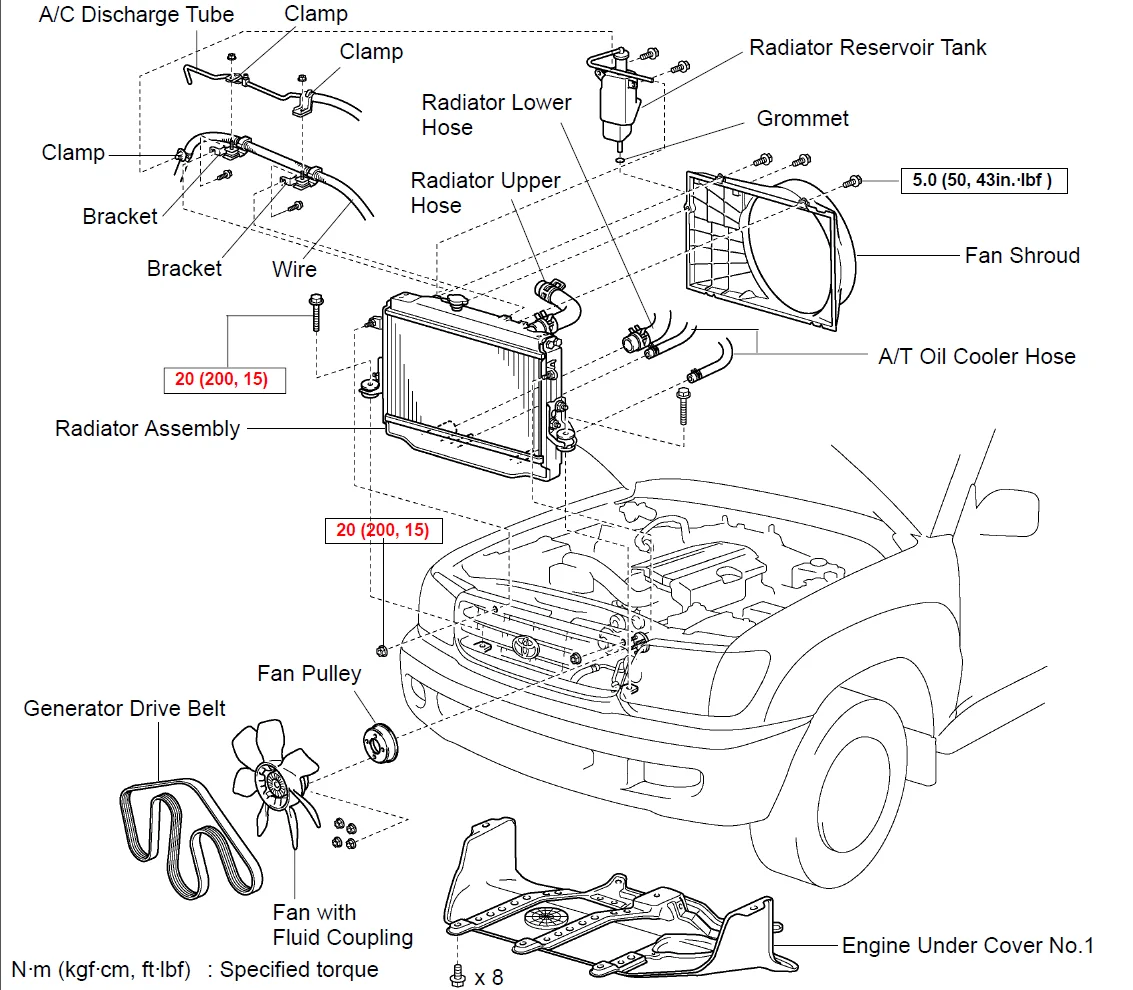

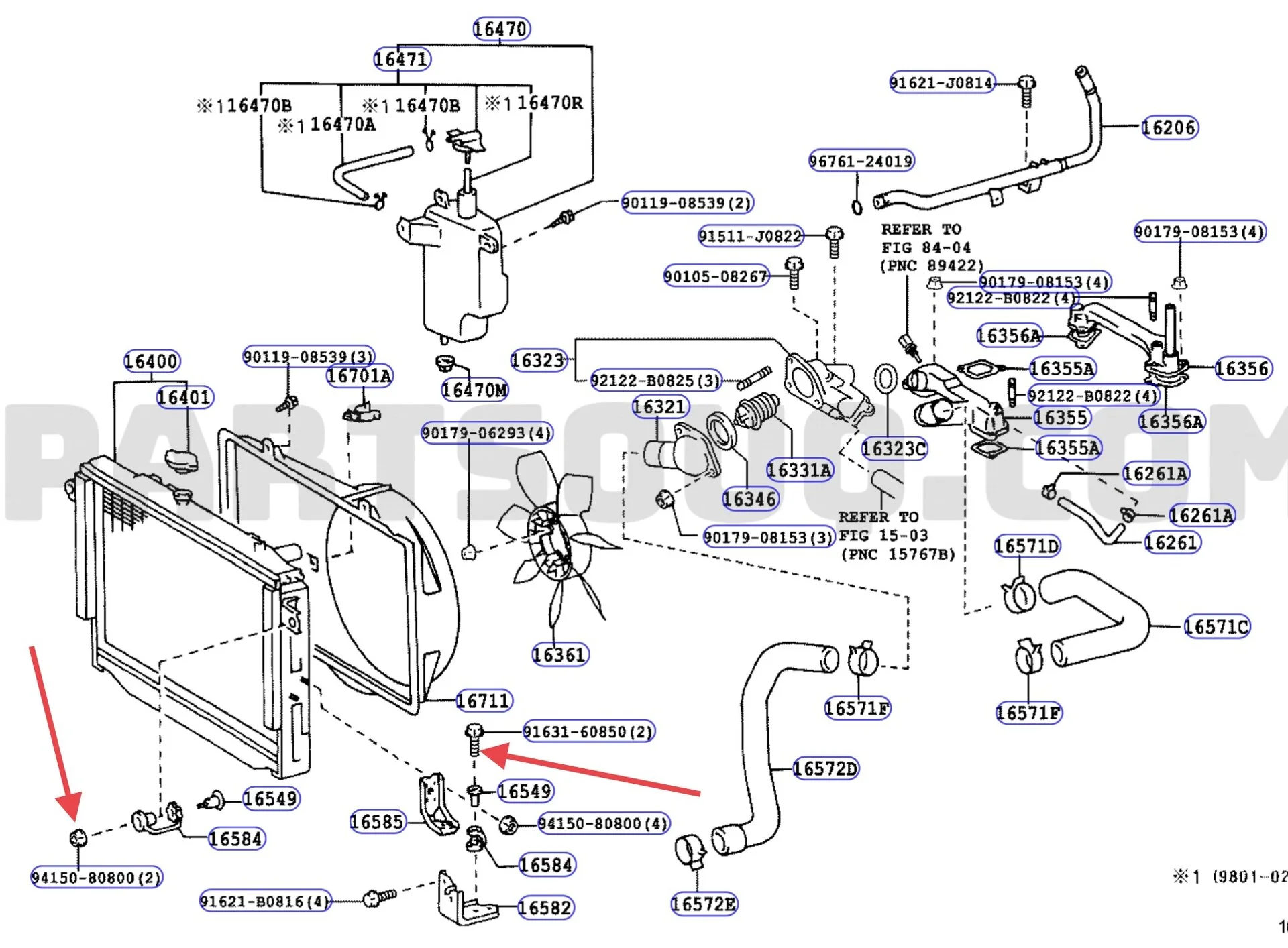

2004 Land Cruiser Does anyone know how much the radiator bushing/insulator bolts/nuts should be tightened/torqued? I’m attaching an illustration of what I need to tighten.

Thank you that helps! Great photo/diagram.FSM says 15 ft-lbs. for the four mounting bolts/nuts.View attachment 3275566
