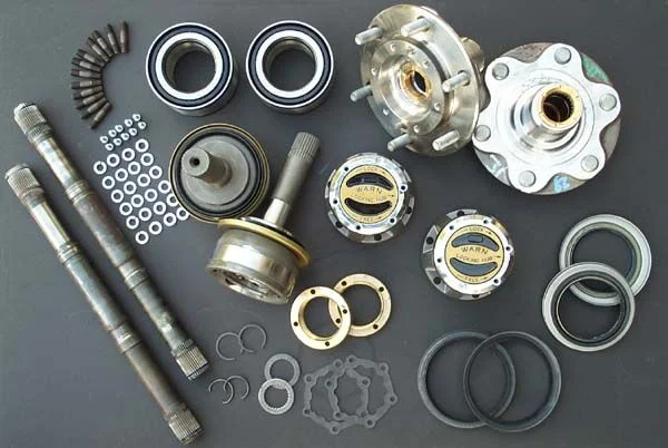

Hi guys - I've googled the heck out of this and haven't been able to find an answer. Every thread I've read on converting ADD equipped trucks to manual front hubs talks about swapping in the front knuckles from a manual hub truck into the ADD truck, then replacing the hubs and axles with non-add pieces and disabling the vacuum solenoid that operates the disconnect.
My question is, can I use the knuckle that's on my ADD truck and press in new bearings and non-add hubs? I've verified (on rockauto) that the wheel bearings are the same part for ADD and non-ADD trucks, but the hub itself obviously looks different, but I'm not sure if the knuckle itself can accomodate either wheel hub. I've tried to find comparisons online, but no one seems to have tried this before.
Any experience you've had would be appreciated. The whole front end of this truck needs going through, so if I can just buy non-ADD parts to adapt my current knuckles it would save me a ton of time/money trying to buy knuckles from a non-ADD truck.
If no one has tried it before, maybe I'll give it a shot.
Thanks!

I'm doing this to an 03. From all my research guys just pull the manual hub knuckles from a junk yard to save time and money. No Tacos in junk yards around here.
Looks like the tricky part is to make sure you have the correct spacers, nuts, paying attention to ABS or non, etc. I haven't done this everything is in boxes. I bought all on Rock Auto and the parts I bought looks exactly like a high dollar kit available from one of the websites. This has been documented but I didn't save any links.

That is exactly what I was looking for! Thanks for the info. I didn't come across that thread before, guess google-fu failed me today.
I guess the parts I'd worry about are indeed teh spacers and circlips and such, but that thread actually has the part numbers! Excellent find. Once I get to the front end rebuild, this will be the way to go since I have teh j-shift transfer case already. Thanks again!

As you see in the other thread you'll need the spanner socket to really reef down on the retainer nuts.
