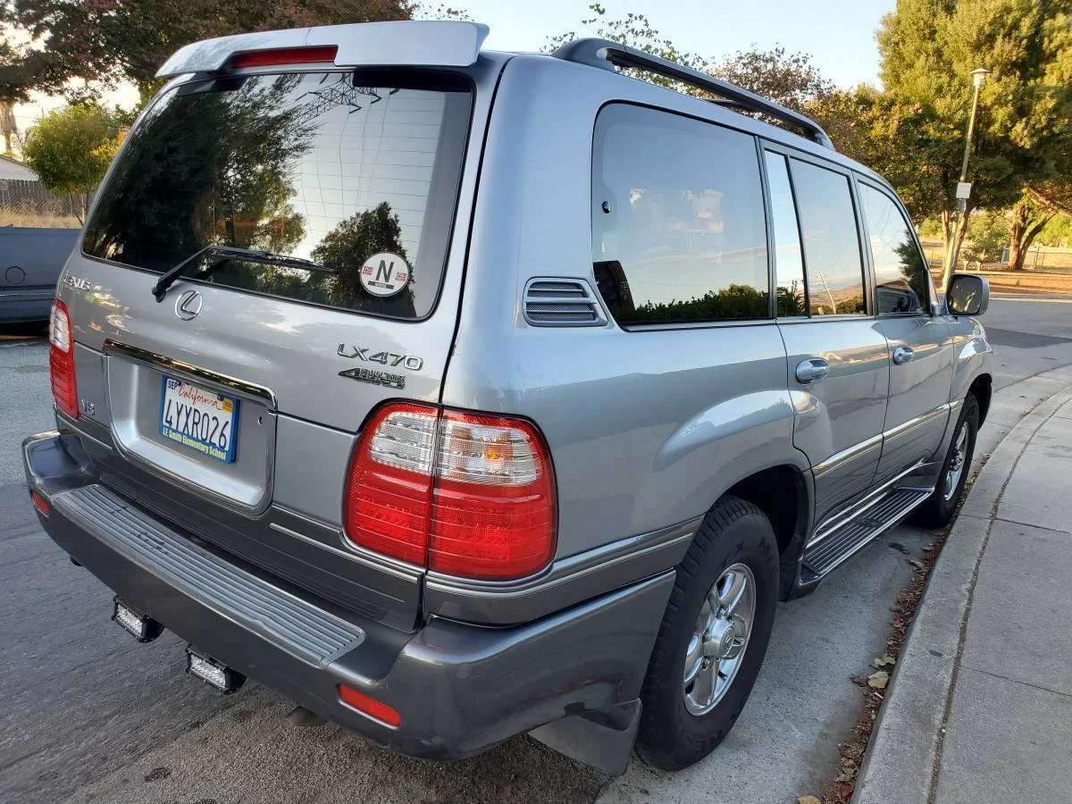

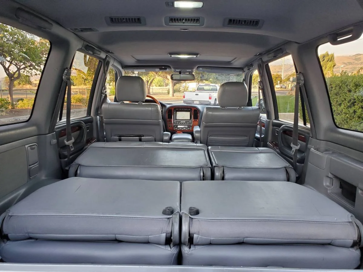

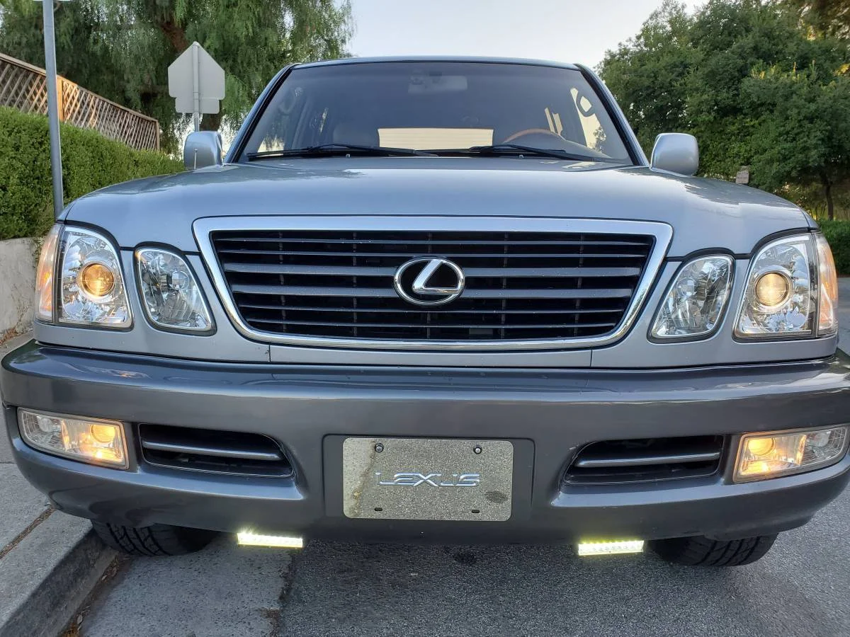

Hi everyone, I'm new to this and looking at purchasing a truck for long trips/off road. I have found an ad on craigslist for an LX470 in the Bay Area of California which interests me. I haven't taken a look at it in person yet as the high mileage is making me wonder whether it's worth the time. If someone can address the average life span of these trucks or advise on whether the high mileage is of concern that would be great. My main purpose would be for trips to LA from the Bay Area, as well as gradually building an off road rig.
I've copied the ad description below:
2002 LX470
odometer: 245,000
I am selling excellent condition 2002 Lexus LX470 4D automatic Wagon/ Sport Utility 4x4. It's 8 cylinder 4.7L engine, very strong and fast. It runs perfect with no mechanical problem. The engine is functioning properly and has no issues. The transmission shifts very smoothly This would be a great commuter car for family. Lexus LX model is very reliable car. Its very good condition for the years; only minor wear and tear at the bumper as to be expected but all over the paint is excellent condition for its age.
Clean title, never been in the accident. All maintenance on time and at Dealer only. I've upgraded all LED lights in interior. The car is Flawless!
It has All-Mode 4 WD with 2WD, Auto, 4WD Locked. Its AWD so would be perfect for someone who would like to explore the mountain or snow. I've just spent a lot of time and several thousands of dollars worth of work and maintenance!
Just paid one year registration until Sept 2020
Mostly freeway miles and regular maintenance

mileage doesn't concern me. price is within realm especially considering recent maintenance( make them provide reciepts). what does concern me though is why all the maintenance then suddenly selling. especially the fuel pressure sensor. that's not a normal maintenance item. i think they were trying to fix a driveability issue and discovered a bigger problem.
also 99% likely they replaced that CV axle with an aftermarket which will cause you trouble. if the dealer did the work on these items I'd be interested in at least an inspection. but if not, I personally would walk away. improper maintenance is worse than no maintenance at all IMO.
I would approach that LX with caution. The ad is written odd and flowery. "All-Mode 4 WD with 2WD" is a strange thing to state under the same breath of mentioning AWD. Either the owner doesn't have a clue or is lying, both a possible cause for concern.
If the past and recent maintenance can be verified via receipts and the Lexus owners site and the vehicle meets your needs, it would probably be a solid buy if you plan to do some maintenance yourself and thoroughly inspect it before purchase. I bought my '99 with 246k miles a few years back and encountered some catch up maintenance despite a solid service history. You can see my experience in the link in my signature ⬇
That looks like a pretty decent deal to me.
How much would you say you spent in additional maintenance right off the bat?
I would press hard on why there's all these expensive maintenance / baseline items then the LX is put up for sale.
I might request pictures of the Power Steering Fluid and Coolant, or at least shots of the respective reservoirs. If it’s not ATF and the correct color coolant and flushes were just performed on both systems, that would be cause to run. If things were done correctly and the overall condition of the body, interior, and underside check out, I would say it’s priced right. If the wrong fluids are in the aforementioned systems, they are worse than before the flushes and I wouldn’t trust any of the other repairs/maintenances that have been performed.

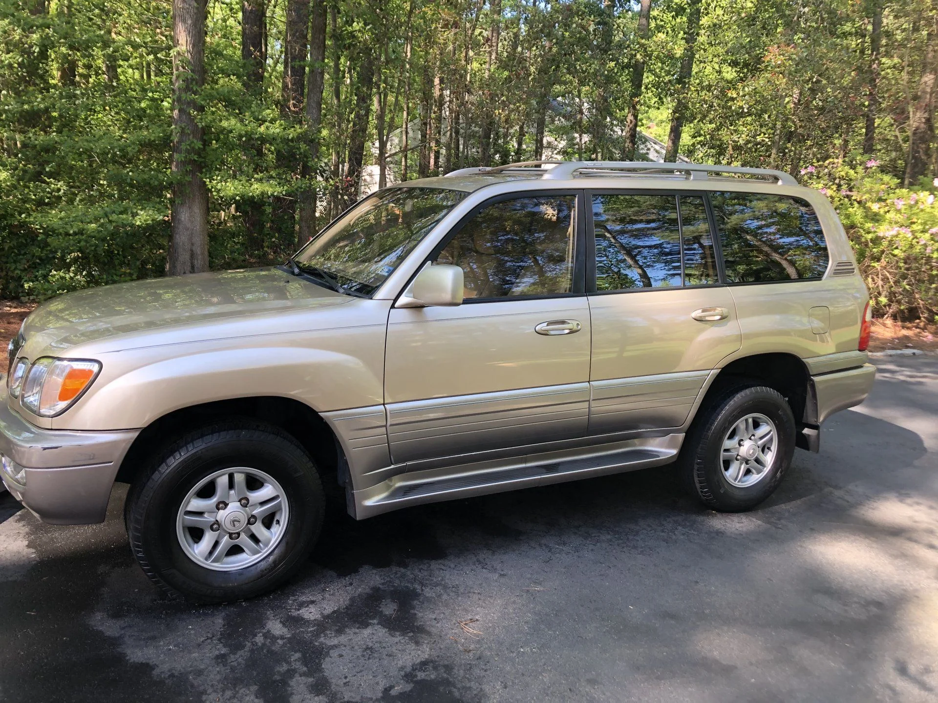

So I purchased this 2 weeks ago for my son. It’s a 98 with 230k miles, 2owner with extensive records. I also purchased an 02 for my daughter 2 years ago so I know these rigs fairly well.
I have refurbished both of them.
The 98 above required the following
New leather seats in front, labor and materials $950
Strip and finish all 4 wheels $650
All new amsoil lubes front to rear $350, I did the labor...if I had paid out of pocket id guess $500
Timing belt and water pump parts and labor $600..Ex Toyota tech good deal for sure.
All new filters $75
Exhaust leak $150
But here’s the real kicker...I purchased the rig for $3700....it seems that in certain areas people have no idea what an lx470 is, they only know what a Land Cruiser is, so for me it worked in my favor.
I’m all in under 7k.
With the economy the way it is currently you can get some very good deals for sure.
Just thought this would help with values and estimating costs.
