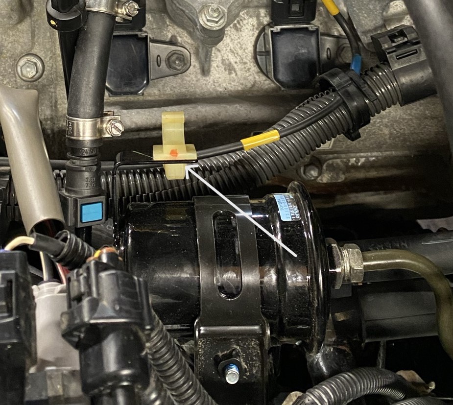

Perhaps fuel pump failing. At next no start. Disconnect fuel line from fuel filler. If fuel pump, is building good flow and pressure. Fuel will spray out momentarily as fuel pressure relieved and run back out from fuel line if open end lower than fuel rail. So be careful (key off, no flame or sparks, protect eyes, etc).
No spray and no meaningful backflow from fuel line, is indication of no or very low fuel pressure. You can then connect a hose to filter a run to catch can, as additional fuel pump test. Crank engine, see if fuel flows steady or doesn't into catch can. Intermittent nature, make tricky. As it may now work/pump.
By rotating fuel line out from white safety clip (not seen, missing from this fuel filter picture). Then pinching release (green) clip (red arrow), fuel line is released. Fuel line can then be pulled off filter. If fuel system under pressure, fuel sprays out momentarily. Fuel/gasoline vapors, are extremely flammable. So use caution.
White fuel filter line safety clip
