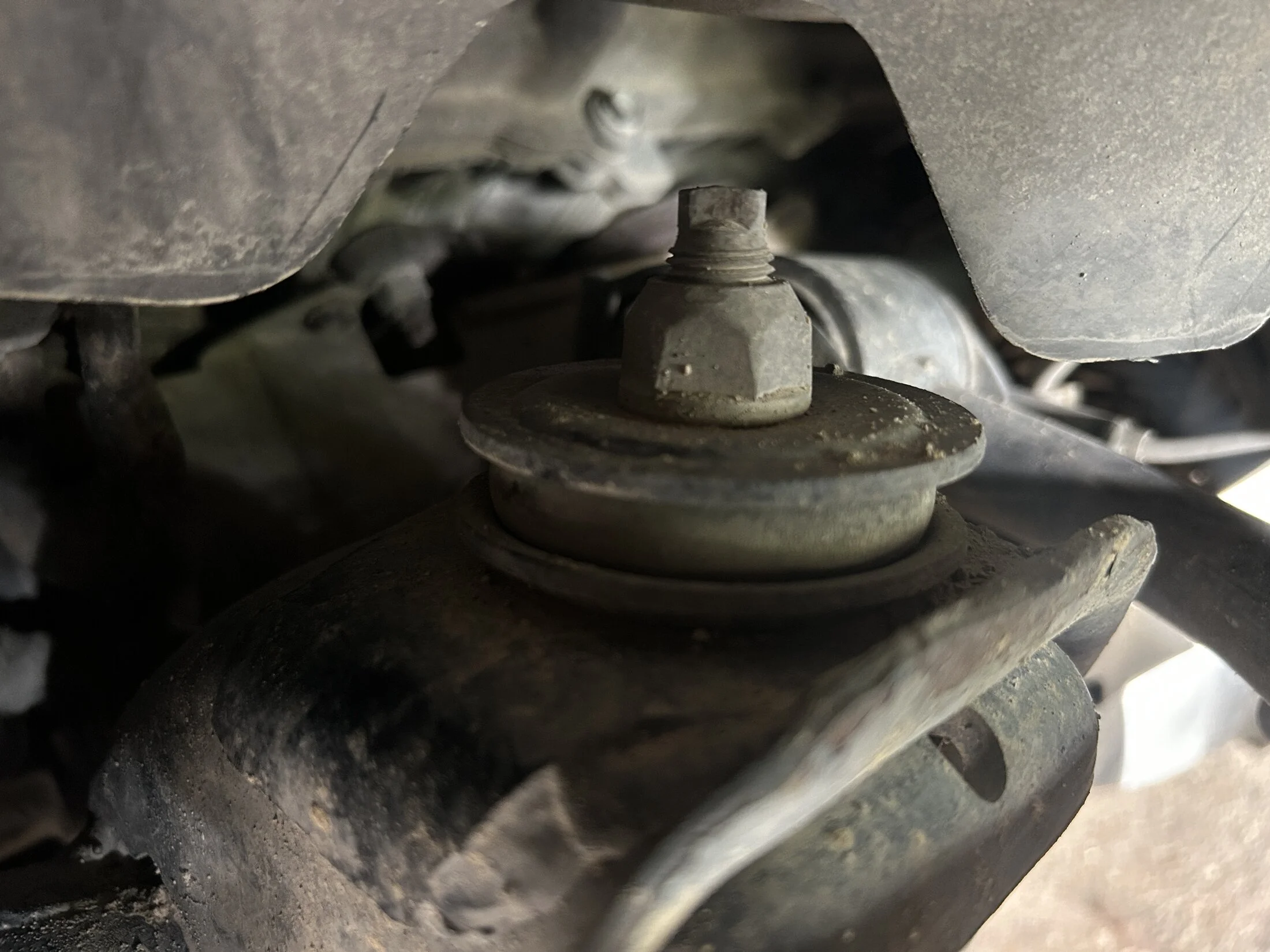

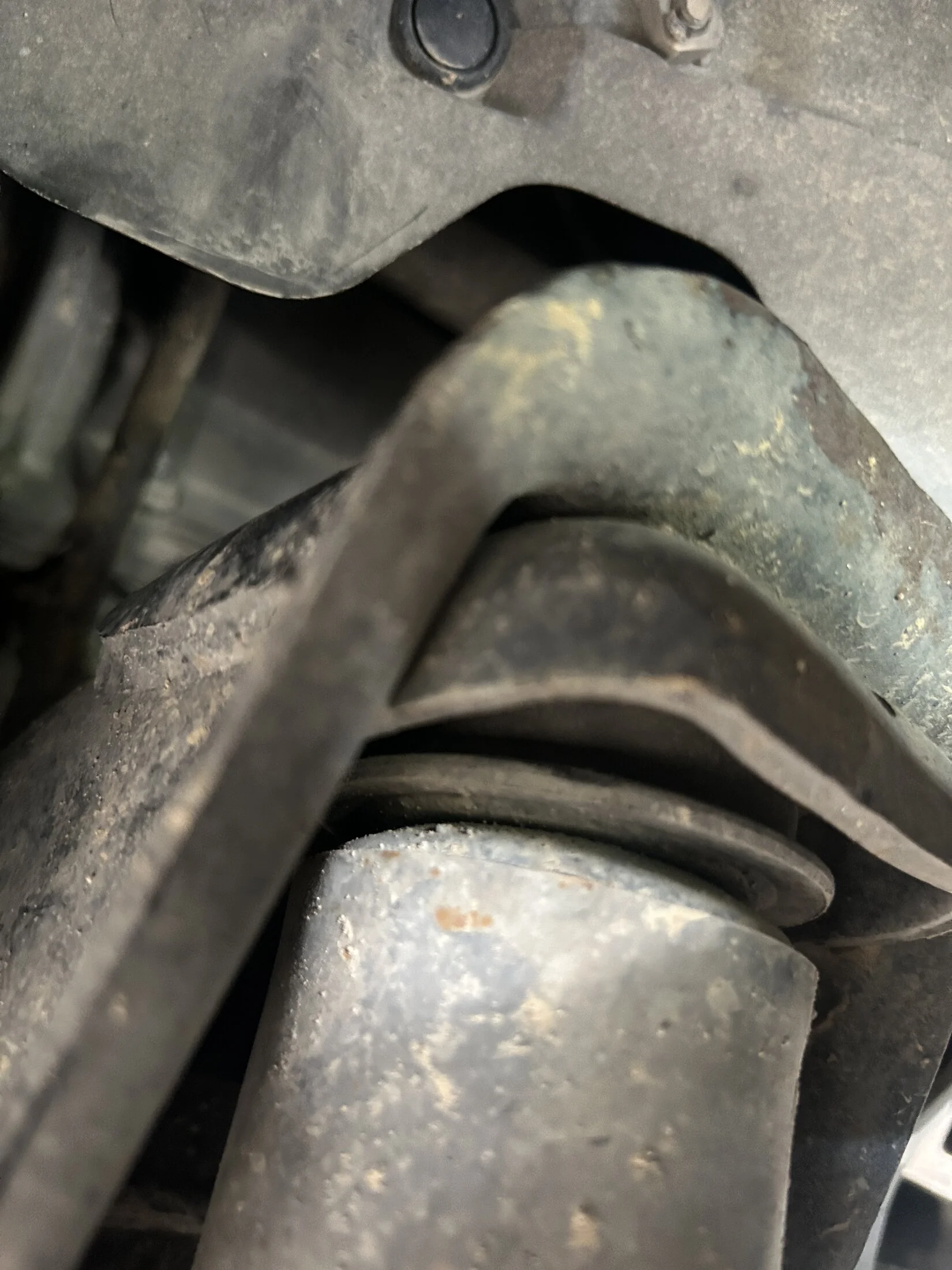

Its been a while since I replaced my shocks, but I'm pretty sure its 4 retainers per side for the front shocks. 2 retainers above the upper shock mount on top/bottom of upper cushion and pretty sure same setup below the upper shock mount, 2 retainers top/bottom of lower cushion.
I just went and looked to be sure but its almost impossible to see exactly what's all there below the upper shock mount.
Edit: add photos upper is first pic and second is best I could get for area below the shock mount

If you’re replacing old OE shocks, with new OE shocks, just reuse the existing “shock retainers” (4 washers at each corner).
If you have a "2000 TLC" there is no need to buy retainer/washers. Just re-use what you take off, paying attention to how and where they came off - front or rear. They are indestructible. Clean them up and/or paint them if you wish.
