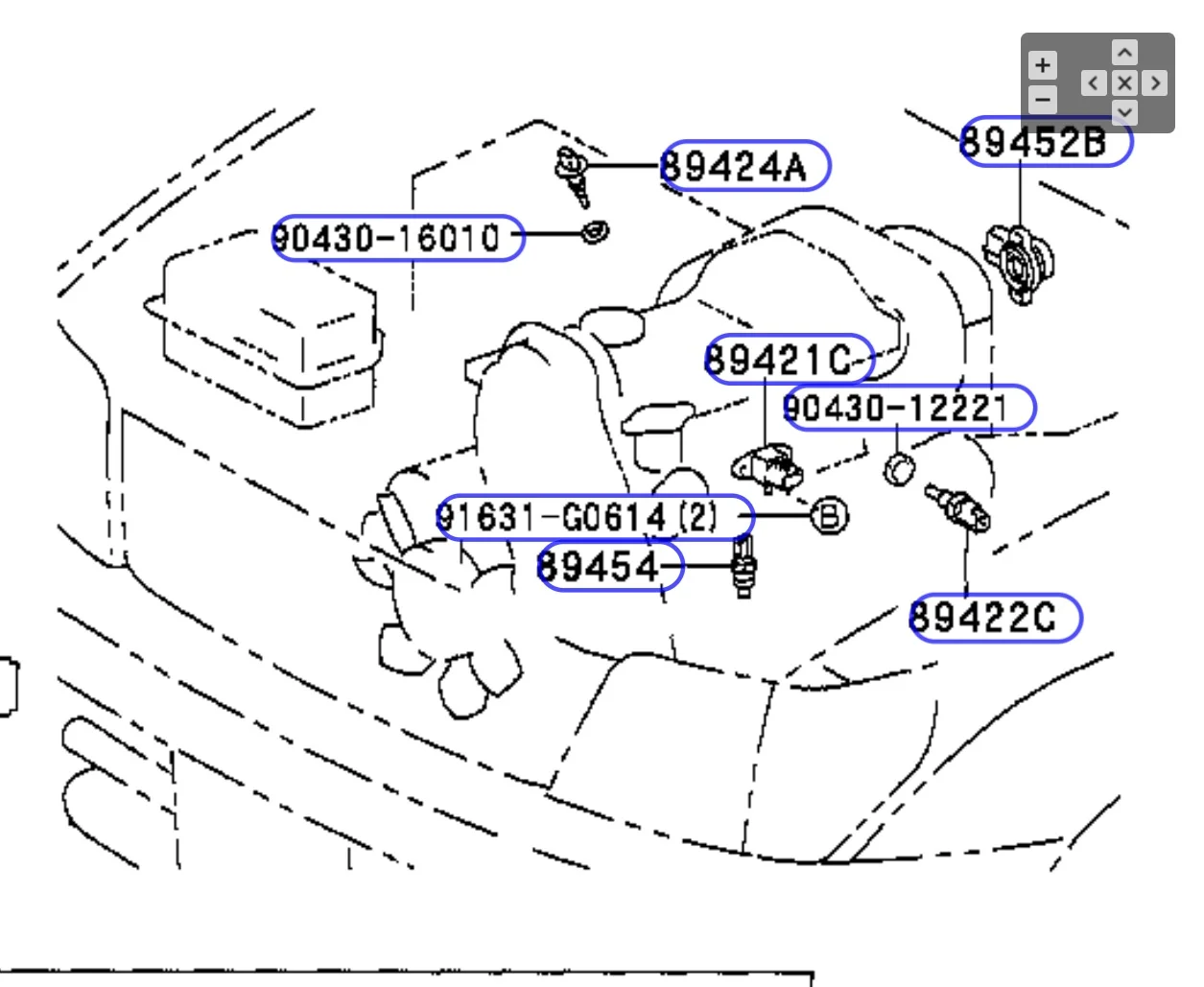

I found this diagram on partsouq for a KZJ prado in the years you are describing:
The COOLANT/WATER Temp Sensor looks to be on the lower right towards the back of the engine. On the diagram it is 89422C.
Hope this helps, and good luck with the fix! :cheers:

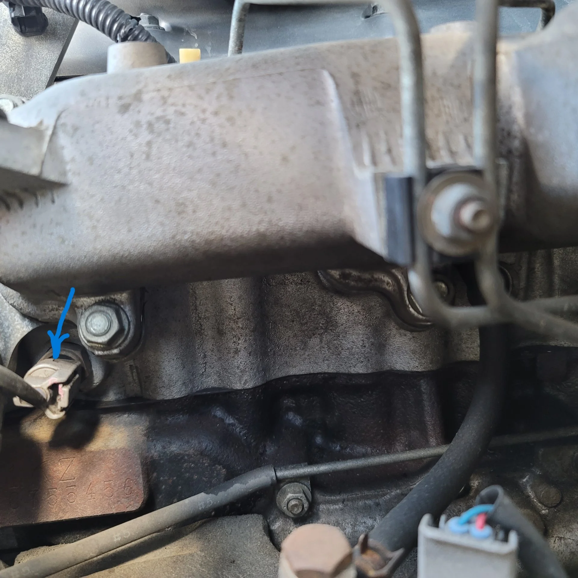

Thanks I will try to find it.

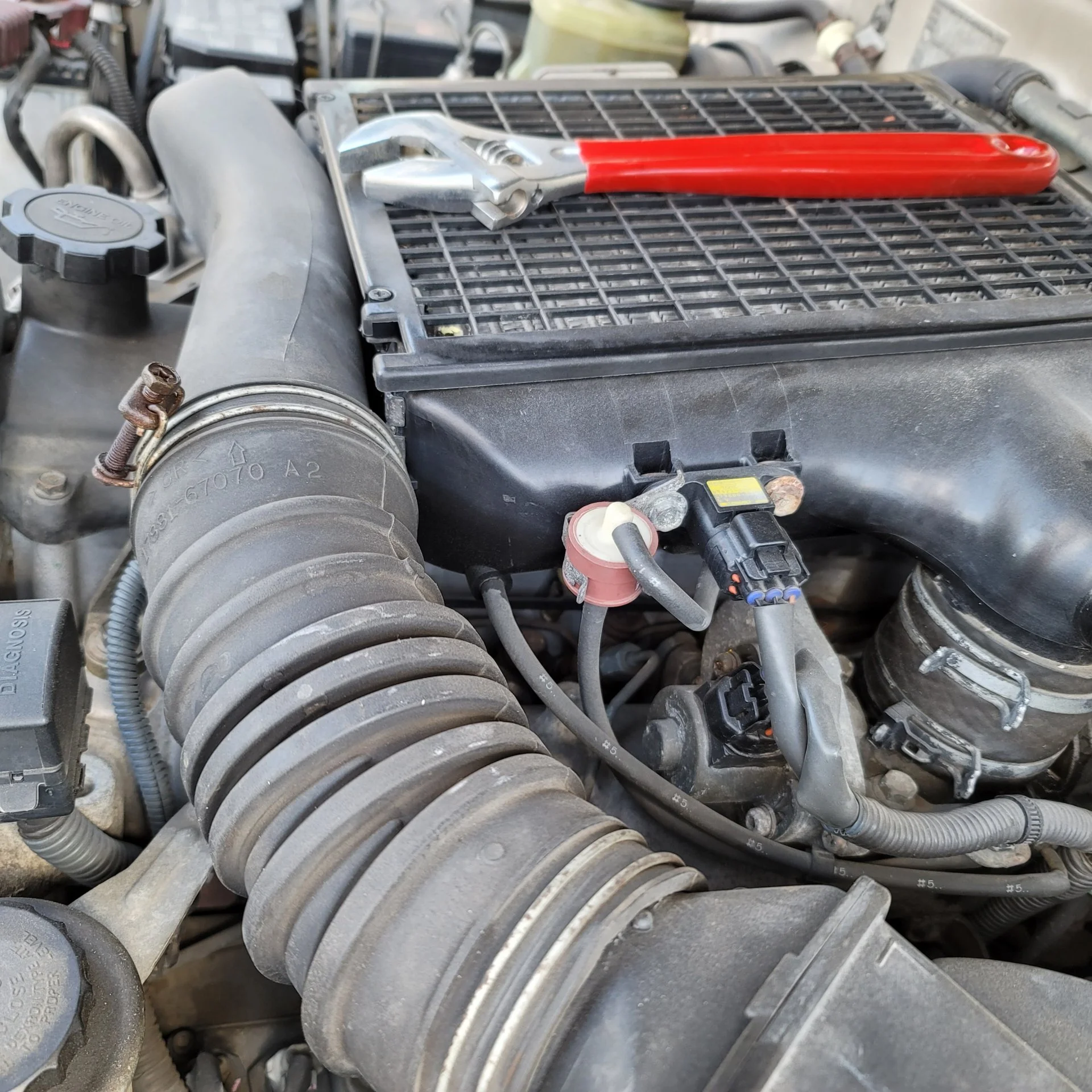

Couldn't locate it. Pls see the picture if its that one. Also when I took sensor out the coolant will come out?
Thanks
That does look like the sensor you are looking for, and yes, when you unscrew it, coolant will come out. At least whatever is in the block above the sensor. Depending on the condition of the coolant, you can either take this opportunity to change it out, or just have some OEM coolant available to top it up when you are finished. You won't loose a lot if you have the new one ready to put back in.

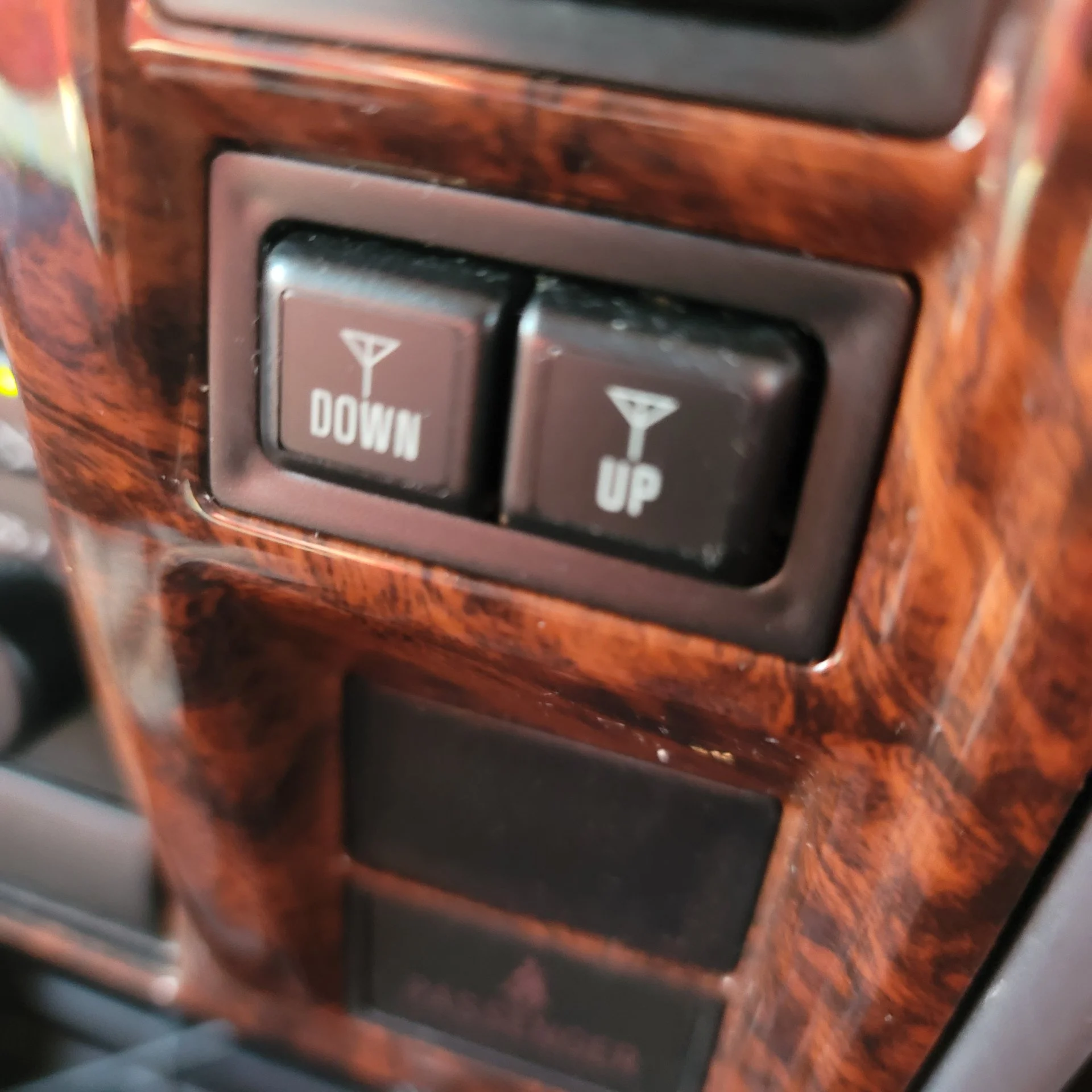

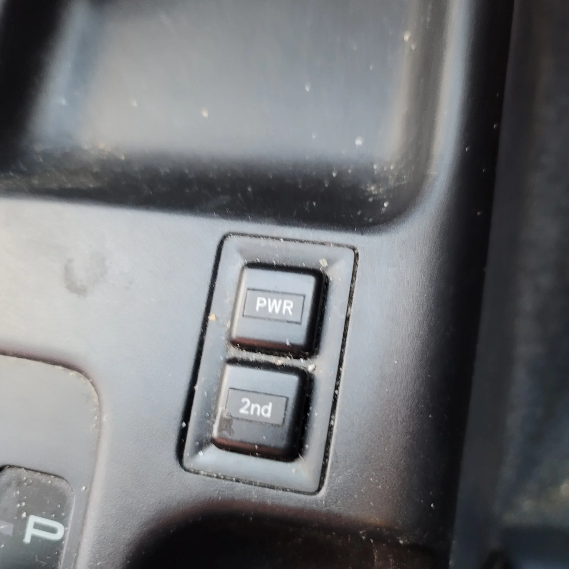

The first pic is your radio antenna up/down. Second pic- PWR is kind of like a sport mode for the transmission. Makes it hold lower gears longer and downshift faster. 2ND is for second gear start.
