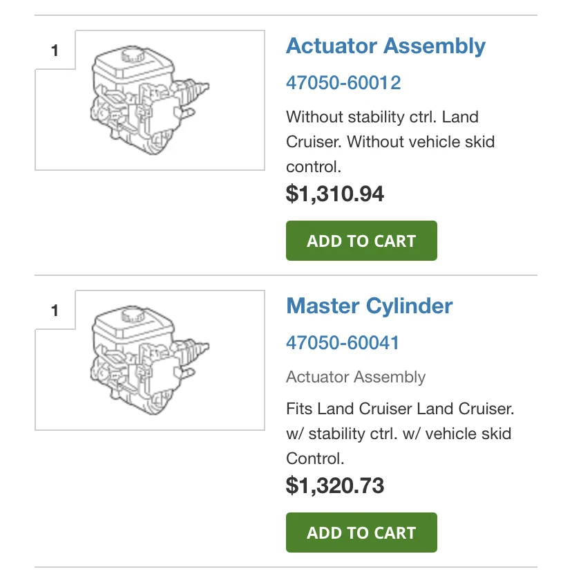

I’m looking for replace the master brake cylinder in my 2000 Land Cruiser as preventative maintenance because the prices are more favorable than ever. My local dealership here in Houston is telling me I need 47050-60012 (for Land Cruisers without VSC), while the parts department guy at McGeorge Toyota is telling me I need 47050-60041 (for Land Cruisers with VSC). At this point, I don’t know who to believe. Any ideas?
My truck was built in November of 1999 if that helps.

When you turn your ignition on, does VSC light up on the instrument cluster? If so, then you have VSC.

2000 MY is what you have, that is 1st year of ATRAC-and you would need the master with atrac-VSC actuator.
I wouldn’t replace a working unit preemptively-but if you plan to keep your truck for the long run, and your worried about the prices or future availability, provide you VIN to parts and buy the completebrake booster assembly with master cylinder” and keep it on hand.
Occasionally Toyota runs sales on parts and that’s the time scoop one up at 50% off
47050-60041 or 47050-60042 fit 2000 but need to confirm based on your VIN

I too own a 2000 and there is a difference in mid year. The pressure switch (3 wire connector) can be either triangular or oval. Mine is triangular so I ordered the correct part. try entering your VIN into partsouq.com and see which pump fits to make sure you get the right part.
