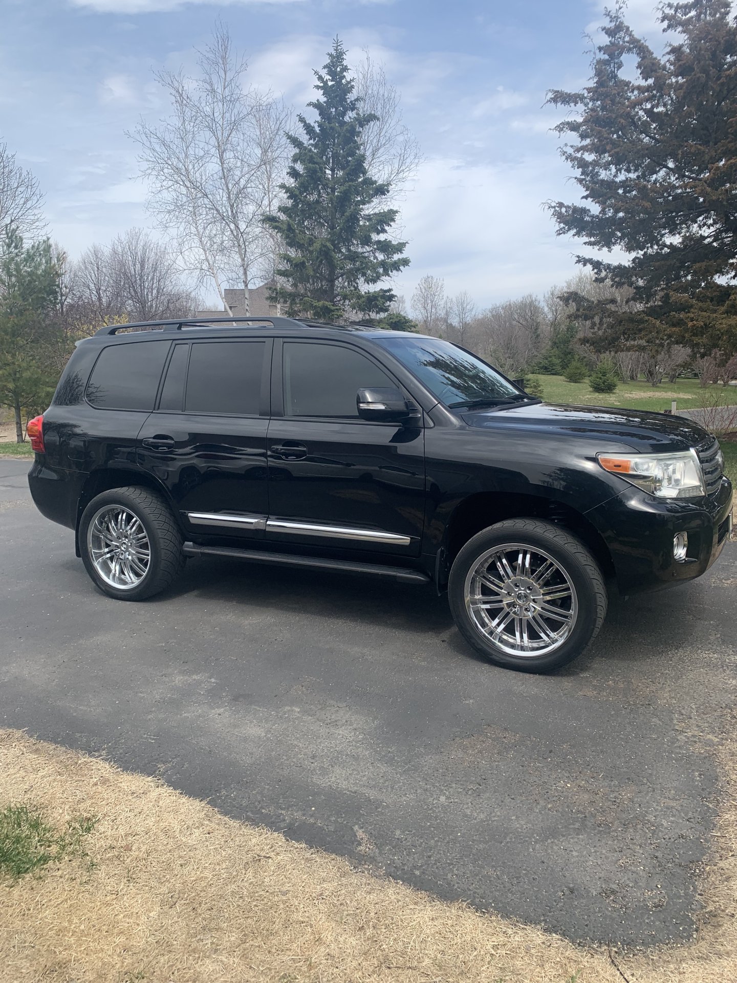

Got them special order made from Motorsport-Tech
5 bolt to 6 bolt spacer/adapter. Took about 8 weeks from purchase to being shipped to my house.
1 1/4 inch first piece connects to the LC200 then the 3/4 inch piece has the 6 bolts.

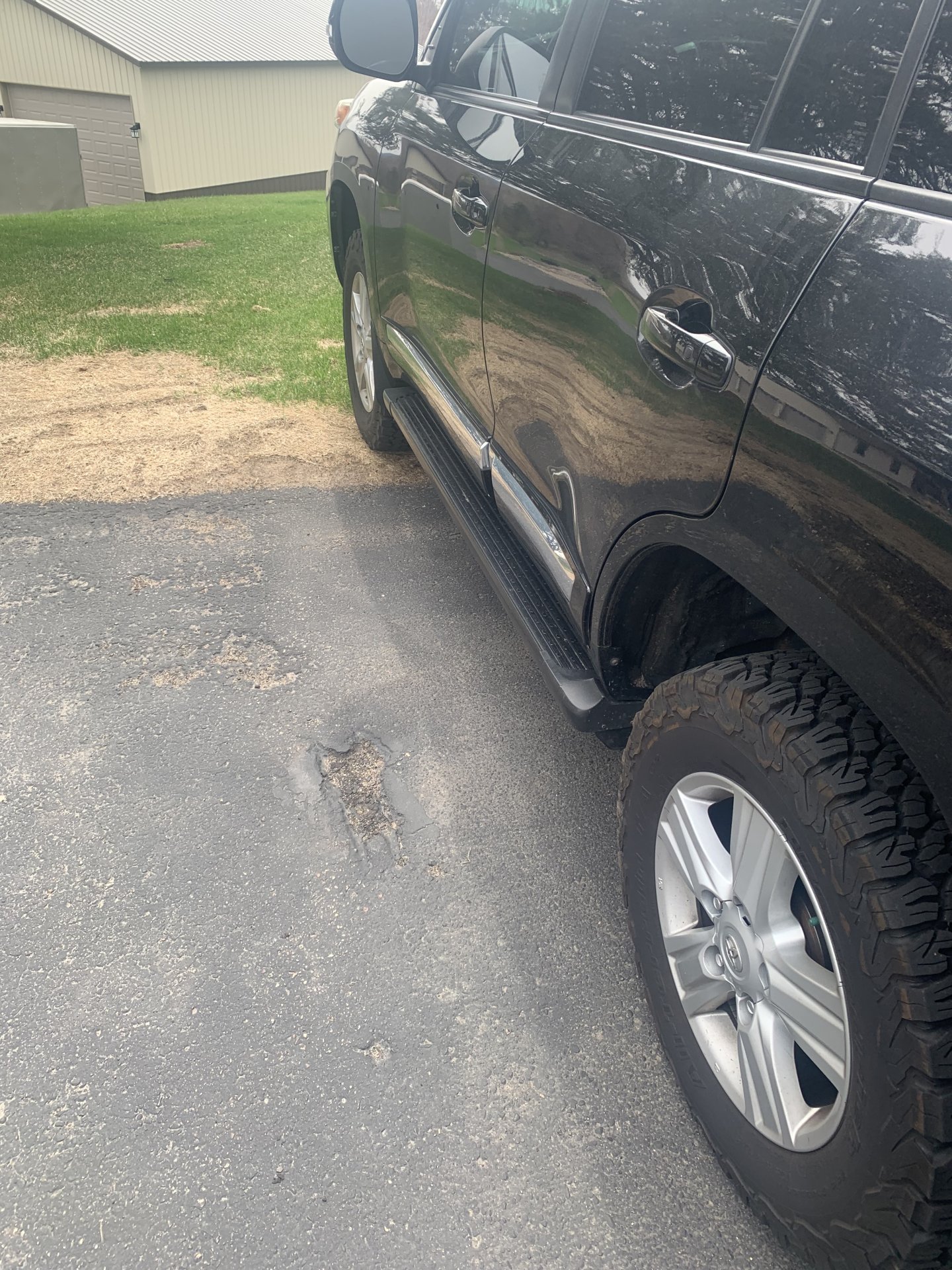

Will post before and after photos
These adapters are heavy as heck and very well made from aircraft grade aluminum
They are probably 10-15lbs a piece

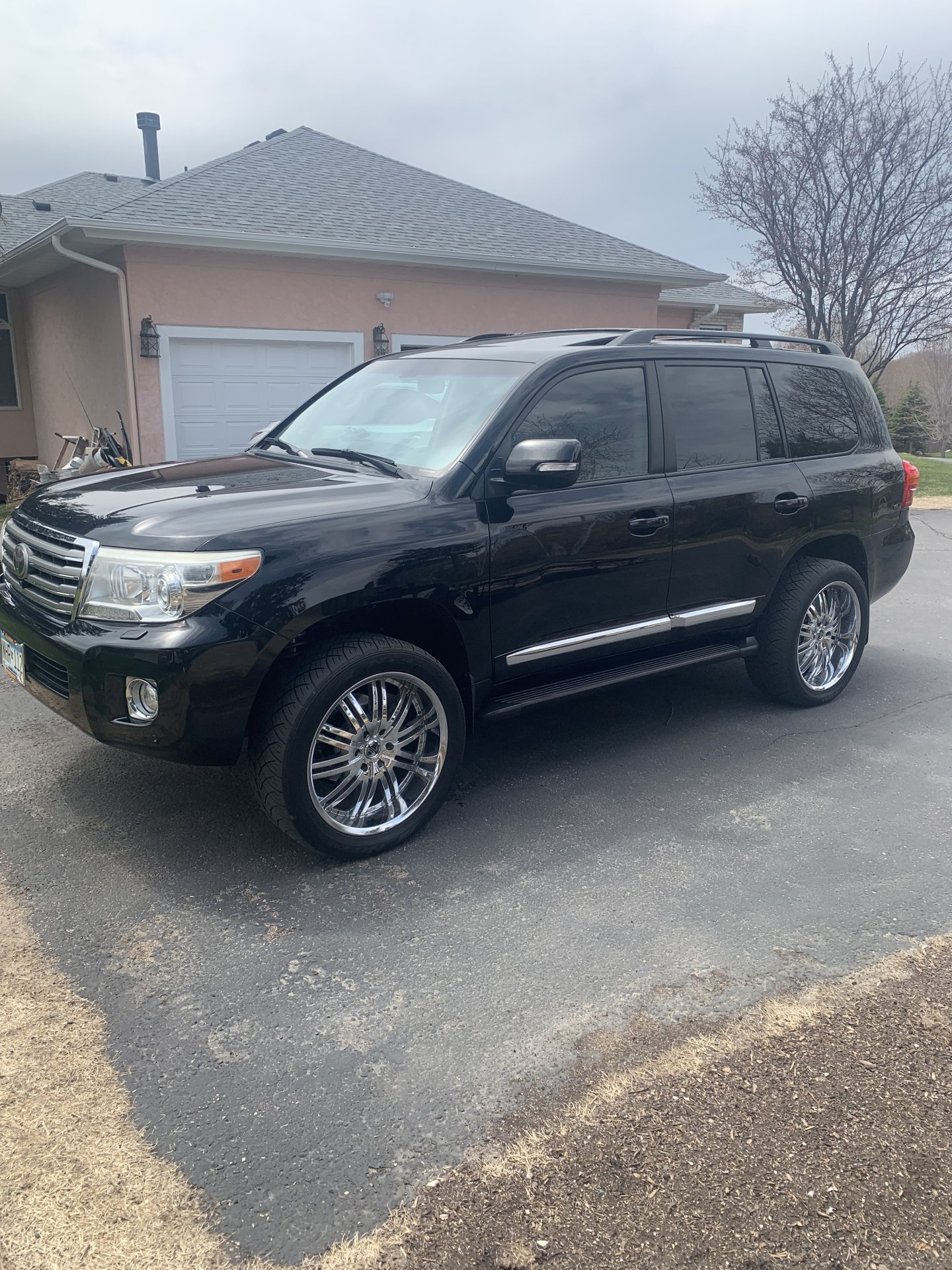

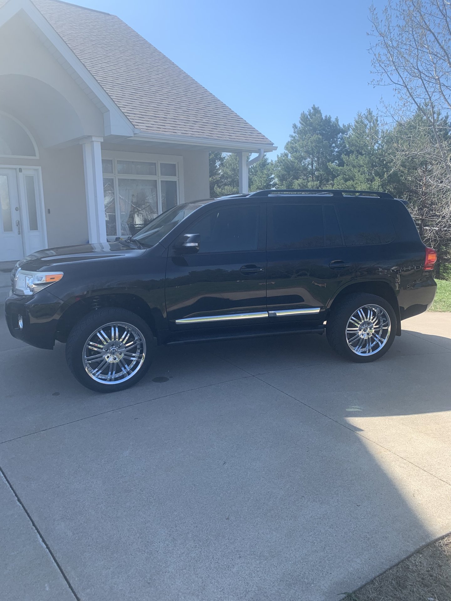

22 inch wheels are on
285/45r22 tires are on

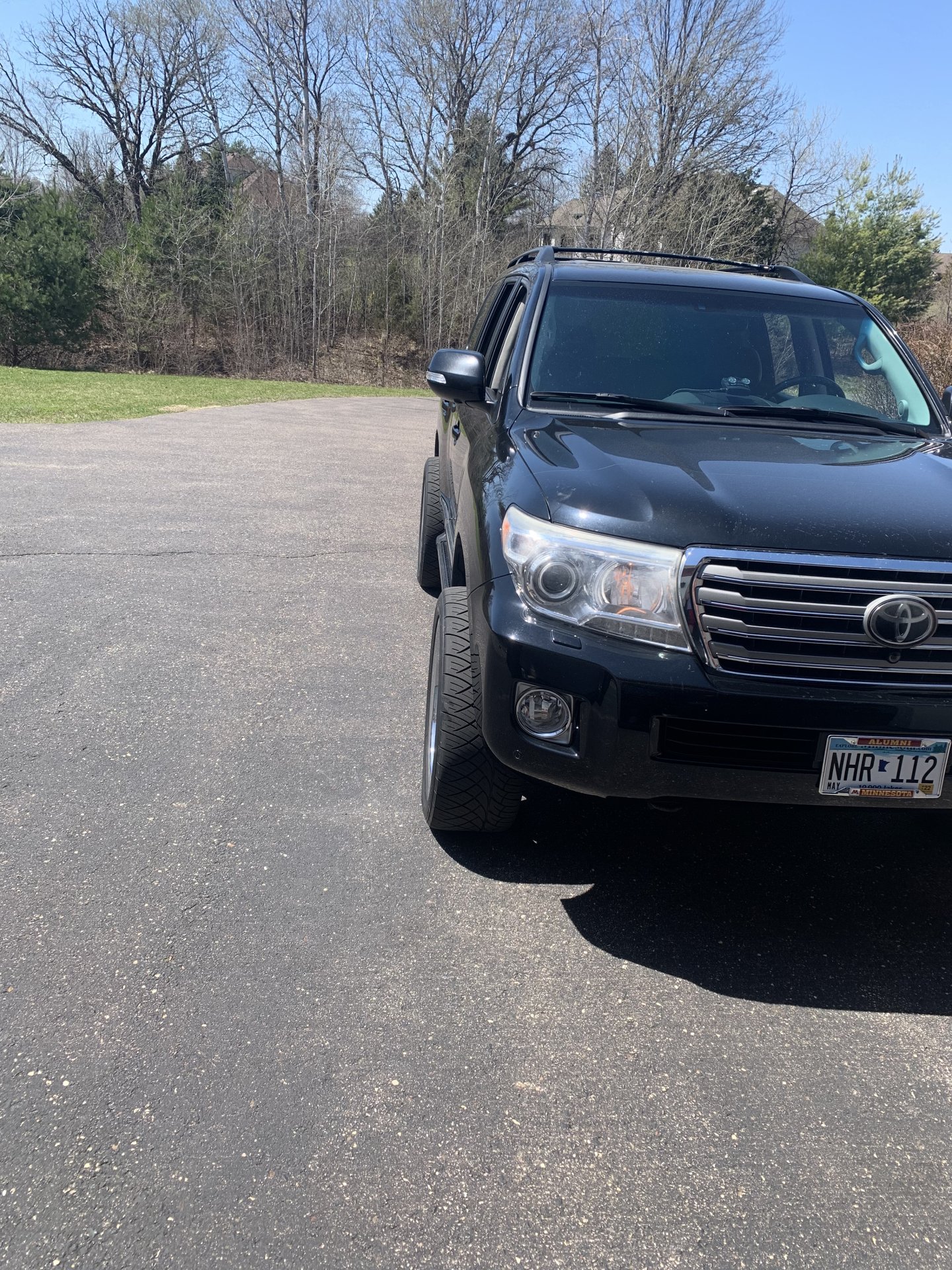

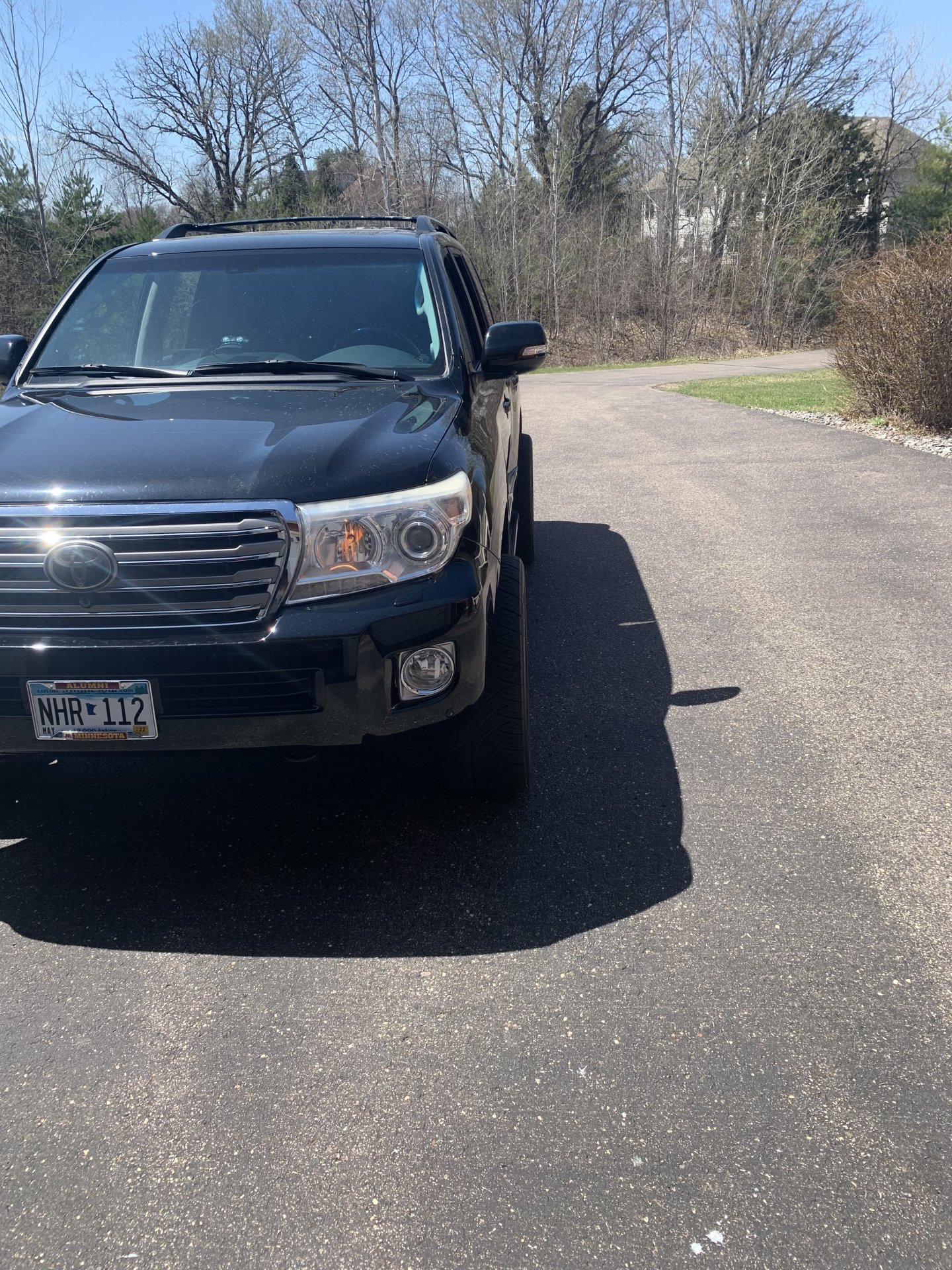

2 inch Bora adapters and spacers are on
Slight rub in front. Back is fine.

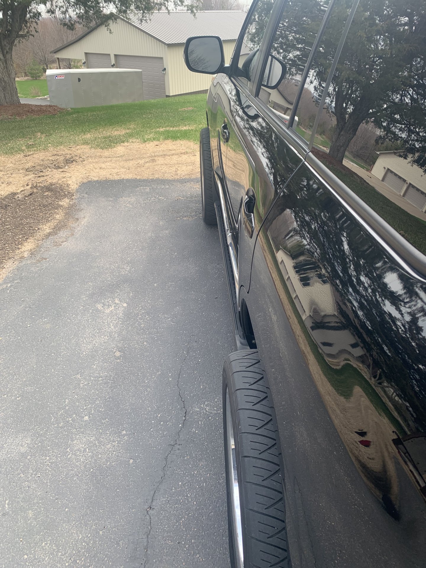

Some serious side poke, a little too much but it is what it is
I wanted to go 1.5 inch adapters but since they are two piece, I would have had to trim the studs so had to go 2 inches.
Once I fix the front rub issue, should be fine but the look is pretty nice and rides fine. Gonna go to the shop tomorrow and get one more tighten up again and we should be good for the summer.
That's a meaty street setup! It's not a crazy amount of poke even looking at it from the most dramatic angle. Looks aggressive.
I’ll get a front and back photo today
Taking off the front mud flaps to get rid of the rub
