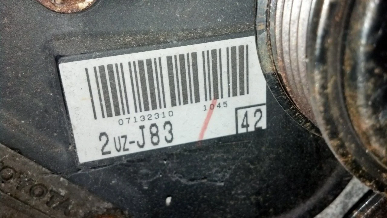

In da houze!
H151 manual 5 speed with bell housing etc etc in bound... that's the PLAN anyway...
